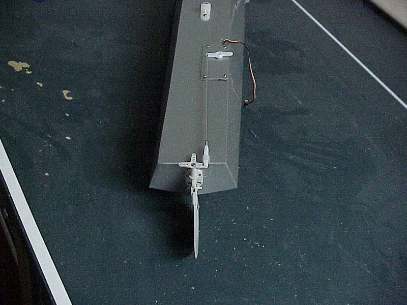

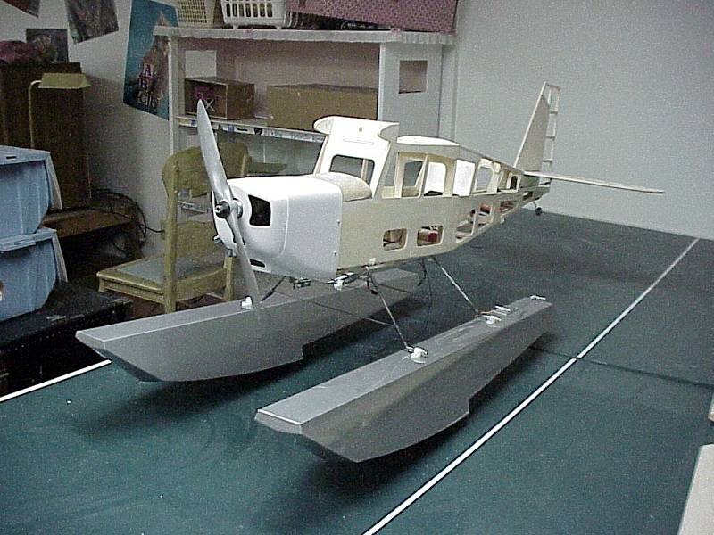

Default RE: Midwest Citabria Build Thread
Sorry that I didn't keep good notes and records during my build back in 1999, but I did keep enough records to know that I ended up adding 2+ degrees of up thrust and 2 degrees of right thrust. As you can see from the couple of pictures attached, I was planning from the start to put the plane on floats - as well as wheels.

use spruce stringers along the bottom of the fuse - mine kept getting broke when someone picked the plane up!
Good tip. I had forgotten about that and have had the same problem. Go for the hardwood. Also, just looked at mine and see that I must have done the servos the way Midwest said, as there's no way to remove them easily!! Hope that they keep working.
I also use a Saito .91, and it's a great combination - except when on floats. As you can see from the photos I posted earlier, the floats for this size plane are pretty large - each one about the size of .60-size plane's fuselage! - and due to the drag of these I believe a 1.20 would be better if floats are in your future.

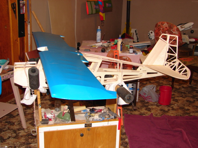

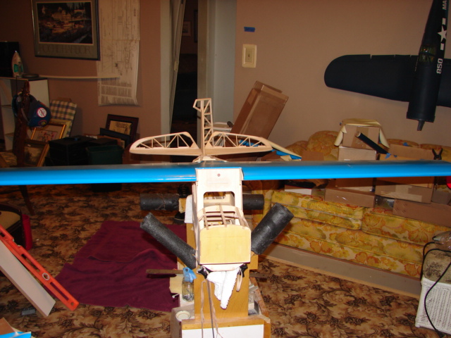

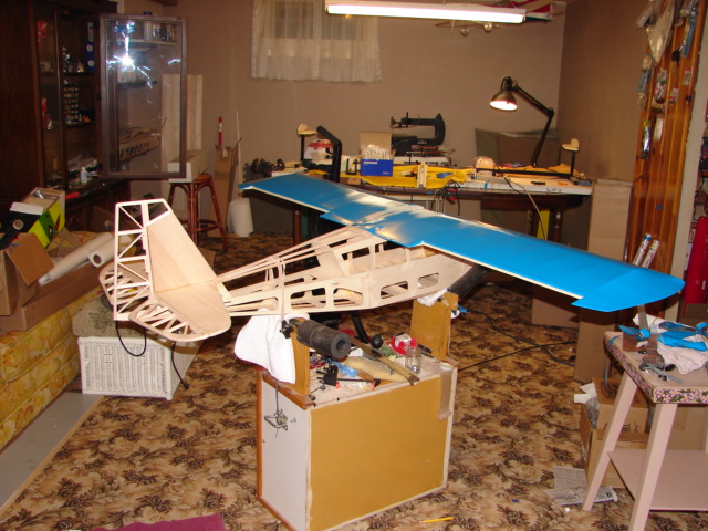

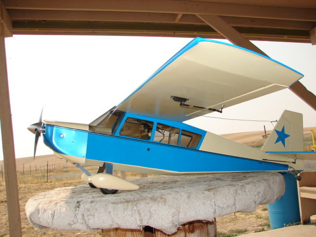

Old 11-16-2006 | 12:43 AM
Posts: 207
From: Lewiston, ID
I just finished one about two months ago, The kit came without half a wing so I dieced to build a clipped wing, scratch built the other half. The wing was built flat on the table with 3/8 washout, the wing is 72 " long. I changed the way they wanted the aileron sevos mounted, to hard to get servo mounting screws in. Look up clipped wing citabria in this forum. I didn't really do any thing else except put hard wood spruce stringers on the bottom of the plane, seems they are the ones that alway get broken. powered it OS .91 surpass great engine. You will need about 2 degrees down thust and two to 3 degrees right thrust. You could build this in with the fire wall mounting or just add washes behind your Dave Brown motor mount.
Midwest kit are very good kits just becareful when you are seoearting parts from sheets.
Happy building
