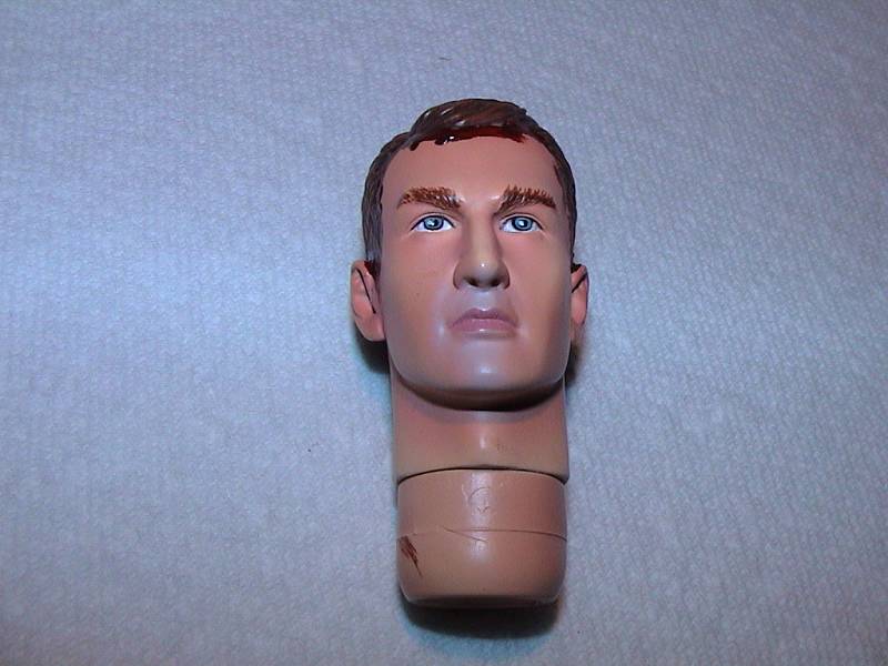

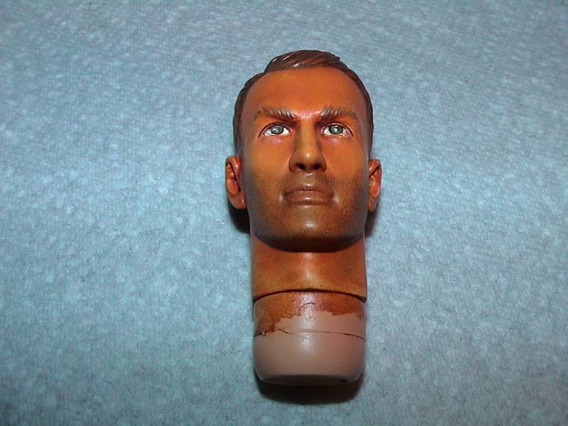

I started with painting the pilot. It's the BBI "Doc Miller" that you have probably seen on eBay or maybe even here. With painting tips from Tom Pierce and the Aces of Iron website I put him in the Pacific so he got some sun and since he returned to base late in the day he has a 5 o'clock shadow too.
As you can see I am about as far from an artist as one can get, but I think it will look OK in the cockpit. I will be weathering the parachute, Mae West, etc too.

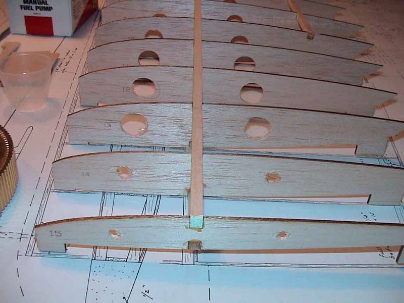

Today I worked on the wings.
I cut small lightening holes into the ribs for strength and to allow snaking wires, tubes, etc through them. For example, I am planning to have working navigation lights on the wingtips.
I placed the ribs (except #5 which will be modified for hinges) onto the spars and glued them using Titebond II Premium Wood Glue. I placed weights onto the spars to ensure the pieces are pressed firmly together.
Tip:
I use a scrap piece of metal torque rod and dip it into a glob of glue then apply the glue using the rod. This enables me to place just a drop or two of glue exactly where I need it. After pressing the pieces together, I use a small flat piece of scrap balsa to wipe off any glue that may have seeped out. When finished gluing, the rod is wiped clean and ready for use again.
I also use this method for mixing and applying epoxy.
Mistake I made:
The lower spar rises to meet the last outboard rib to help form the wingtip shape. To make this bend, you need to cut out a small amount of balsa in the spar just past rib #14. I cut out too large of a piece on the spar and it broke when I tried to bend it. (Shown in the last picture).
Corrective Action:
I decided to use 30 min. epoxy to repair it (instead of using wood glue) in case I jeopardized its strength. I applied the epoxy all around the spar.

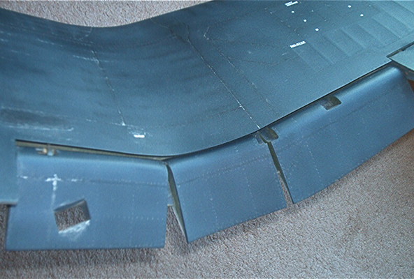

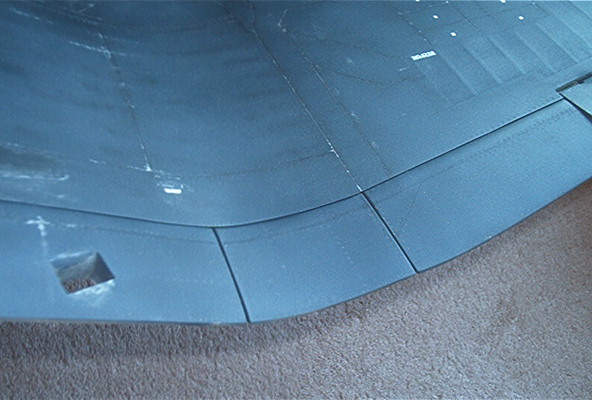

Here I'm checking the fit of the flaps after glassing the wing, then a picture of the finished product.
