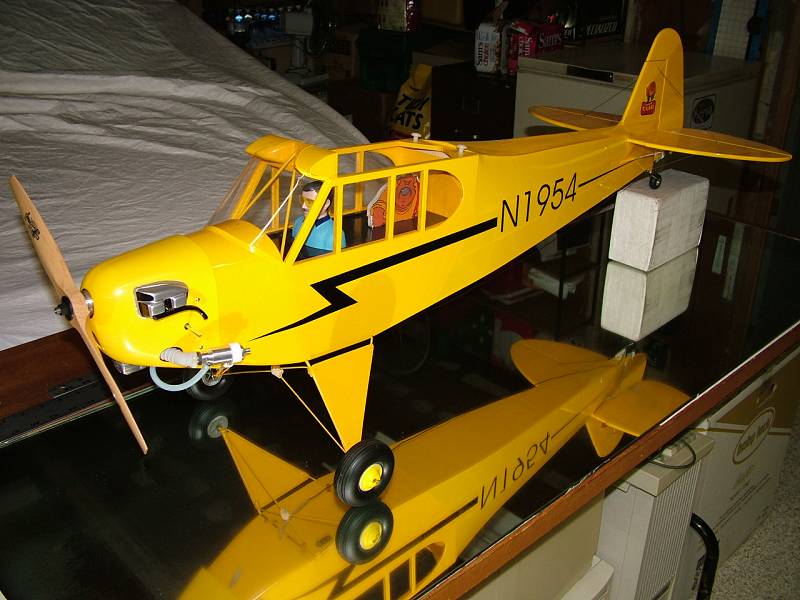

Hi all I am all but finished with the build on this sig cub,I still need to add the extra wing struts and its ready for the gear .
This is one of 3 planes thats being given away next year at the first annual fun fly on memorial day here .
I know its not fabric but heck for a free plane one cant say to much .
If anyone has a pic of a folding full set of struts for this type of plane I would like to see it.I have a few ideas but would like to compare notes.
Sig leaves this up to the builder to decide on and just shows them being glued solid from what I see.

For those that enjoy buillding as I do this is a great kit. It is in my opinion a kit for an experienced builder though because of the lack of instructions. I have built a number of them and they fly great! I prefer snap clevises for the ends of the struts and ply in the wings with holes to acept the jury struts.

Jeb, what size 4 stroke are you hiding under that cowl, anyway? [sm=confused.gif]

OS 40 Surpass inverted. Will be a great motor for this plane when I get the opportunity to break it in.

I have a kit of the 1/6 I was thinking of building and putting the regular, older FS-40 in it. How did you finish it off, it looks very nice?

Myself and the guys I fly with have had many of these 1/6 sig cubs over the years. They fly very well on smaller power plants. I think the standard 40 4s will give you very good performance. Watch the weight though. I spite of a lot of building on this plane and its predominately stick type construction, it is a very rigid plane. I covered mine with yellow Monocoat (Monojunk). If I were to build another, and I will, I would use Koverall and Polycrylic with acrylic latex paints and a clearcoat.

I used nylon hinges on the struts so they will fold flat.
