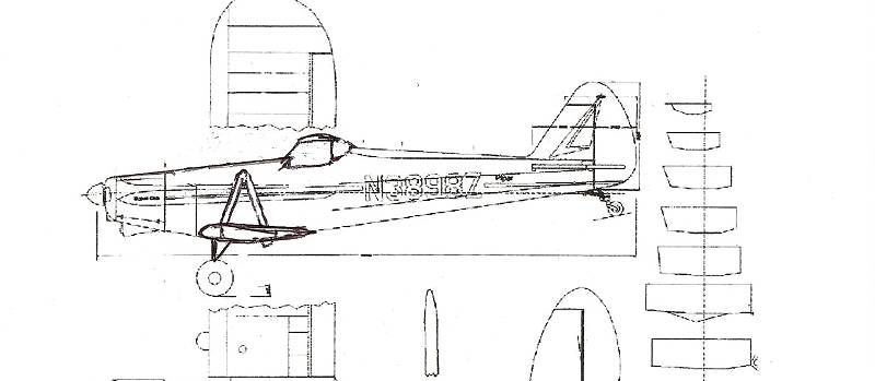

I got a wild idea to bash a J-3 cub kit into a PA-24 Pawnee ag plane. I know that the Pawnee was a development of the Super Cub but a change to the rudder shape and the addition of flaps would fix that. Has anyone tried that recently? Everyone has a cub or two but the pawnee is not a common model. It does not look like it would be impossable. In fact it looks like it could be done pretty easily. Any thoughts? I've had a Great Planes .40 Cub kit gathering dust for a while and think I might like to give this a try.

Save the time, money, and frustration. Build it from scratch. The PA-25 is an awesome bird, a so is he PA-18, but for this project, I'd get the scale PA-28 cowl and build back from there. Thats just IMO.

DaveB, Not really. You need to move the wing mounting blocks to the bottom of the fuselage and cut the fuselage sides to match the rib outline. I think the hard part would be lengthening the fuselage forward of the wing and balancing the plane. The Pawnee has a longer nose than a cub or Super Cub. The GP Cubs have balsa fuselage sides with inner ply reinforcements so once the cutouts were made the wing would mount just like any other low wing plane. The gear would have to be mounted in the wing because of the way the wing is mounted. I need to pull the plans out and see exactly what kind of cutting would be required.

I took a SuperCub 3 view and came up with this. A line was drawn from the cowl to the turtle back. the wing was move down to the belly and a cockpit added. A little whiteout and viola, a Pawnee. I just might try this on the plans and see how tough it really is. It wont' be "scale" but then neither is the kit I have.
