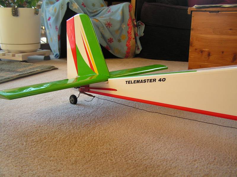

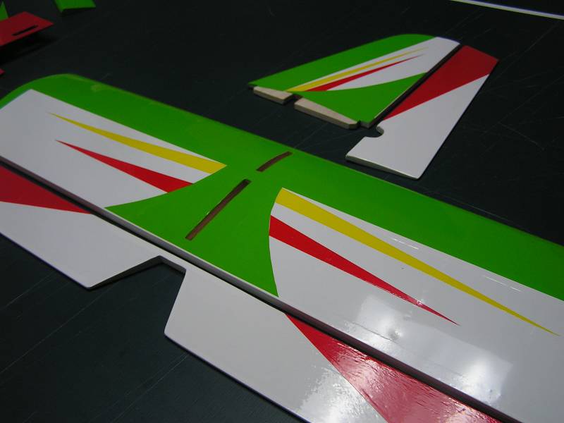

Telemaster covered, painted and ready for final assembly.
It took about 25-27 hrs of work to cover it like this.

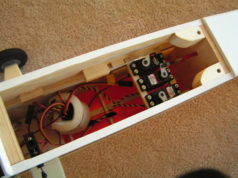

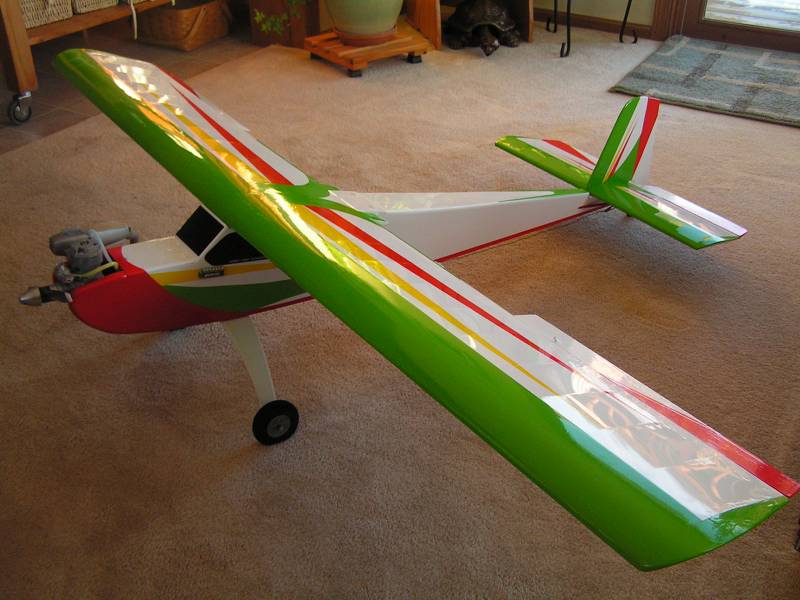

Okay,
I have completed the Telemaster.
We won't have decent flying weather in northern Wisconsin until probably mid April, but you can bet it will fly when a reasonable day arrives.
Finished weight, 6lbs, 8oz. (2.948kg)
Radio, JR Tx7202, Rx R-700
750 mA battery
Servos, 4 Hitec 425BB, 2 Hitec 475NB, 1 JR NES-517
Engine, OS Ax55

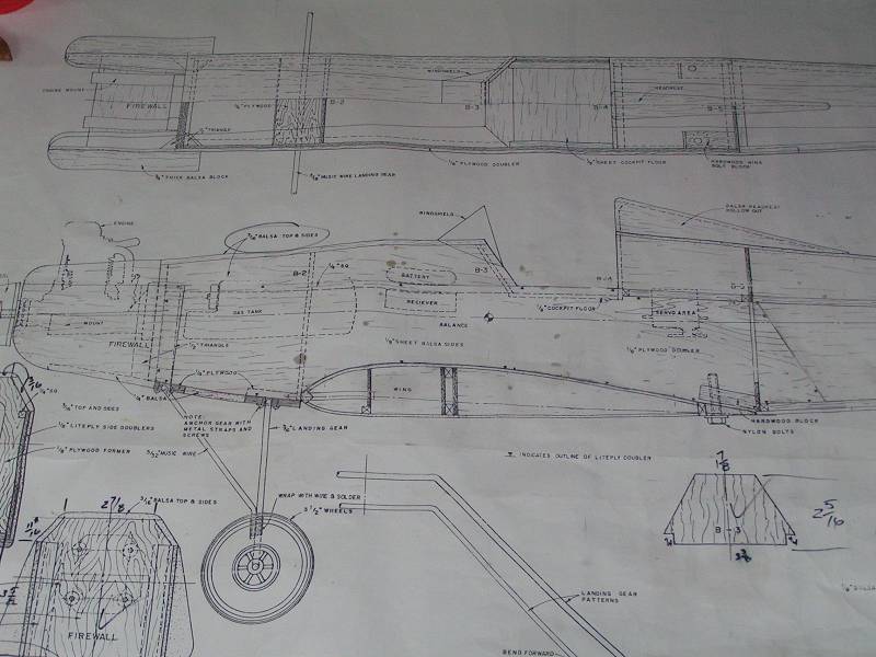

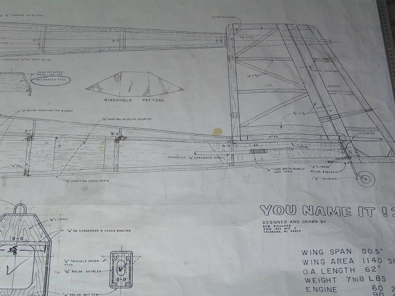

There is no box. No kit. No pictures. No Instructions. Just plans. It will be fun.
This is an airplane that was designed by a fellow from the U P of Michigan back in the nineties and is rugged, dependable and easy to fly. This airplane has become the go to airplane of a number of guys here in Wisconsin. For many it is the only airplane they bring to a Fun Fly. I have been put at the controls of a couple of these airplanes in the past few years, and finnaly decided that I needed to own one. It is similar to a Sig Four Star 120, 80" wingspan, 65" long, relatively flat wing. It has a unusual fin configuration, and a distinctive upper fusalage that sets it apart from similar aircraft..
At one time, I understand there were some parts available. Rib sets and such, but that is a number of years back. I heard last week that Bob Richards, (the designer) past away in December of last year. I have got a pretty good start. I started by making templates of sides, doublers, bulkheads, ribs, etc. Fuselage is about half done. It is promising to be a simple build. I'll add my touches, making it stronger in some places, lighter in others. Pictures are of the plans I have, the "You Name It II".
