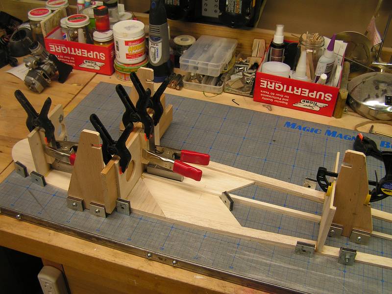

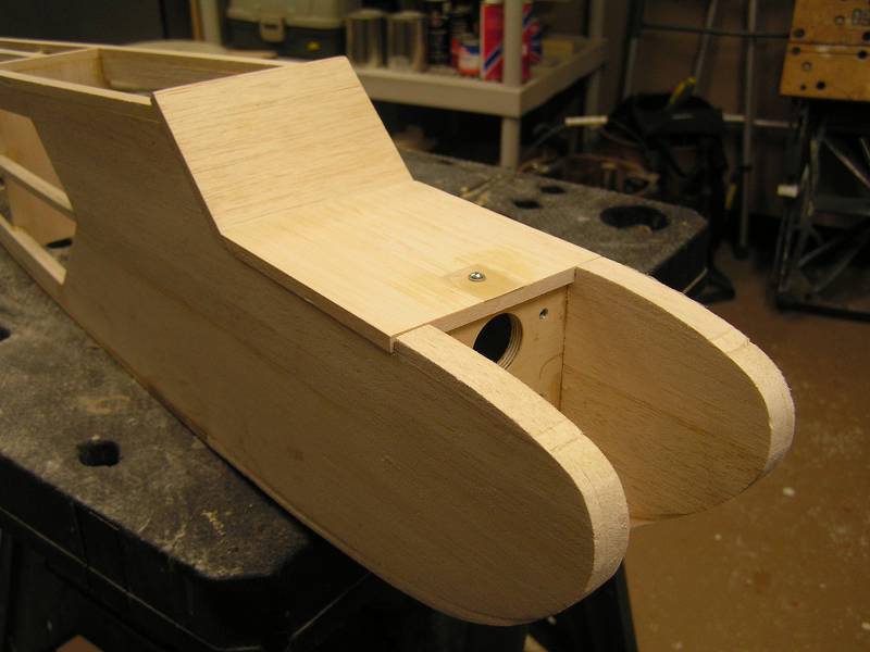

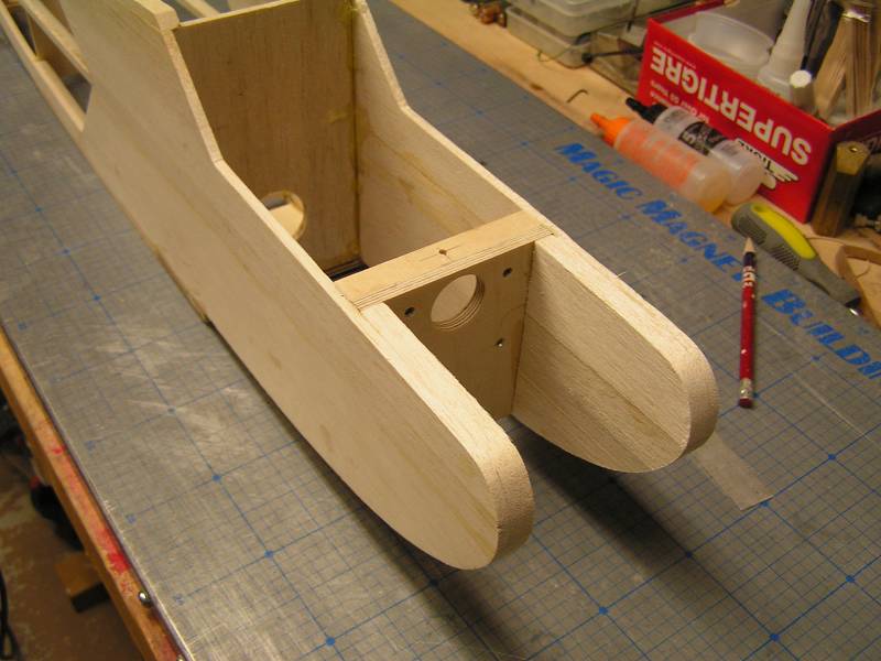

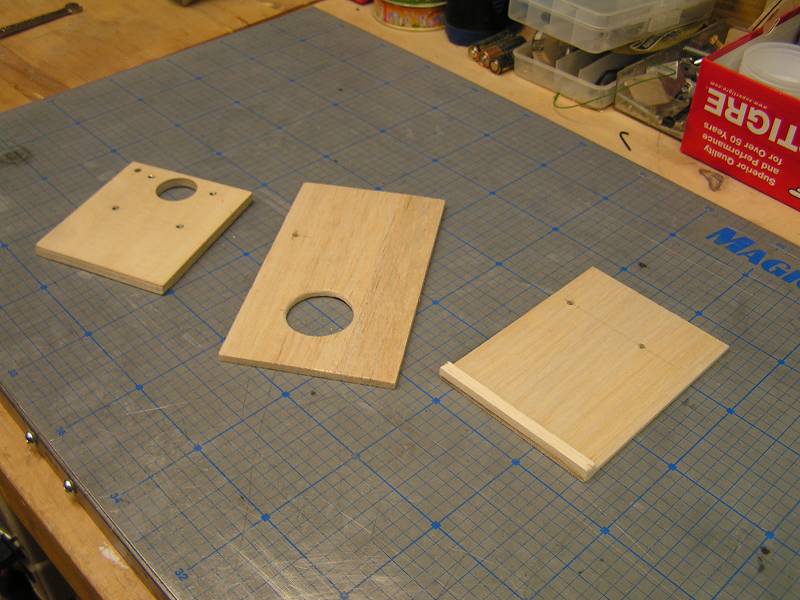

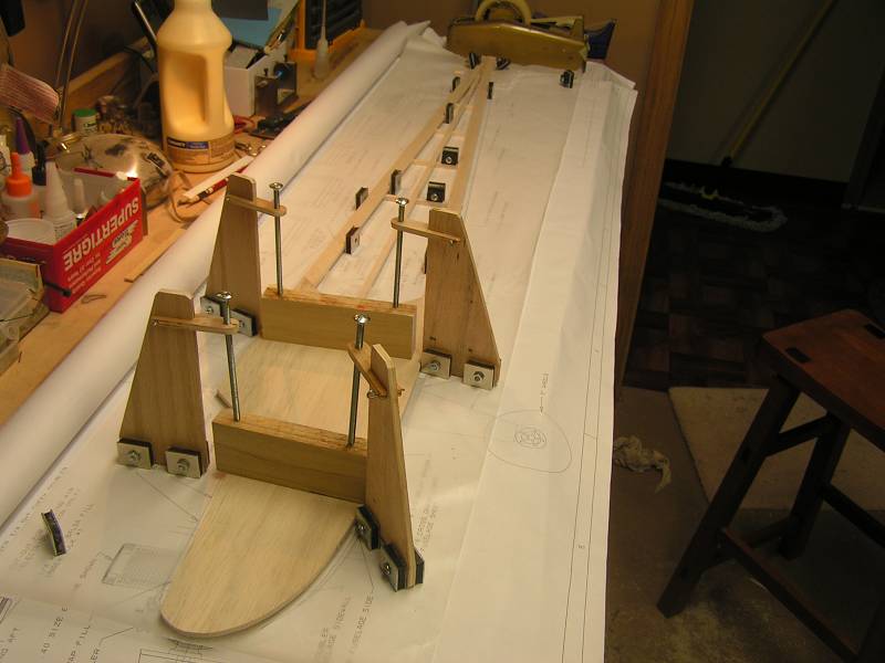

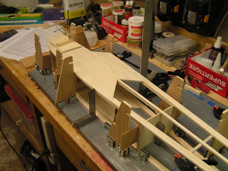

Hi All,
I am starting a build of a Telemaster 40. When I opened the box and found that the instruction were the same as I could get on line through the Hobby/Lobby web site, I panicked. What? No pictures? Yikes! How will I get through this? How will I survive?
After I settled down, I dicided that I could in fact survive it, get through it, and succeed. As I was beginning the build it came to me that I could take pictures of the progress and post them here for all to see and maybe make it easier for someone who might want to build this wonderful airplane.
I am going to try and corrolate the pictures with the steps in the plans, so here goes!
When I looked at the instructions I felt that the build of the fuselage was the most confusing part, so that is were I decided to start. I will try to tell this story in pictures, and limit my words. A picture is worth a thousand words. Right?
The site it seems is having trouble uplaoding pictures today, so I'll continue as I can.
Old 01-17-2009 | 10:24 AM
Joined: Jul 2006
Posts: 147
From: Rhinelander, WI
Default RE: 40 Size Telemaster

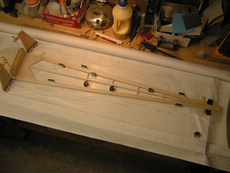

Telemaster build: These images cover steps 1-17 under Fuselage Section Sub-assemblies of fuse sides, stringers, and bulkheads
[img][/img]
[img][/img][img][/img]

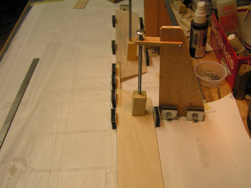

These photos show the joining of the fuselage sides, installation of the main bulkheads, and landing gear mount.
Steps 18, 19, 20.

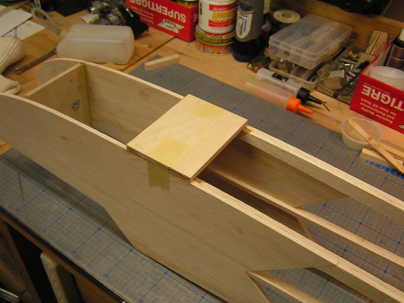

Here is how I built the rear section of the fuselage. Steps 21-25 under the Fuselage section.

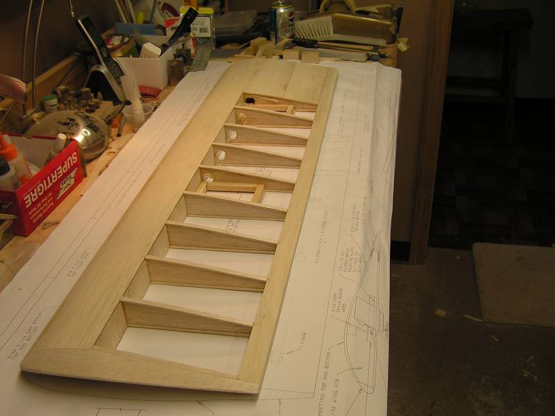

Old 01-24-2009 | 09:55 PM
Joined: Jul 2006
Posts: 147

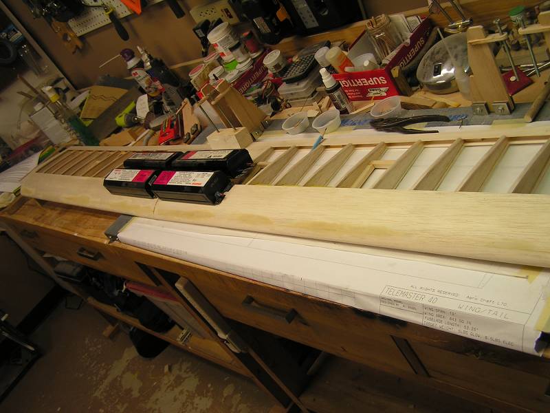

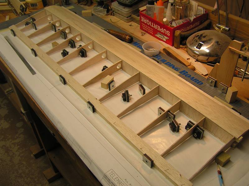

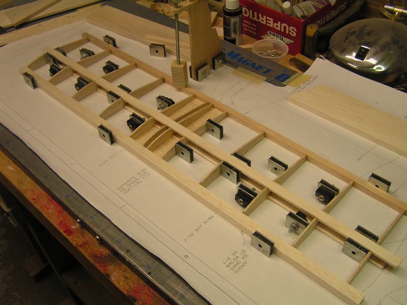

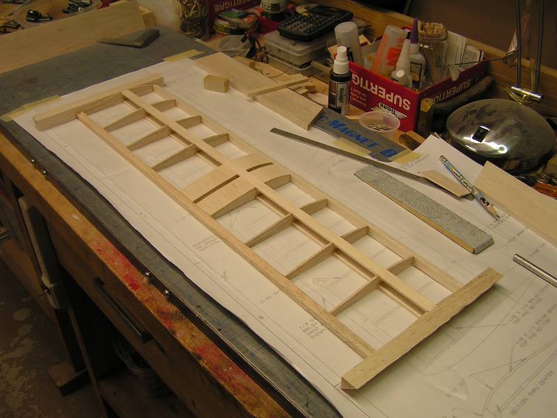

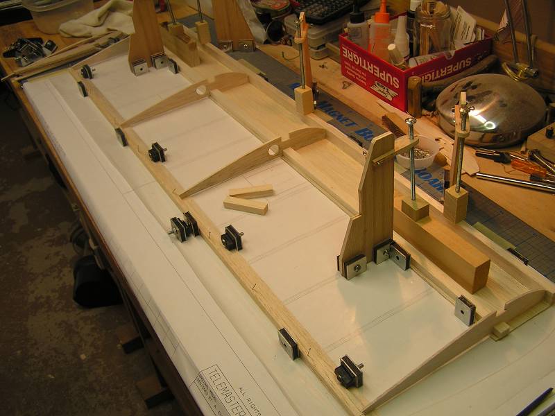

Steps 43-59 are pretty clear.
I will move on to the Wing.
Steps 2, 3, & 5. I'll put to bottom cap strips on later.
Steps 6, 7 & 8
I added a center brace. It seemed so easy. Why not?
Aileron and flap bays were easy but time consuming.

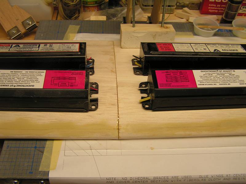

With the center brace in place joining of the two wing halves was easy.

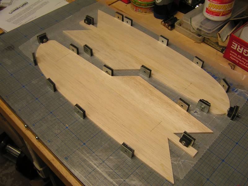

The Stabilizer
Steps 1-8
Steps 9-12

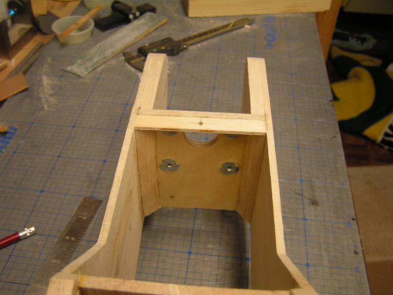

I added a few details.
Tubes to guide servo wires.
A beefed up servo rack.

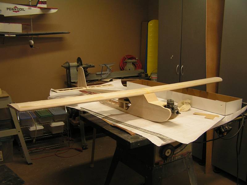

Almost ready for covering.
