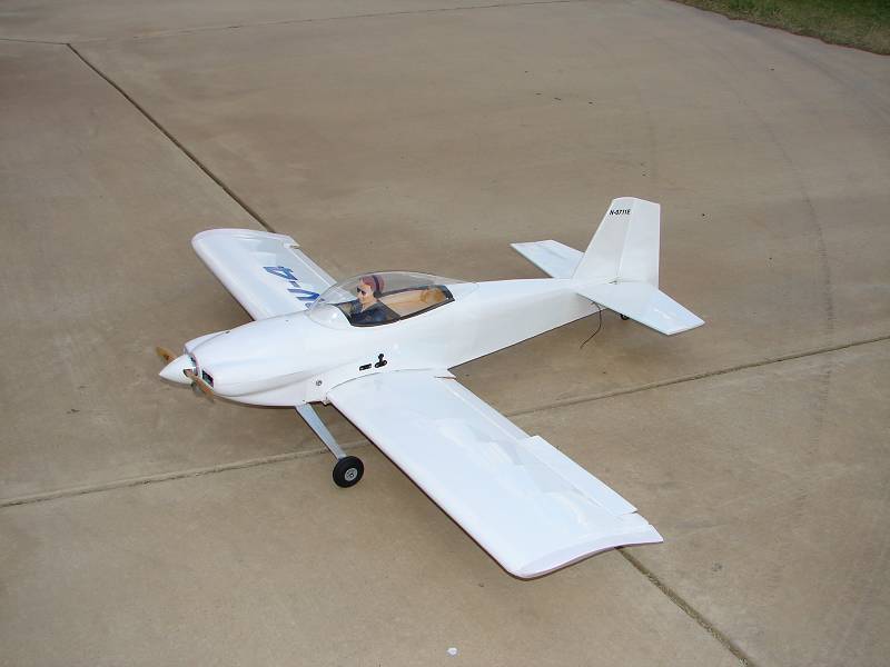

I crashed my RV-4 kit on it's third flight, "my" first flight on this kit during a take-off. I had a very experienced 30+ year instructor take it up on its maiden +1 with some difficulties. He had me make some adjustments for the sensativity (expo). Anyway, it was proven to be airworthy so I can't say anything bad about this kit. My take? It was human error that caused the crash. Anyway, the damage seemed pretty bad at first. The wing cracked in half at the root so it was a g-loaded crash with the firewall also seperating. No damage to the fuselage. After doing initial repairs and looking at the plans, I have been able to re-attach the wing halfs successfully and am working on the NEW firewall. The plane should be complete in about a week. My question is, does the RV-4 need a significant amount of speed on take off? It appears I went into a tip stall (to the left) which probably would have been recoverable if I where more experienced. I feel I had a good takeoff run and the plane lifted itself up into the air, then things got bad. During the stall, the nose pitched up (probably due to my input) and to the left. I had applied full power and was just starting to recover until I ran out of sky. Perhaps some right rudder would have helped? The aircraft impacted soft grass level on the gear. The kit has installed flaps but I did not use them on this flight. Anybody have any general recommendations or info on this plane perhaps any experiences with flight characteristics? I'm having our clubs experienced pilot take her up again but was wondering if you all had any aditional good advice.

Well my RV-4 repairs are going very well. I have already repaired the wing halves and inserted a small plastic bracket with screws for additional reinforcement. I also used small screws to add the new firewall as well as epoxy. It is drying as I type this (I considered fiberglass or composite fibre but I'm still learning about it). All I have left to do next are some final inspections, then check the weight and balance plus rechecking symmetry and of course servo and electrical. I reused my plans to recreate some parts so as a newbie kit builder - I'm glad I kept my plans handy. As for my engine, I have the OS .46 AX and it appears to be doing a good job. I think she should be airworthy in about another day or two. One thing I have to say about the RV-4 is she's a tough bird and didn't take on too much damage. As for folks building her right now, don't worry about the kit. It's a good kit -- the reason I crashed was due to pilot error [] Anyway, thanks everyone for the advice. I do have the flaps installed but haven't played with them much. I'll let you all know how she does in the air after her repairs. I'm not flying her myself but a more experienced club member is. Thanks for the replies.
Below is a picture of my RV-4 before the crash. She looks the same after repairs.
cheers
