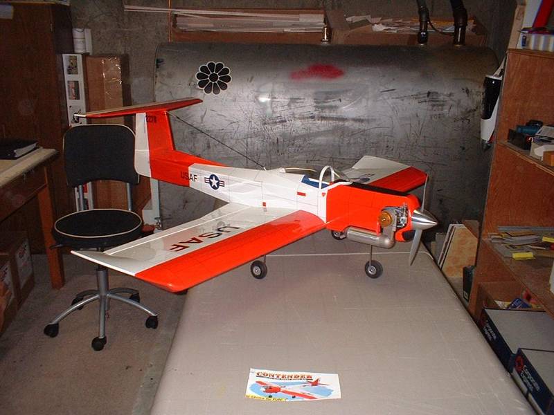

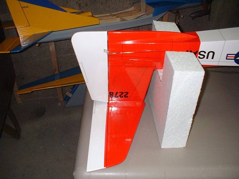

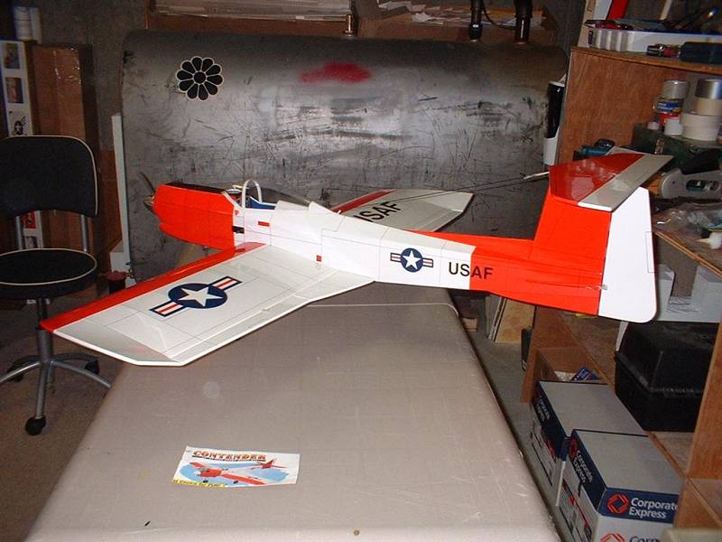

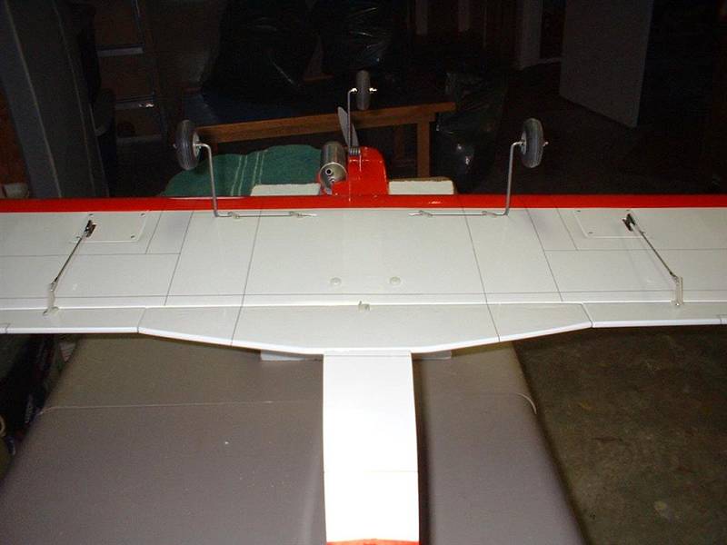

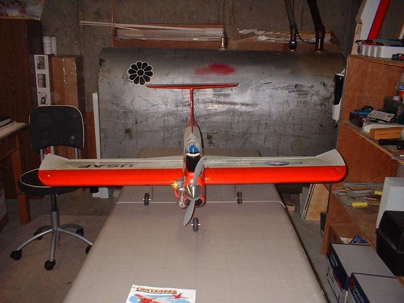

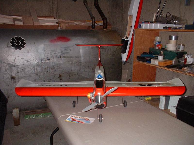

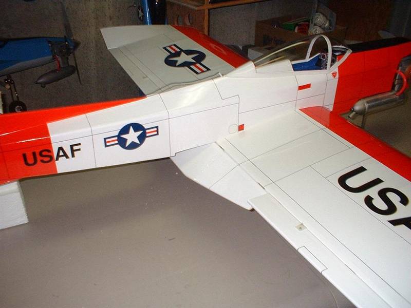

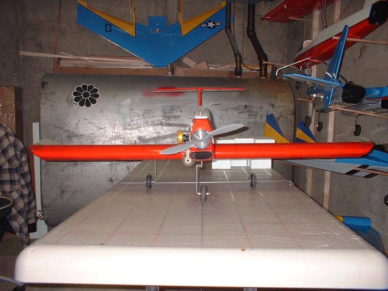

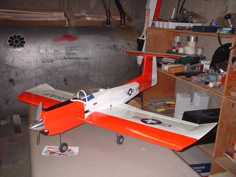

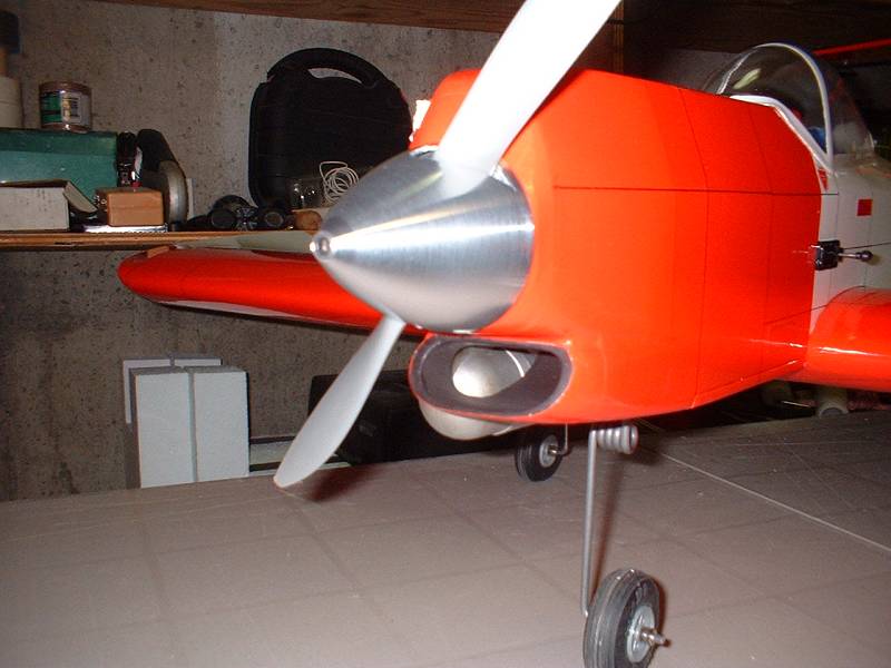

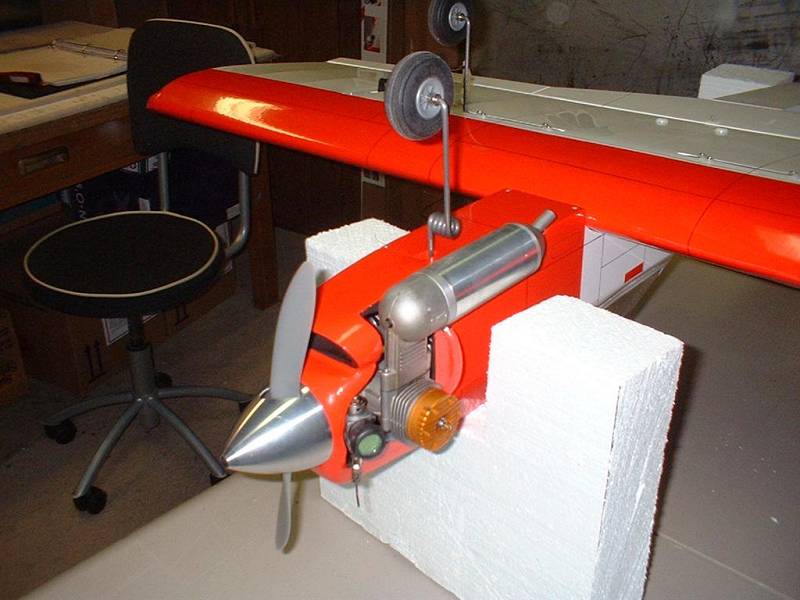

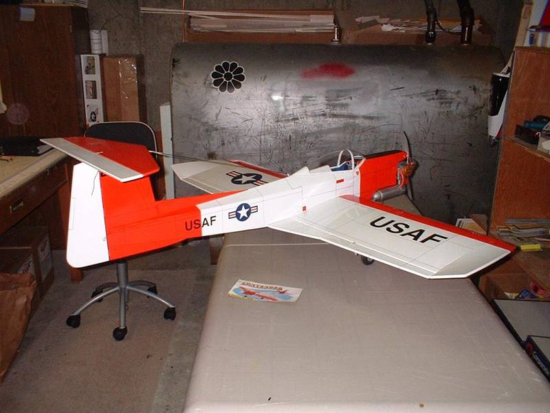

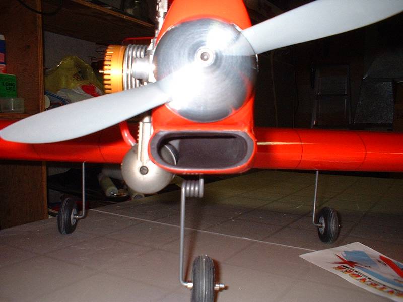

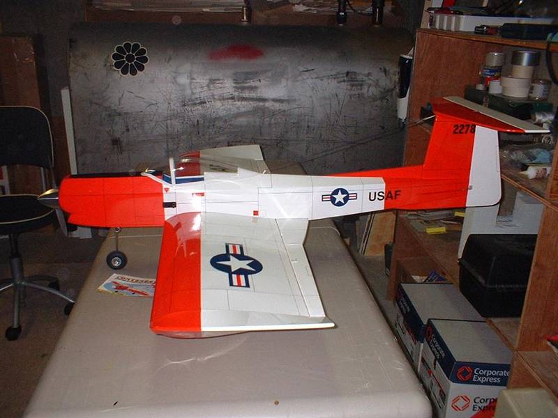

Well all finished came out to 6.3 Lbs not bad for all the heavy wood in the kit ... to dang cold out to get outside pics so I will give you what I have.

HI Jim ..Used Hanger 9 Ultra cote ..only paint is inside the cowel and used high temp black ( for BBQ stoves )

it also required 1/2 oz in the wing tip for lateral balance

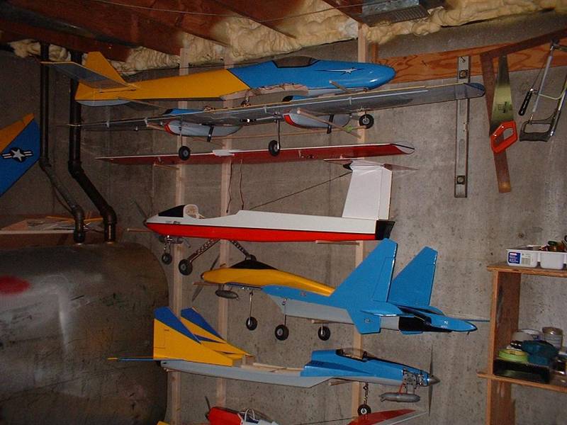

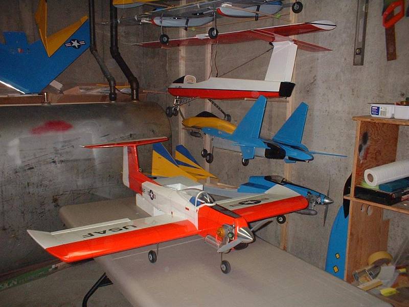

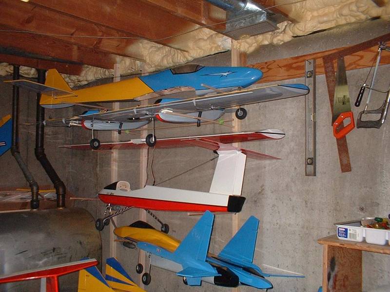

To much time on my hands and the Wife wanted the planes out of the bed room so for 27.00 and some clean up work I made a wall rack ..came out not to bad. Very limited building space so I kinda had to do it anyway.

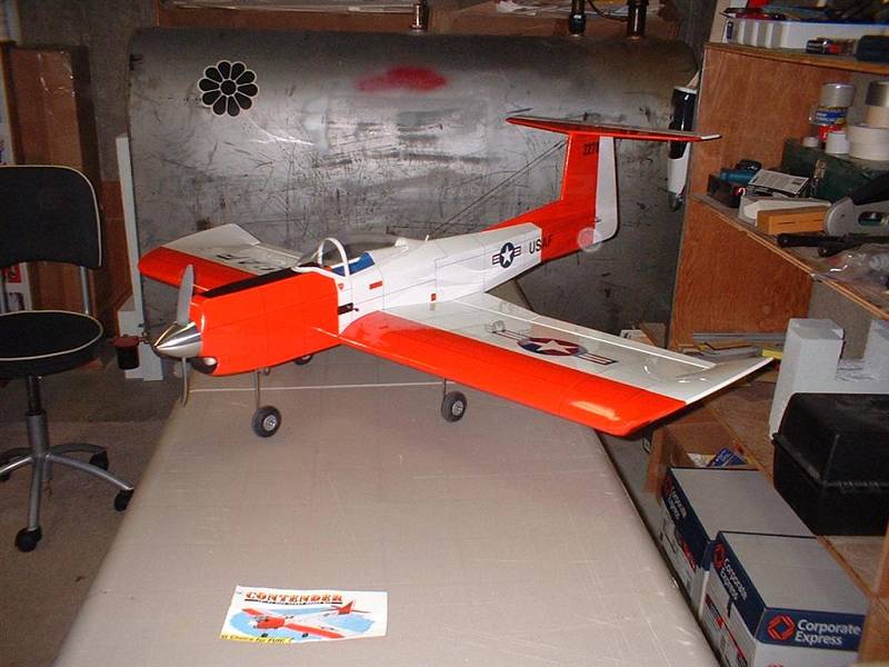

Man am I ever board [&o] waiting for the snow to go ... so ... ever body likes pics and I need to cycle my batteries in the camera so with some that look the same and others from a different angle here we go.

With 1 or 2 weekends away from the maiden flight I was able to get the Contender fired up in my back yard ...tweaked out the GMS and checked for tank leaks (none) ...found very little airframe vibration using the Du-bro motor mount.... after the 10 minute engine run at various RPM's removed the wing and re-checked ever nut bolt from fin to nose cone ...all is fine.
Went over the lateral for aft balance .. rechecked all control throws and re weighted. I am all set to go other then range check at the field
have I missed anything?
