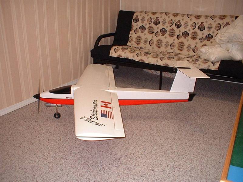

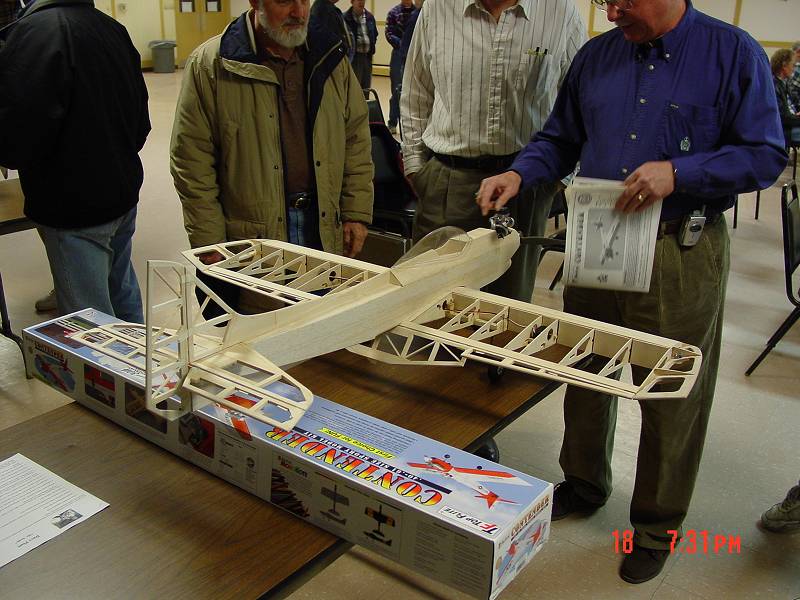

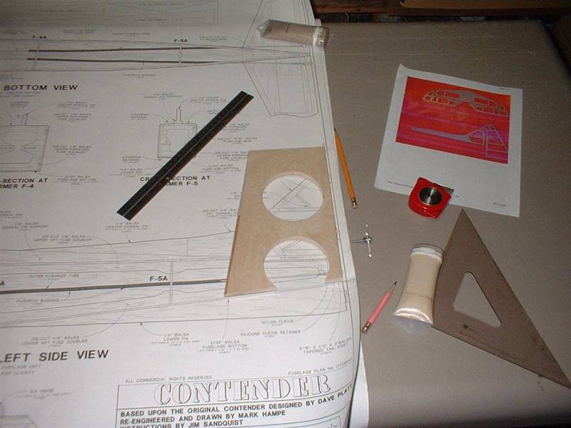

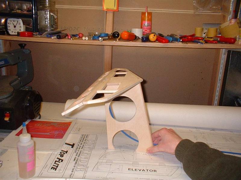

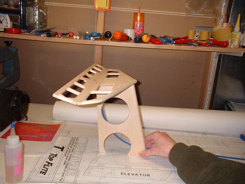

The kit flies well in its more or less stock shape ...so ... How about I build it with a "T" tail ( stock Stab ) ? and a little different shape rudder ?

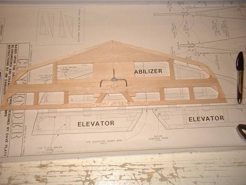

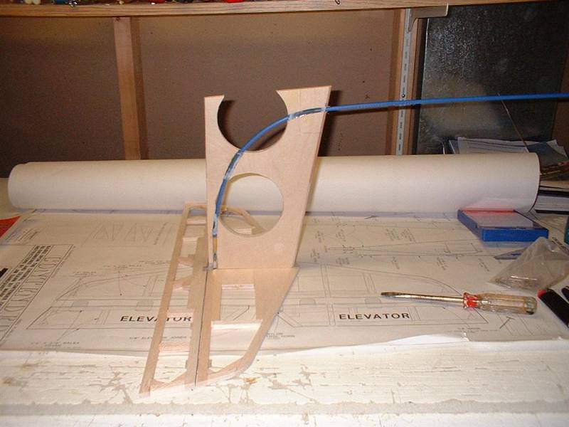

For a better look on the Fin I am going to angle the LE back 1/2" to the top and reduce the weight a tad... the mounting surface for the stab on top when I use 3/4" Tri stock will be 2" which is more surface contact then the stock plate on the fuse.

Go for it. We need more kit bashers in the world. I added 30% to the rudder and it could stand a bit more fixed stab, too.
Fun plane. Solid as a rock.
Are you doing a full flying "T"? I seem to remember some rule-of-thumb for setting incidence in a "T" tail for having the control surface so far above the datum . . . but I'll be darned if I can remember what it was.

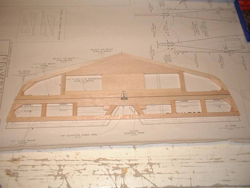

Charlie: Going with the stock elevator but full length ..full flying would be nice to try but will stick ( pun ) with the stock ... here is a pic of a Kit I bashed with a T tail flies great.
I have a idea for the rudder size and will post later in the build .. going with 1/2" wider ailerons as well

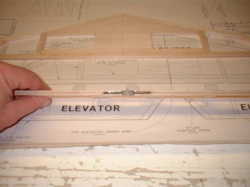

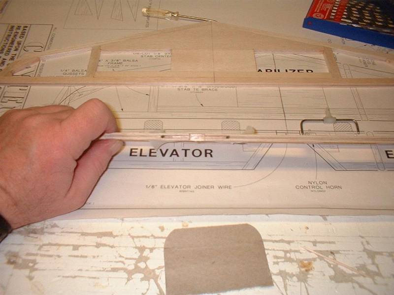

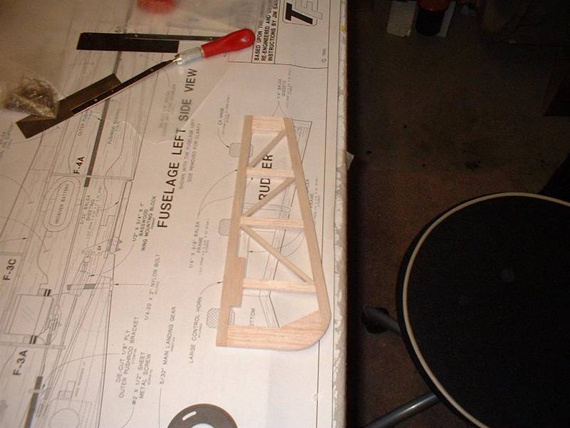

A pic of the Stock stab and the elevator ...elevator has the LE/TE running full length and can be cut to stock size if the T does not work out. More later

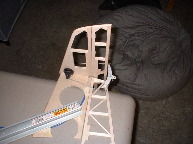

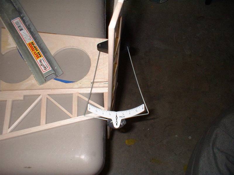

Can you see the possibilities Yet

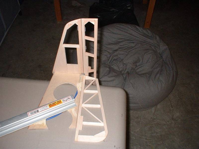

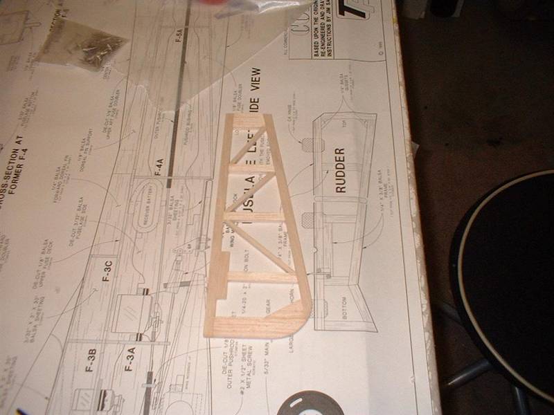

How about that rudder !![8D]

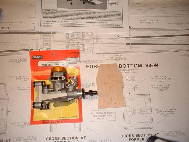

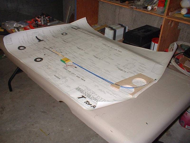

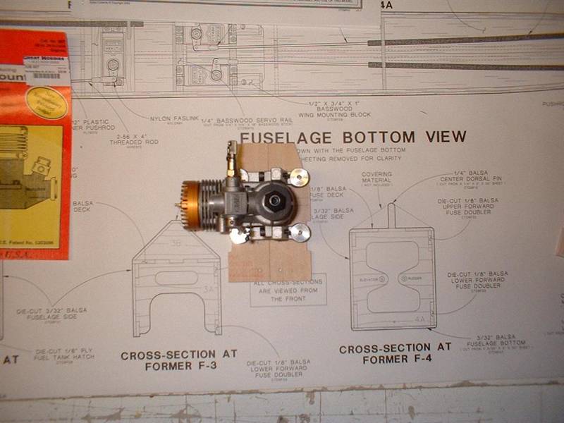

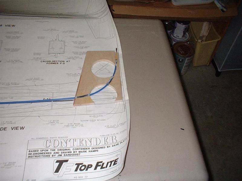

Before I get going on the fuse I want to change the Fire wall from two light 1/8" ply to a solid 1/4" ply ...I also wanted to use the Vibra mount and turn it sideways on the fire wall ...It just fits but had to drop the trust line to just over 1/8" but not 1/4" ...just need to drill in the fuel/pressures lines and the throttle rod.
