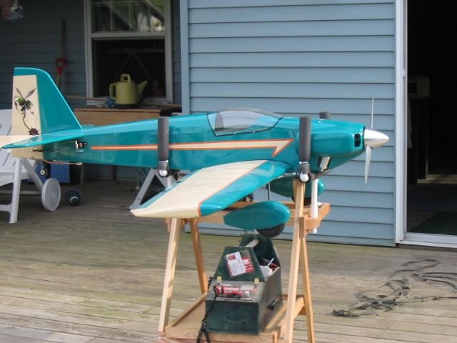

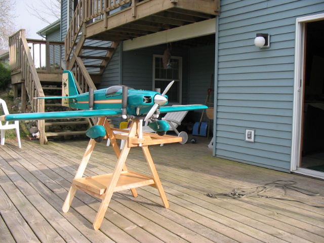

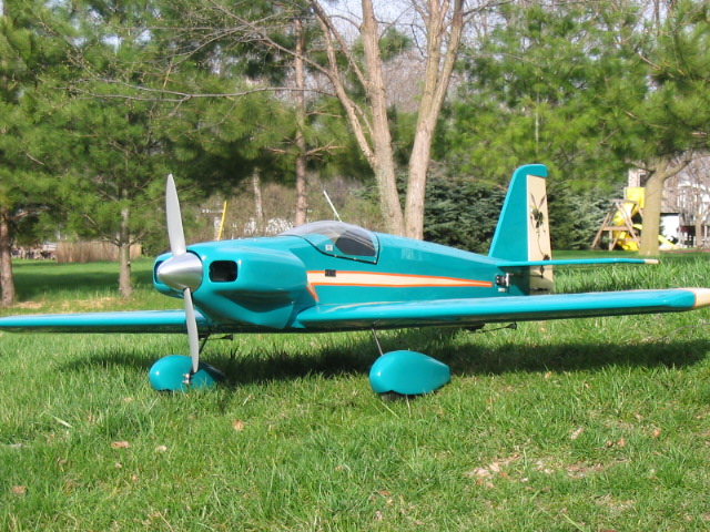

I have a Bridi Killer Bee, built from a Bridi kit and powered with a Zenoah G-38. It's easy to build and easy to fly. It is not a 3-d machine, but will do all of the basic aerobatic maneuvers.
I use it as my weekend flyer, just to keep the thumbs in practice.
You will enjoy.

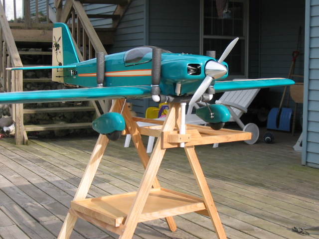

ORIGINAL: Herb Brown
You will enjoy.
You will enjoy.
I've got a question...I've got the same kit..and haven't started it yet and have a Poulan 46 that CH converted for me laying around..is their enough room to possibly stuff it in..or would it be too much.

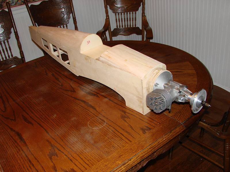

Here is a couple pictures from a previous post on the fuselage.
I did cut in the lightening holes, changed out 1/2" triangle stock for 3/4" and added 1/2" triangle stock in corners of rear fuselage.
I also choose 1/8" sheet on top forward section of fuse. This looked alot easier than planking with 1/8 x 1/4 peices provided. I still used those on the curvy part as the 1/8 sheet does not bend well or easy.
The ST 3250 mounted to the firewall would be way short. I used a 5" hole saw and a 3" hole saw to make ring shaped peices from 1/4 plywood. I stacked these to make a forward firewall for the radial mount of the ST. I also added another 1/4" sheet to double up the existing firewall, making it a whole half inch thick. If I was to do over I would double up the firewall. This added alot of extra weight.
The plans call for stringers on the turtle deck. I never liked this look so I purchased thinner stringers, trimmed the formers 3/32 and used 3/32 to sheet plank the turtle deck.
Pictures show the rough sanded results.

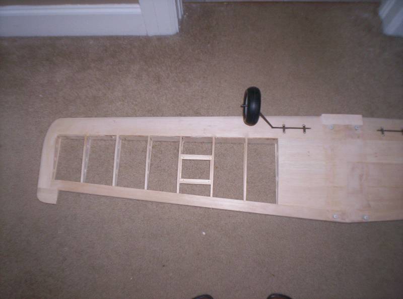

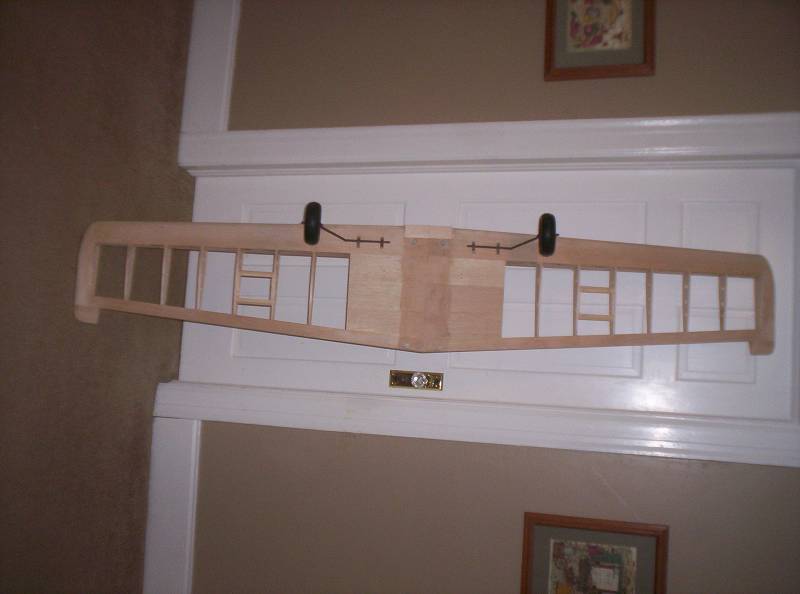

I made some progress over the last two weekends, the first significant progress since Christmas.
Finished sheeting the right wing half and fabricated the servo mounts.
I applied about a 3-1/2" wide center 1.5 oz fiberglass ribbon to top and bottom center joint. The plans call for at least a 5" wide sectiion of glass but the instruction say this is not necessary as the plywood dihedral support will handle all the load. Bridi needs to tighten up here instruction sheet. At just two pages it has to be accurate and the fix can't be more then a simple edit in a word processor.
I did not like how this thing fitted up when joining the two halves. Plans call for building the left wing half, including the dihedral support. The right wing spars, ribs, trailing sheeting are built then this partial is added to the dihedral support and the left wing. It is do able, but unweildy.
I do not like mounting my aileron servos as shown on plans. Plans show mounting to rails "flat", where the whole servo protrudes from wing. I like to mount mine on their side to an access plate. Only the servo arm protrudes. I think it looks neater, this is just my preference, plan detail works just fine also.
The access plate and servo mounts are next on schedule.
The spars are just 3/8 square balsa which I felt was light but others thought it OK. However since I'm putting power above recommended I ran 1/4" carbon TOW along top and bottom spars from center leaving last two rib bays unreinforced. First application of this stuff and I am quite surprised how strong and stiff it makes the wing.
The landing gear mounts do not fit as nice as I would have liked. Without alot of trimming they would stick out of the wing form. I spent alot of time cutting and trimming so they would fit under the sheeting.
Crudely took out three circle like lightening holes in each rib. Brass tubes, brad points, forster bits, unibits I have found nothing to cut large circular holes in balsa sheet neatly and easily. Brass tubes dull after just a few holes. Great Planes has done a nice job with a couple tools for builders like their slot machine and dead center hole locater. I may write them with suggestion to invent a decent hole saw for balsa. There is a thing called a tile hole saw with diamond grit for teeth. Too large and expensive but something along that line, I think, would work.
Ribs are not laser cut but sanded to shape. Makes for a nice fit. But also means there are not alignment tabs on ribs similar to what I've seen on Four Star, Hog Bipe and Contenders. One must draw a center line down the each rib them block them so they are parallel. Not hard or inaccurate but just adds some time to build.
The trailing edge is just a peice of rectangular stock. It does not match the airfoil profile and the rib height at attachment width varies the taper of the wing so one has gaps between it and the trailing edge sheeting. I added a thin strip to the stock and sanded to shape of airfoil so no gaps would be present between it and the sheeting.
I wanted to try Robart hinge points so I added some scrap to the interior of trailing edge at the appropriate spots. The plan stock here is thick enough to support CA or pinned hinges but not the Robarts.
Test fit of wing on fuse shows a large step in profile from trailing edge of wing to fuse. Also the chord taper mates to a flat fuse section so there is a large gap. I intend to fill the gap and feather some balsa onto the fuse for a smooth match to the wing. Plan calls for a 1/32 ply plate to cover this but I wanted a slicker appearance. This also lead me to purchase a Robart Incidence Meter. The wing looks like it is parallel to the datum line as shown on plans. However the ill fit leads makes me question the incidence and this is a good excuse to purchase another tool. Hope the LHS has one.
This is my first tapered wing and being this is a more advanced construction I had expected a more difficult build then previous experience. However I give the wing engineering a "D+". The landing gear mounts could have been closer to final shape, 1 point off. The wing trailing edge/sheeting/rib joint cannot be sanded to shape without adding addtional material, .5 point off. The poor fit at the fuse/ wing trailing edge shows poor engineering also, 1 point off. The manual gets another 1/2 point deduction. Given what one can do today with a word processor, digital camera and a cheap printer some effort needs to be given. Oh almost forgot, Bluejay charged me $5 for a replacement manual. A little cheap when I would think could be emailed to me.

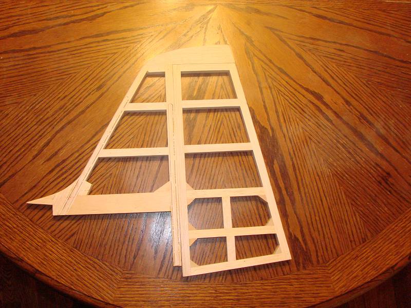

Here are some picks of the tail group peices.
I thought the model needed more rudder so a bought the bottom trailing corner out about 3/4", leaving the rest the same. I also did not want the flying wires attached to the stabilizer and fin so to strengthen this area added carbon fiber ribbon. I used the same 1/4" carbon tow used in the wing. Using my Dremel and a router like bit, I sunk a flat bottomed cut about a 16" deep and 5/16" wide. Then laid in a layer of laminating epoxy, the tow and a fitted peice of 1/16" thick balsa. Clamped it down flat and tight. After it set up I sanded smooth and did the same to the other side.
I did not like how the fin fit near the rear former. There is a V shaped gap between the verticle former and the sloping fin. So I add some 1/2" balsa stock to fill the gap and provide a smoother transition between the turtle deck and the fin.
I had a brain fart while fitting the fin. I fitted the fin without the 1/2" thick stabilzer in place. This lead me to cut the fin root where it fits to the very rear of the fuse a 1/2" short.

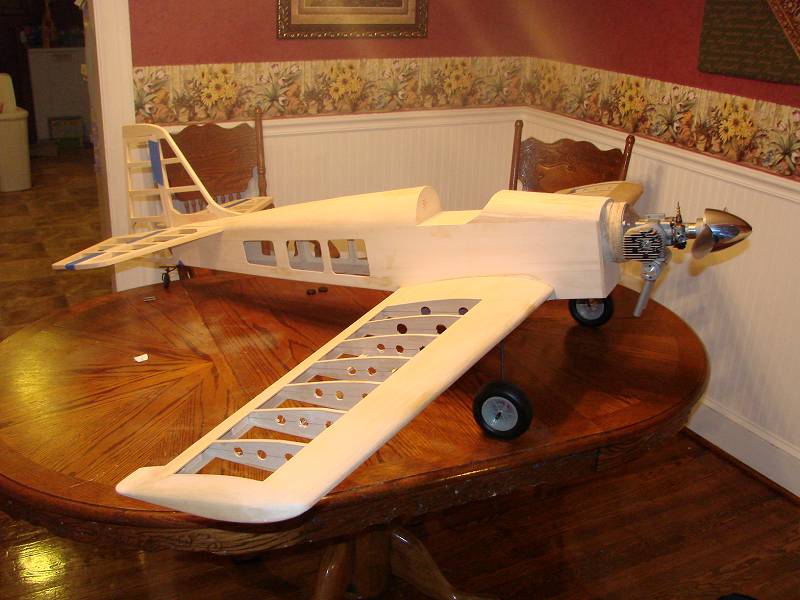

Some more progress over the weekend.
Attached is a picture of the Killer Bee framed up and rough sanded to shape. It has all the batteries, RX and tanks packed loosely as far forward as I could. It balances over an inch ahead of CG, really nose heavy. I taped two Futaba 9206 servos (not shown) that I intend to use on rudder and elevator to the rear of the fuse in a likely looking spot. Balance was still ahead of CG.! Good I should be able to balance by moving gear around. I do not like adding weight.
I also checked the incidence on the wing. Even with the nearly 3/16" step down from wing to fuse the incidence read zero vs datum line and stab. That good because I got ahead of myself earlier and used epoxy/microballoons to get a tight fit on the fuse/wing saddle.
I also worked this weekend to assemble the cowl and pants. Fit the cowl together with a lap joint. Instructions are unclear here but a smooth but joint would have been impossible. Placed CA along interior seam and sprayed accelerator to set. I next cut some 1.5 oz cloth and glassed the seams. I put two layers on the rear. It is setting up now. I hope to finish it out before the weekend. The pants still need the glass added to the interior joint. The pants were butted together and fit up pretty nicely.
Reviewed my color scheme to avoid issues surrounding the transparency of the pearl white. I had called for some white stripes on the wing but working out scheme to avoid placing pearl white over colors. I did a test run also and it showed quite a bit of bleed through. Another point is I do alot of marking with red Sharpie pens. On a some scrap balsa, I made a line with the Sharpie, applied pearl white Ultracote. The pearl white pigment seems to absorb some of the red line leaving a ghost image, could be it just could cover the red. So lesson learned early! I really like these build threads and forums. It is info and help like described in the pearl white cover problems that make these forums super! Saved me from fustration.
Take a look.
