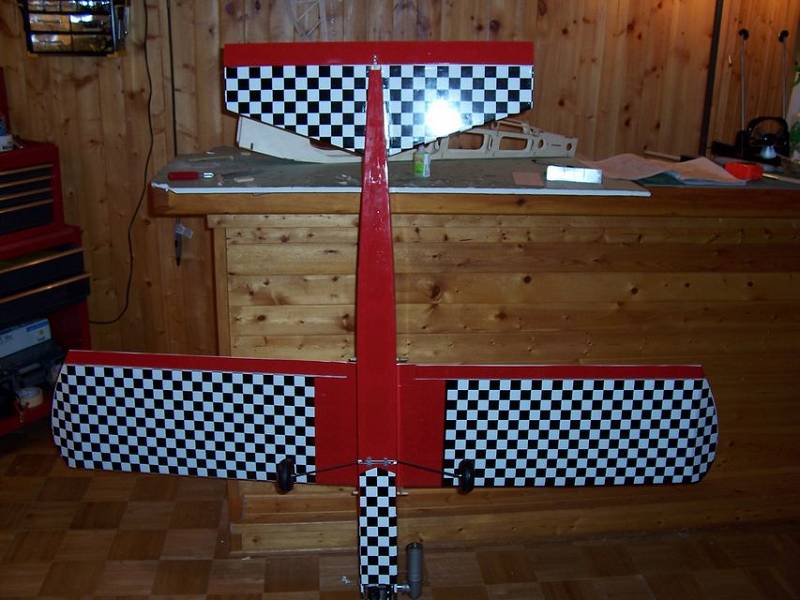

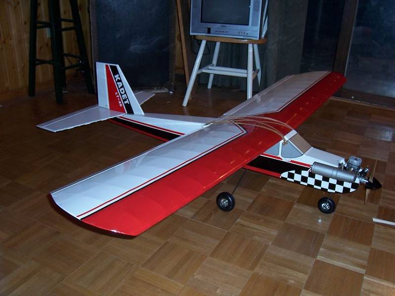

3 1/2 inches from leading edge for beginner.
3 7/8 for a middle of the road, good for intermediate flyer
4 1/4 inches if your an expert.
Hope this helps, just finihed my a week ago
