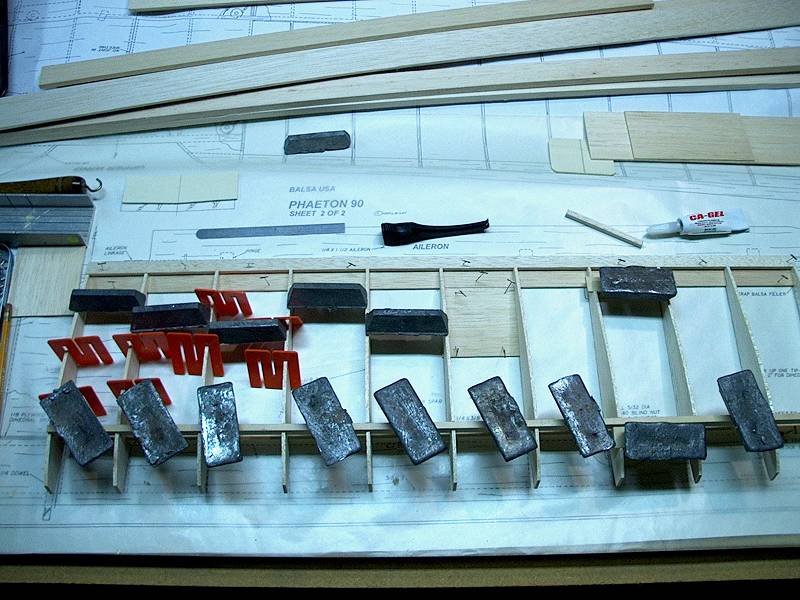

When I glue a wing I put LOTS of weight on it.
You can also stretch rubber bands between pins stuck into the worksurface to squeese the spars (and later the sheeting) down.

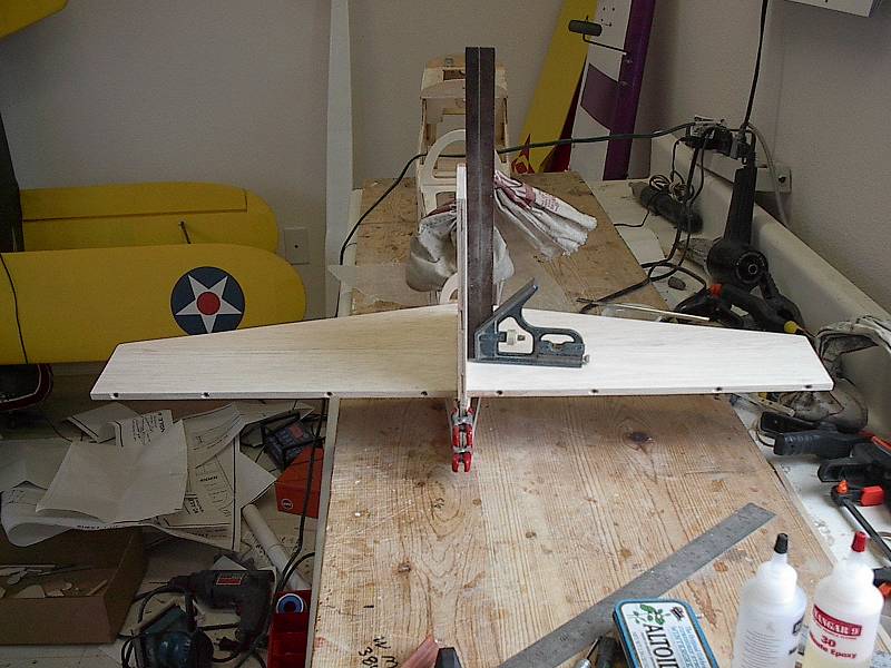

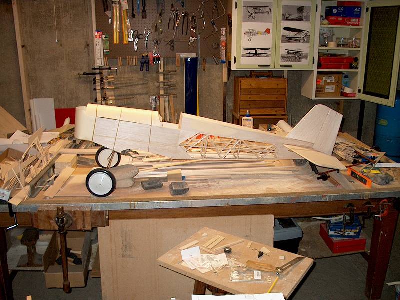

Here are two more "invaluable" rubberband tricks.
Strung between pencils or chopsticks they make perfect fuselage clamps. Can be a test of dexterity (hint, do the lower ends first)
If you look close at the horizontal stabilizer you'll see a chopstick under with rubber band over. Use a pair of each to hold the control surfaces in straight alignment when zeroing control rods and servos and for setting 0º or 0" on alighment gauges.

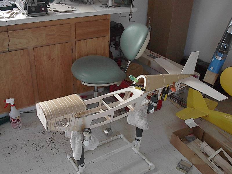

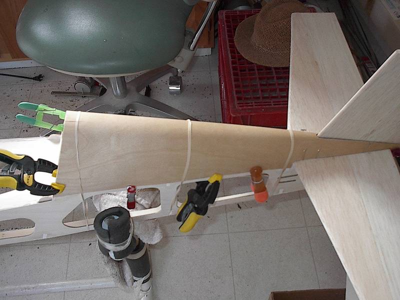

Old 01-31-2007 | 12:33 AM
My Feedback: (-1)
Joined: Apr 2003
Posts: 14,400
Received 9 Likes on 8 Posts
From: Hemderson, NV
Default RE: Help ... What did I do wrong?
I have been known to use the RBs for A lot of things but CharlieP just showed me something new. Holding spars??? Why haven't I come up with that one. Today I was out of ammonia so I just shot down the 1/32 ply with water then bent with RBs to shape. I let it set up then tomorrow I will glue and epoxy the sheeting down. This is just pre shaping to make life easier. Thanks for that tip Charlie!!!!!!!

Old 01-31-2007 | 06:30 AM
bkdavy's Avatar
Joined: Sep 2004
Posts: 2,114
From: FrederickMD
For preshaping the sheeting, I prefer to use masking tape. I don't like the RB holding because it tends to leave dents in the balsa. Masking tape is much quicker and easier to control.

Old 01-31-2007 | 08:32 AM
Posts: 1,439
From: BONAIRE, GA
Charlie P.
Are you going to round off the LE and TE of the short stubby wing in your first photo before you attach the ailerons?
Old 01-31-2007 | 08:40 AM
mikemedic2's Avatar
Joined: Apr 2005
Posts: 129
From: Johnston, RI
I just wonder how he is gonna fly that squigly plane in first post third picture. Anyone know what model that is??
