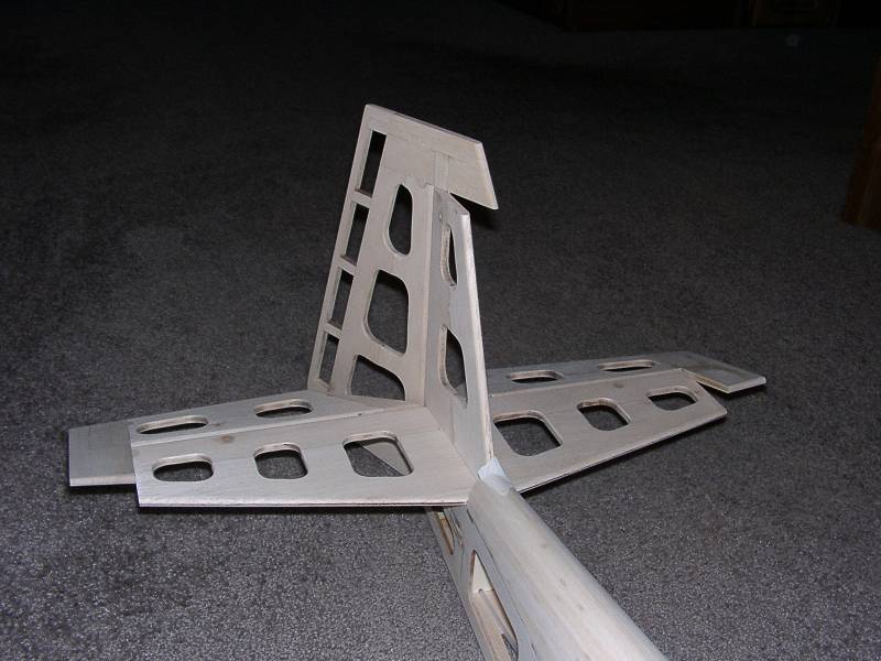

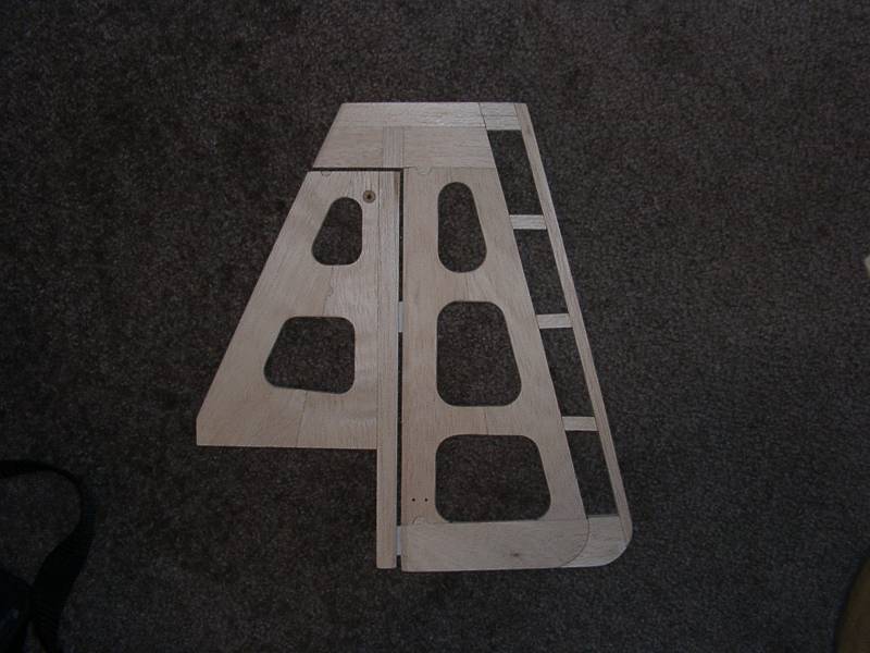

Just from my experience... counter balancing the rudder will add more authority than adding to the trailing edge. On the above thread I did both counter balance and trailing edge... but on my SSE before this one I did only the counter balance. When compared to a buddy who added about 1 or 1 1/2 inches to the trailing edge... mine way out performed his in knife edge flight. I'm not real sure on the technical explaination on this but from what I've read, the control surface (counter balance) portion that is in front of the hinge line tends to be more effective than adding the same amount of area to the trailing edge. As for the amount of counter balance... I chopped about 1/2 of the tail fin off and added it to the rudder (there's a pic in the thread).

The easiest way to understand what I did for the rudder mod is to look at the picture in Post #2 of my thread.
I have seen another pilot hover a SSE and with enough throw and an aft cg the SSE can do a flat spin (but IMO not real well). It really isn't a good platform for 3d flight. I did the mods simply for the sake of goofin' off and making the plane perform certain aerobatics with more authority (knife edge manuevers). I think most people will agree that for 3d you'll want something a bit lighter.
