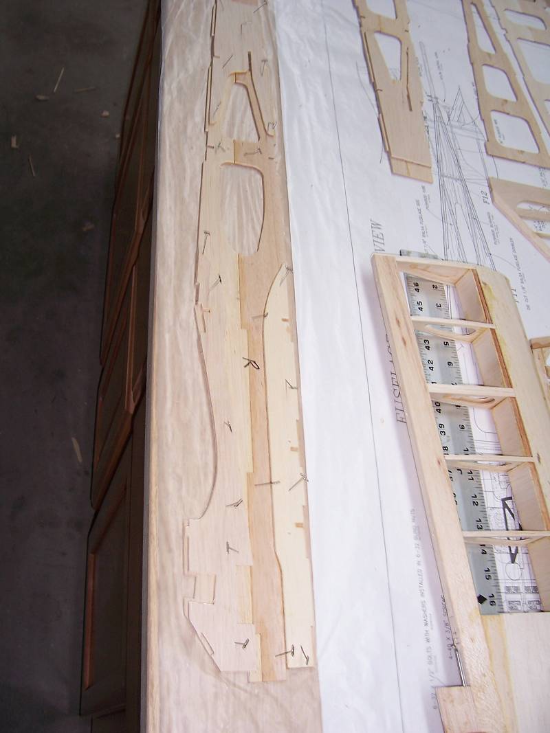

Just starting to build the Ultimate.
I have a Magnum FS52 fourstroke for it. The plans reccomend this size 4 stroke . Says unsupassed power, guess time will tell. LOL
Will post pics as the build goes.

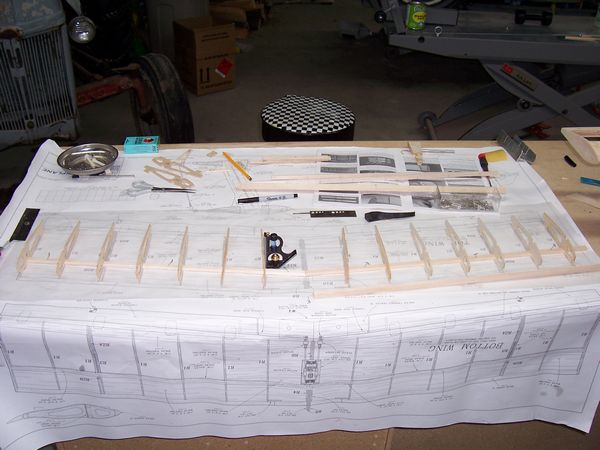

Only the stab and the fin and we're off.
First wing was fun, second wing a little less fun. Ha ha

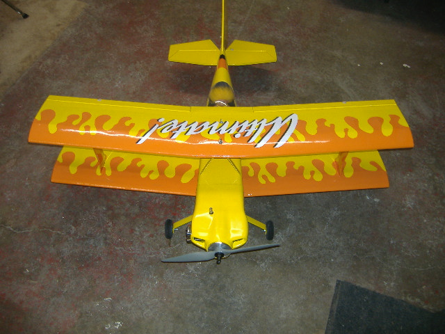

Maroon metalic and gold metalic. I do custom motorcycle painting, so I may break out the airbrush on this one.More than likely flames. But every time I do a build I seem to change my mind. I get as far as you then I`ll have to make up my mind . LOL
This LT40 started out all white like the pic on the box, but got a little side traked.

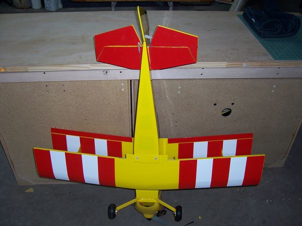

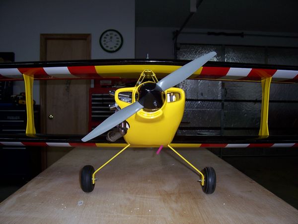

Here are some pics of my completed GP Ultimate .40. I used a Saito 72 4 stroke engine. The only mod I done to this plane is installed to servos for the Ailerons. These were built with 1/16 lite ply. I felt that moving four surfaces with one servo was a bit much.

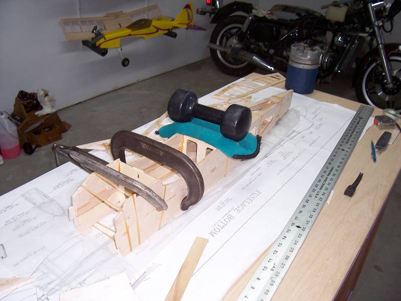

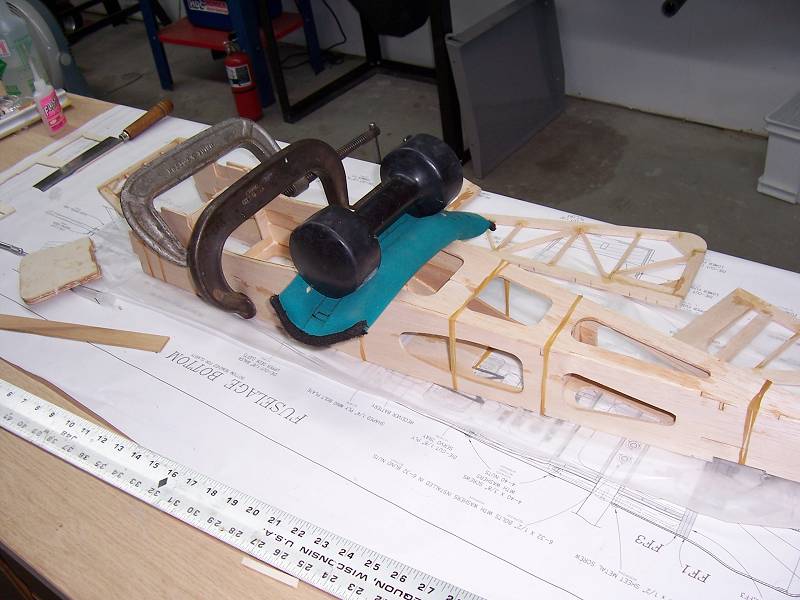

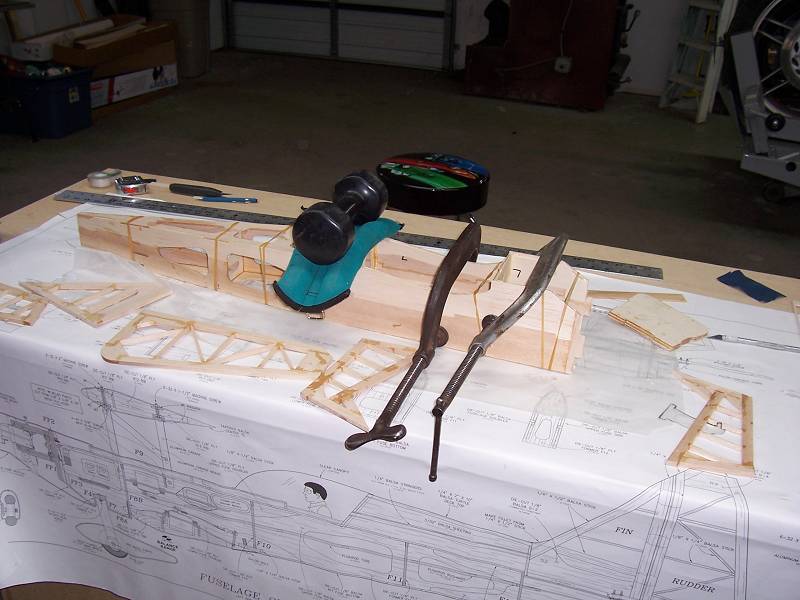

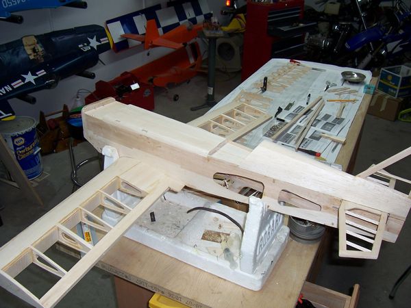

Well ? Have a few other builds out of the way . Just finishing up the covering on a Slowpoke , then I intend to finish this kit.
Did get the fuse glued up and now it`s time to glue the tailfeathers and and fit the wing ,stab and rudder square to fuse and each other.
As you can see by the pics , I had to get pretty agressive with the fuse . But I have resigned myself to the fact , that this is my build from Hell and dues are going to be paid every step of the way. lol!

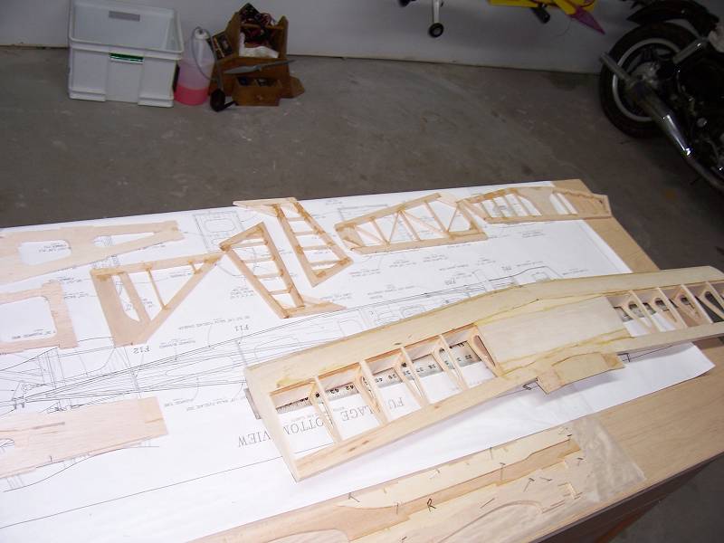

Few more pics

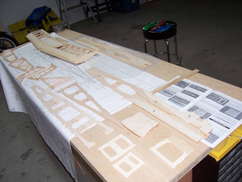

Getting closer ,! Have`nt decided for sure on the engine ,Saito .72 or OS .60 fp ?

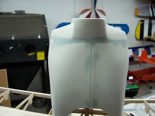

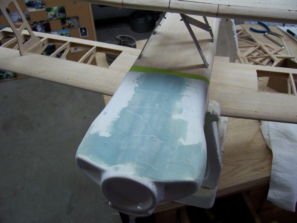

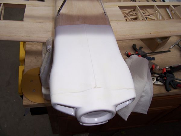

I really wanted to go with after market cowl and wheel pants , but the wife says I need to cut the spending a little , so I`m going to give the cowl that came with the kit a try . Everything I`ve read about the plastic parts , says dont waste my time with them, but hopeefully they`ll last a few flights if I mount it right.
Cut the cowl out and used CA to glue the 3 pieces together . Went over the seams real good , then sanded with 120 grit and applied a coat of lite body filler . Then sanded down with 80 grit folewed by 120 . Came out pretty good , I`ll give it a couple of coats of sanding primer and it should be ready or paint.
And the kit has remained true to form , went to cut out the wheel pants , and they gave me 4 inside right halves, lol [sm=spinnyeyes.gif] It well just have to live without any.
I might end up doing the color scheme that's on the kit box , don't really care for it , but having trouble coming up with something else, any ideas ?

Getting close , still need to pick up a Sulivan tailwheel and install the lower wing ailerons , `could`nt get the warp out f them` have some new stock coming.
Went with the Saito .72 instead of the Magnum. Weighs 6 lbs. 1 oz.
[sm=bananahead.gif] I must say , this has been one of those builds , I had to make myself finish , but I`m glad I did , it broaden my building skills .
Think she`ll fly ?
