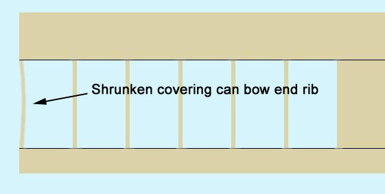

You can leave off the tips, but make sure you beef up the last rib with at least 3/16 balsa (or ply like Jim did) Or when you shrink the covering, it can bow the end rib.

I am building a 4 * some where I saw that the wingtip ribs will pull in when you shrink the covering w/o the ply. I am putting a sullivan rear wheel on mine --wont go back as far as I would like but looks ok

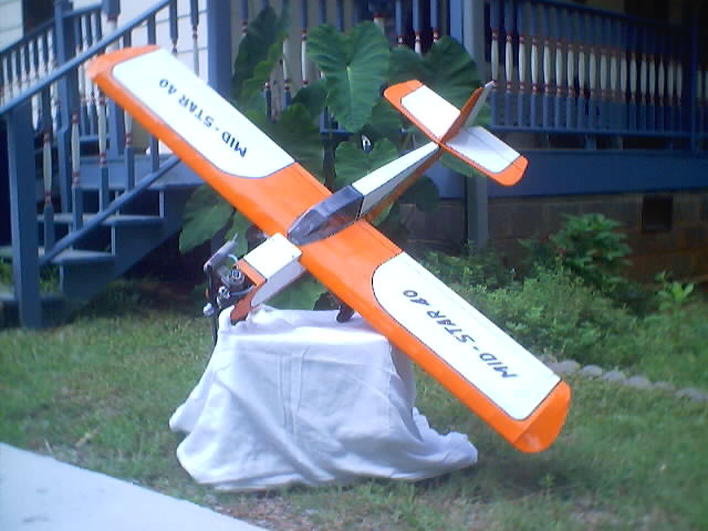

Leave the wing tips on , don't take the ailerons to the ends. Yes the spars need to be sprue the one in the picture has over 60 flights . The damage it has was from a R/C motorcycle in the pits. These are great little planes. Hope you have fun with it.
