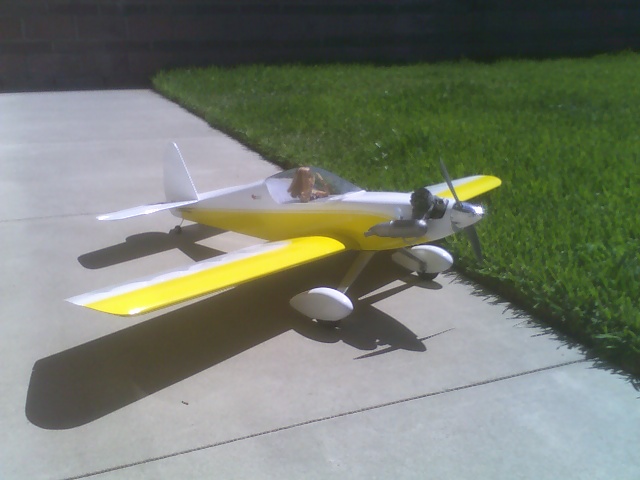

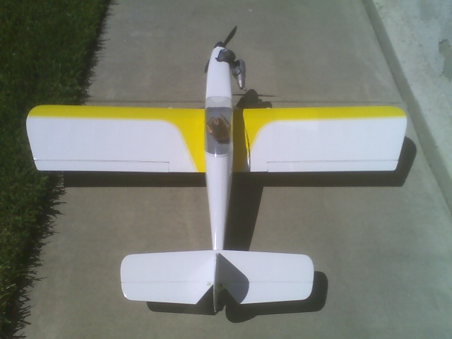

Well I finished covering this morning. I still need to paint the engine compartment and the cockpit and do the final trimming on the canopy, but its getting there! I altered my color sceme slightly so that I would be overlapping the white over the yellow rather that the other way around. I was going to cover the entire fuse with yellow then add some white stripes but as I said in my last post, I didn't like the way the grain was showing through the Ultacoat, so I decided to make the top of the fuse white. I kinda like the way it came out. I have a polished aluminum spinner for her that should look *****en against the white. I just mocked up for a couple pics, the tail isn't glued up yet and the wheel pants aren't the ones I'm going to use. Last time I built a Sunbird, I built up a set of pants from balsa and covered them with monokote, I don't think I'm going to do that again! Way to much sanding and covering was a pain in the #!@*!! I will probably order up a set of fiberglass ones and paint them white.

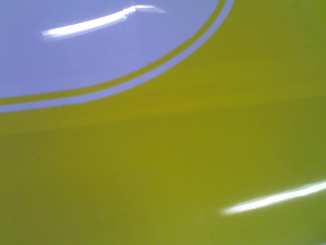

Default RE: GM Precision Sunbird
No, on the wing, I overlaped yellow over white. This is where the problem occured. You can see the white through the yellow. Look closely at this pic and you will see. Its really not a big deal and I am happy with the results.

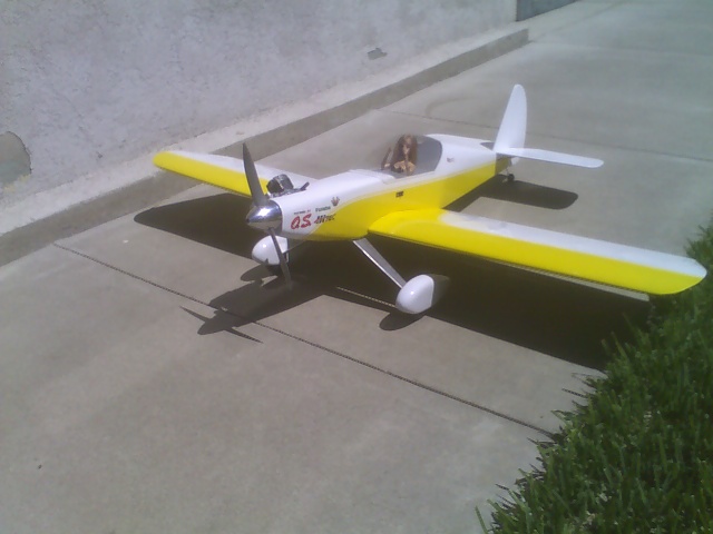

She's pretty much done! A few minor details and she'll be ready to fly. I used the Barbie that was in my dear departed Edge 540. Only now she has become rebelous and has tatoos from head to....well... torso! I hope to maiden her this saturday or maybe sunday depending on how many chores I have to do around the house. OS .46 FX, Futaba radio with Hitec HS-425 BB servos, 5 1/2 lbs.

Heres some pics

That's a pretty lookin build, jrbmoto. I like all the sheeting on this kit build. Looks very nice.
Are those airbags in front of the pilot?

Inverted flat spins are amazing with a Sunbird. Getting them to stop spinning is a challenge! This is a very short coupled airplane as you can see from the pics. A very unusual design, the wing has a fairly short span yet a wide cord, giving it a lot of wing area yet a quick roll rate. The airfoil is semisymetrical with just the right thickness for a wide speed range. It slows down very nicely for landings. Its not a precision aerobatic airplane and it doesn't do 3D very well but its a kick in the pants to fly! This is my third .40 size Sunbird, I'm still kicking myself for selling the first two! The first one I built was from a kit that was missing a lot of parts including the tail surfaces. I cut my own parts using contest grade balsa and was rewarded with a very light airframe. It flew a lot better than the second one that was completely stock. I did a few things to lighten up this one so I hope she will fly as well as #1

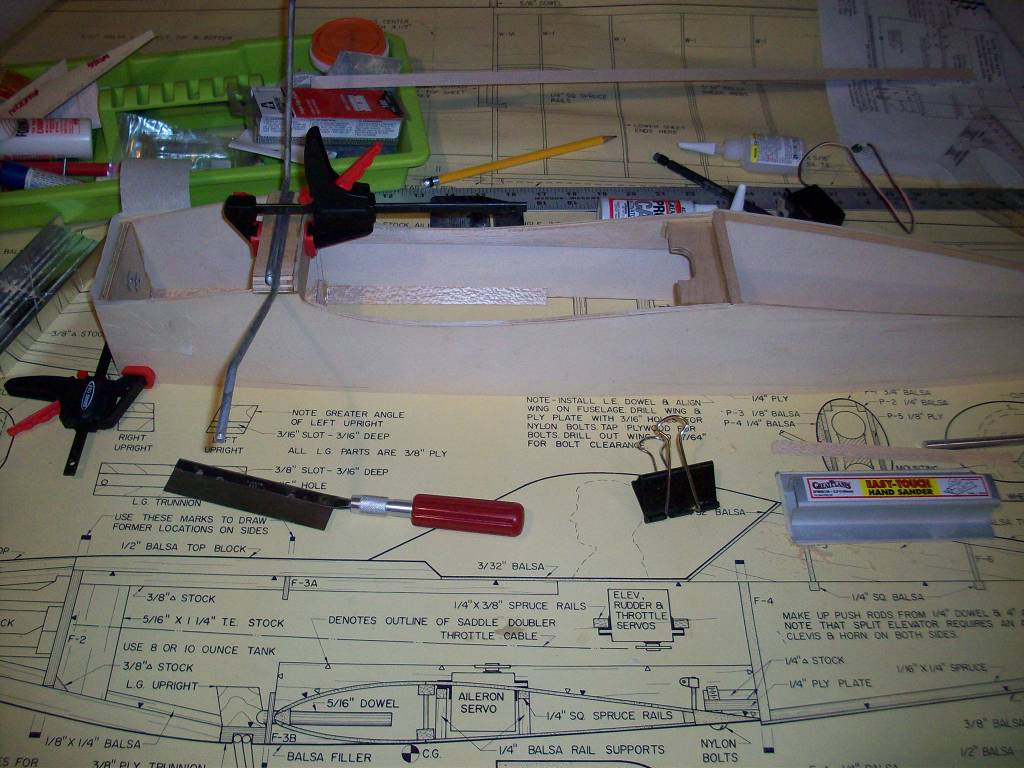

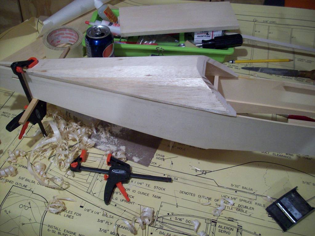

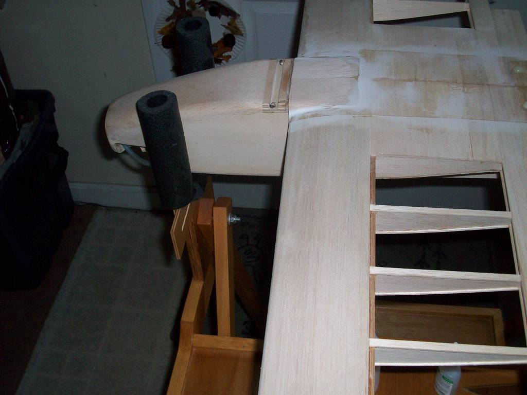

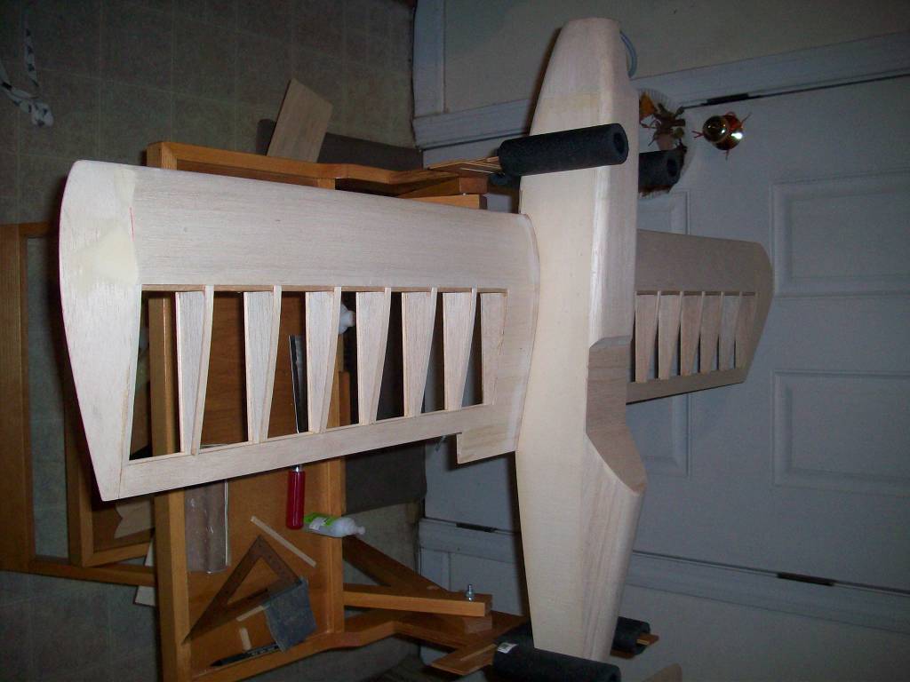

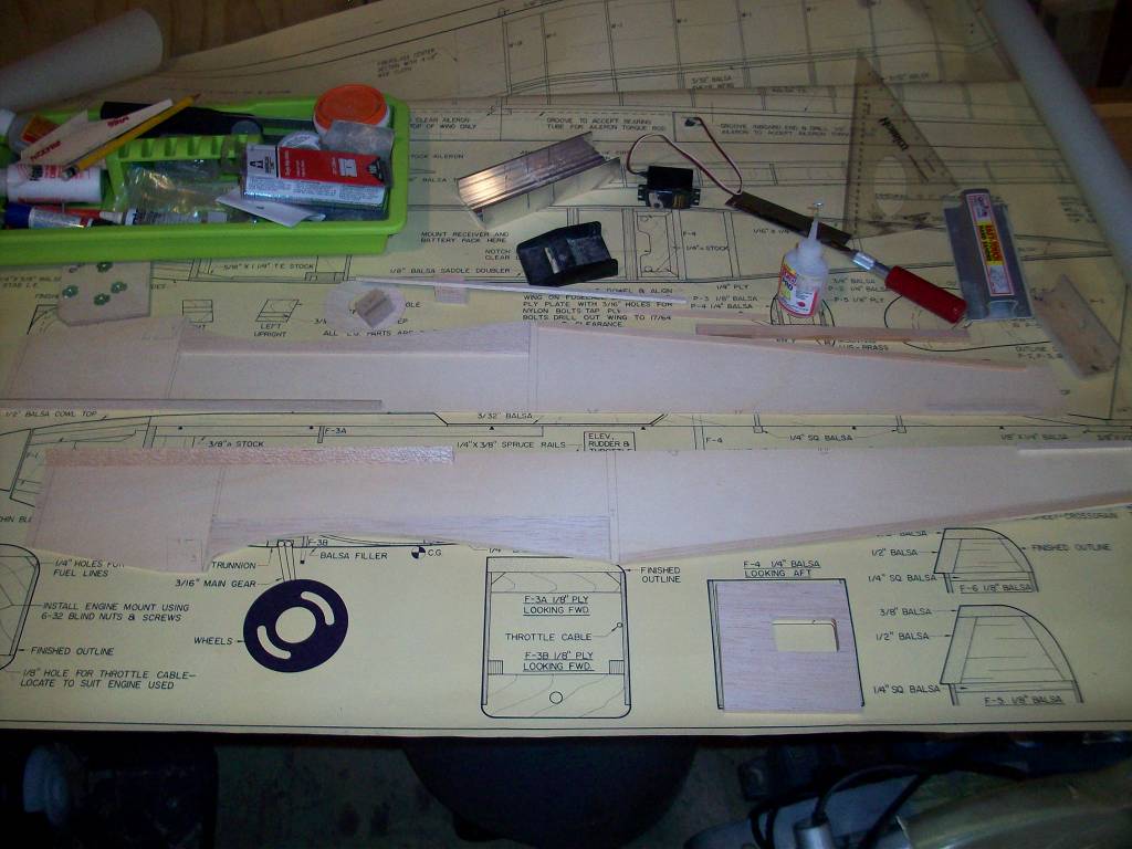

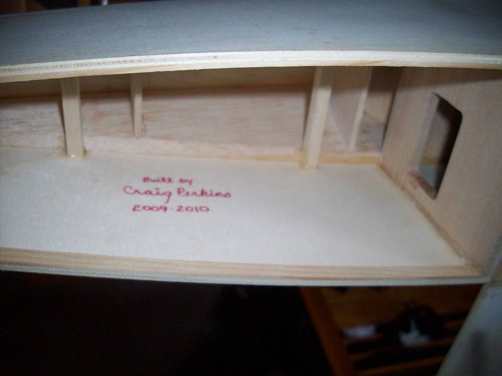

OK guys, as I told Johnny, I'll start to post some build pics of my Sunbird 40 that I have been working on for the last month or so! I'm building it in a stock configuration and plan on powering it with an (new) old Magnum Pro .45 with a Mac's quiet pipe. I have to say that this is one of the nicest kits that I have ever had the opportunity to build, and again, would like to say a big THANK YOU to Johnny for all of his help and knowledge with the GM Precision Sunbird! Time to get started! -Craig

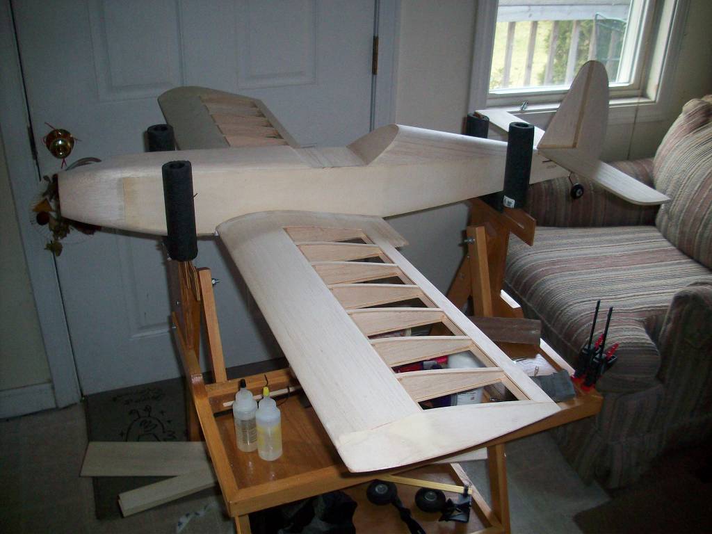

Now the rest as of this morning! I also forgot to mention that the canopy is from an Ultrasport 40. My kit did not have one, but this fits as if it were made for it! -Craig

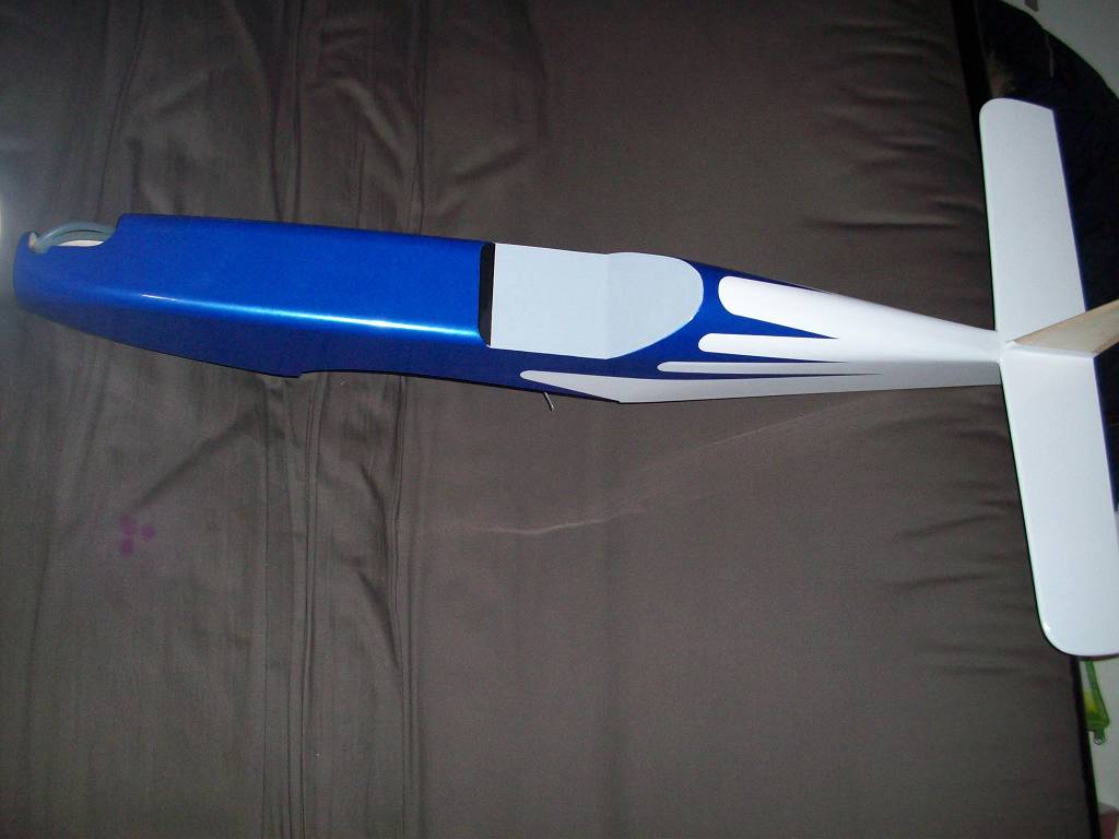

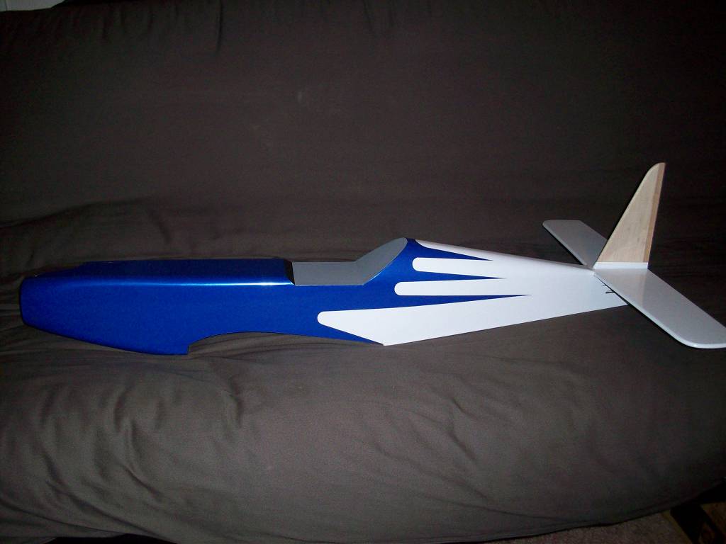

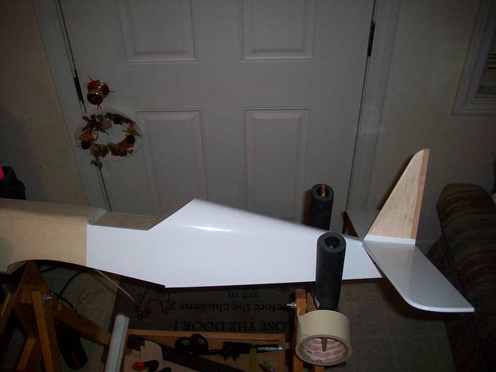

OK folks, I started covering tonight! Ultracote white and pearl blue... -Craig
