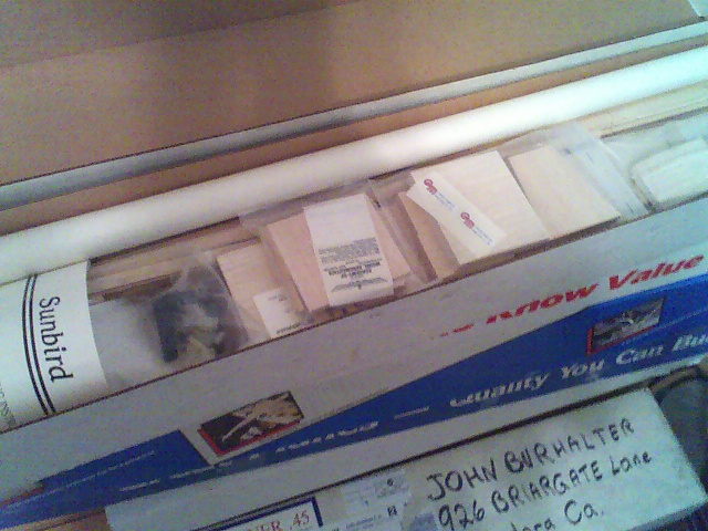

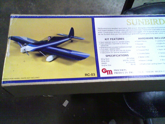

I started on my Sunbird kit this weekend. This is one of my all time favorite airplanes. If you have ever built a GM Precision kit, you know how nice these kits are!

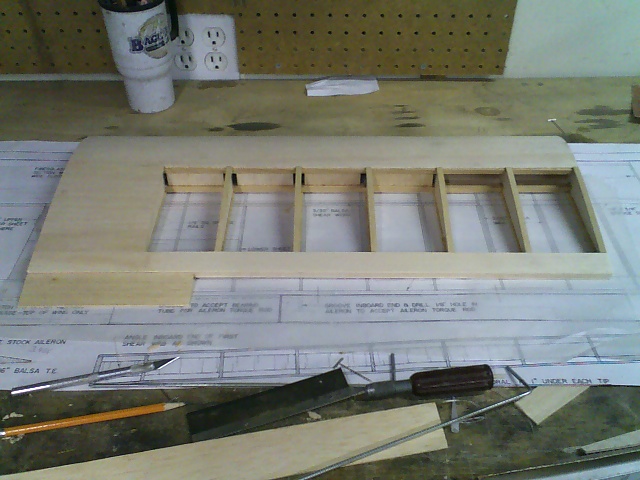

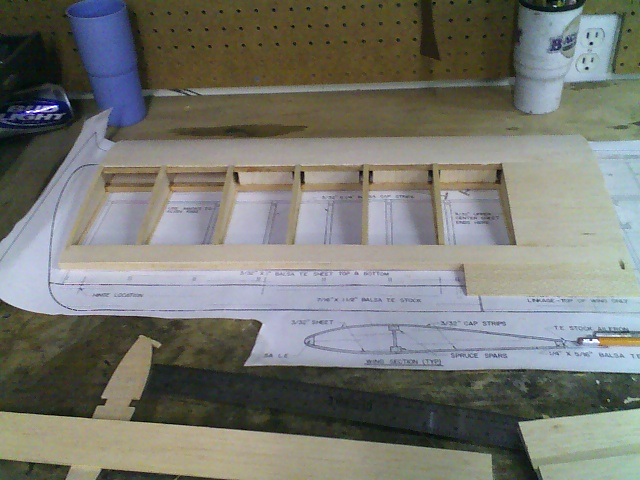

I got both wing panels framed up.. One minor mod, I eliminated one rib per wing panel to save weight. All of the wood supplied in this kit is outstanding!

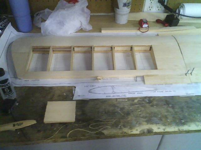

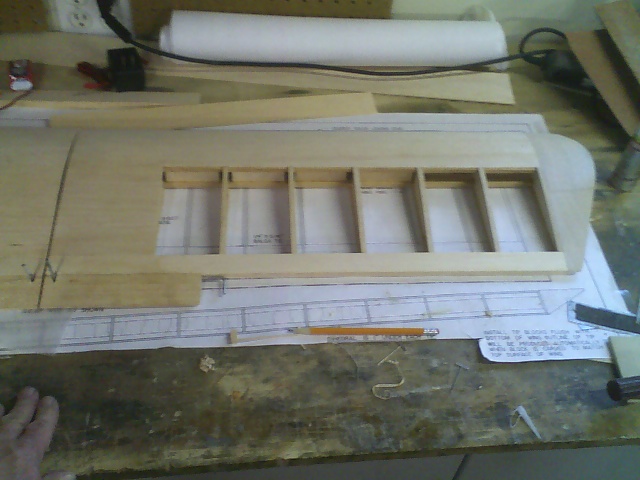

I've made a little progress. I've got the aileron torque rods installed. I'm going with a single servo for the ailerons even though I usually go with a dual servo set up. It will save on weight and I've used this set up on every Sunbird I have built with no problems. I'll pick out a new high torque servo.. I've also got the wing tips installed and roughly shaped. One small complaint, the wing tip blocks were about 1/4" shorter than the ribs that they are supposed to glue to so I had to laminate some scrap balsa to make up the difference. Not a big deal, I'm just glad I had some 1/4" stock on hand! I should be starting on the fuse this saturday, if I do, I will post pics.
-Johnny-

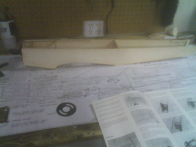

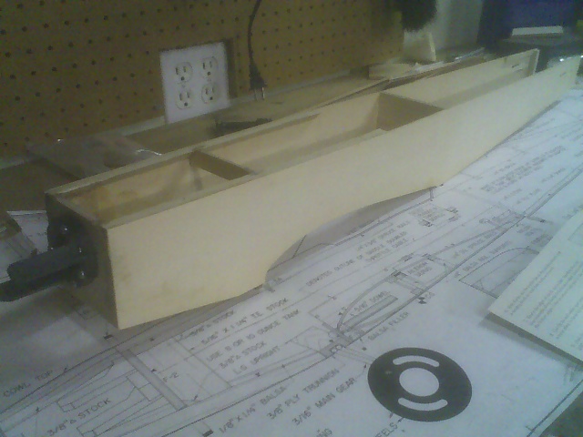

I got back to work on my Sunbird today. I have the wings pretty much done, today I started on the fuselage. I've got the basic box complete, next step is to mount the engine and build the nose out of the 1/2' thick balsa blocks. Then the turtle deck is next. The wood in this kit is outstanding! All of the parts fit perfectly. GM Precision kits are a lot like the old Pilot kits, every piece is machine cut and ready to be glued in place....no die cut parts. I'll keep posting photos as I progress.

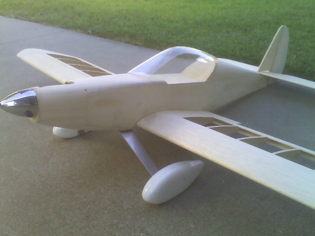

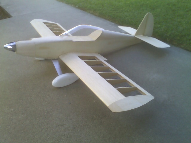

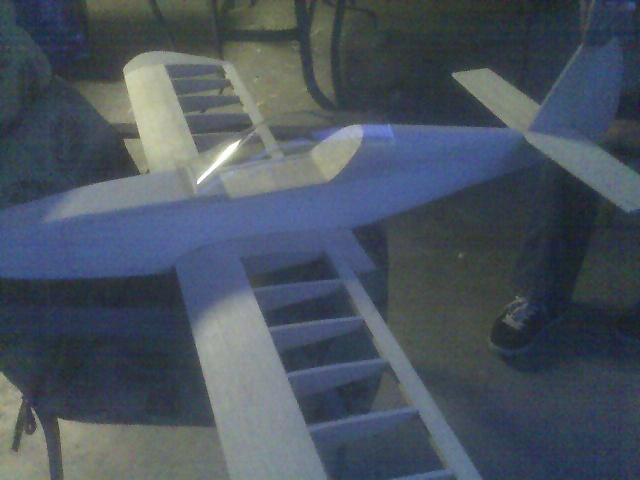

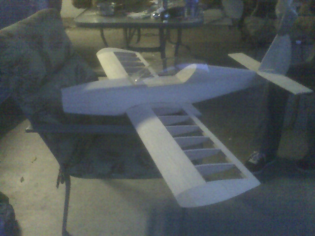

I had some time to work on my Sunbird this weekend. I mounted the wing and drilled and tapped the holes for the wing hold down bolts. I also glassed the wing center section and did some shaping on the fuselage. I also did some work on the tail...mostly sanding and shaping. She will be sporting an OS .46 AX with a MAC pipe. Still debating on the finish...I bought some Pearl Yellow Ultracoat but I am still thinking seriously about doing some kind of painted finish. Maybe silk and dope or koverall and dope. This is a rare bird that deserves a nice finish. Any suggestions???
Johnny

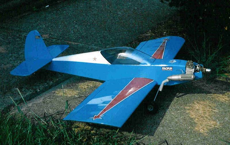

Here's mine

All right! So there is another one in the world! Looks nice, how do you like it?

I liked it real well. on it's last flight I was having so much fun I was not watching the time. I started into a inverted flat spin at 200 feet, half way down ran out of gas.
Retrived the magnum 46 and waiting for the bulsa tree to grow, planted enough seed
at least one should grow.
Pat
PS I had it in my hanger for 4 years realy liked that plane.

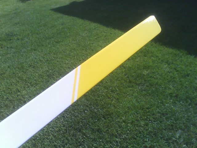

Well I think I've decided on the finish for this bird. I was looking for Super Coverite but my LHS had some stuff by World Engines called Worldtex. I've never heard of it but the owner said it was just like Super Coverite so I bought a roll. I tried it out on a piece of scrap aileron stock then painted it with some Rustoleum and am pretty happy with the results! It went on easily and after a couple light coats of primer (light sanding in between) the surface looked like glass. I just need to decide on a color scheme!
