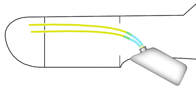

BTW, getting the tank out is easy. The tough part is getting it back in, but here's a trick:
Put some inner Flex-Rod tubes into the fuel tubing and route them through the firewall. Then just pull the tubes through and the fuel lines will follow.
What Minnflyer describes works great, but an even easier way to do it is route the tubes from the front and then attach them to the fuel tubing. This way there is no fishing to find the hole in the firewall.
