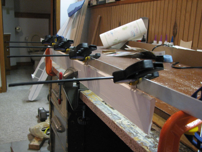

Thank-you all for advice. I ordered and received the slot cutting equipment. While I was waiting for it to arrive I proceeded re-installing hinges. Hopefully the pictures below will help explain what I did.
First, I cut the old hinges out of the control surfaces. In doing so, I made the holes pretty big (relatively speaking of course). But far too big for friction to hold the hinges in place. I needed to devise a way to hold all the hinges in place while epoxy filled the holes and cured.
I took pictures of my work on the elevator.
1. I marked the position of the hinge.
2. Then I transfered that mark to a length of angle aluminum. It has to be angle stock because it is by nature straight.
3. I clamped the hinges onto the angle aluminum, I made sure both "flaps" of the hinges sat flush on the angle. With four hinges needed for the elevator, this assured all hinges pivoted along the same line.
4. I clamed the aluminum to my workbench. You can see in the pictures I test fitted the elevator to make sure everything was set.
5. I mixed up some 15 minute epoxy, and put the hinges in place on the elevator. And let it cure for a couple hours.
6. Then I epoxied the elevator/hinge assembly in place.
The end result, spectacular! Night and day difference. As I type this, I've just finished the aeleron. Once this is cured, I can finally install the aeleron servo, and finish radio installation.. I... gorsh I can hardly believe it.. I'm only a few hours of work from being flight ready!!!

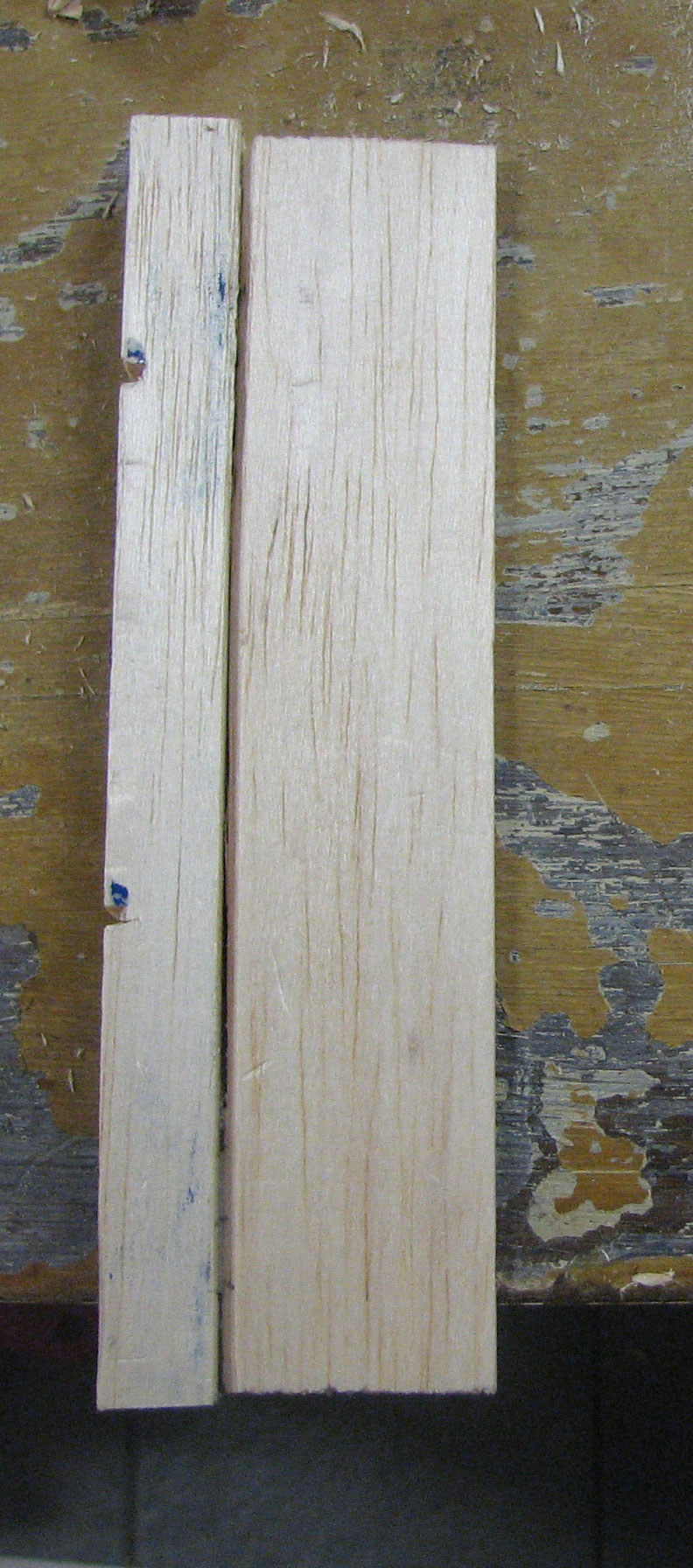

I've got to post a follow up to this thread.
While my wallet saved up money for the batteries to fly this bird, I did more and more reading.
Last week, I came across a build thread by RCKen. Seeing how well he did on the hinges on his build, and see how blankety-blankety-blank-blank bad I did on mine. I decided "make it right."
I ripped the monocoat off my wings. And I'm rebuilding it now. The wing's TE is so buggered up, it wasn't useable. So I ordered a new TE and ailerons from Sig. (Should be here next week)
In the meantime, I've modded the wing for independent aileron servos (flaperon if I want).
The biggie, I practiced cutting slots. I used scrap TE and aileron stock to make practice.
I have the slot cutting tool from GP. Works great!
I do have a couple questions. Hopefully RCKen will see this and respond. I followed his technique.
When CAing the hinges, should there be any gap between the TE and the aileron?
The first picture shows my first attempt. No intentional gab between TE and aileron. Seems OK, not sure. The second picture, I left the pin in while I moved the aileron to it's extreme, before CAing the hinges. There is a gap, slight. The pin is being held in place by friction, that's how close it is.
Which did I do correctly?

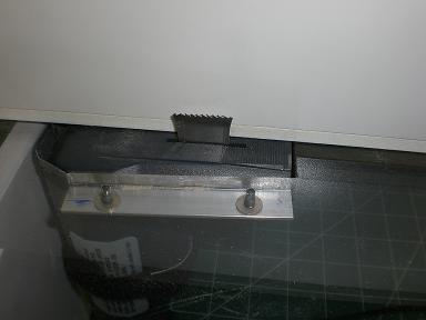

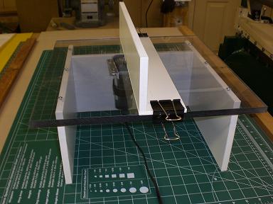

I vote for the Great Planes Hinge Slotting Machine. I use mine a bunch. I built a small table with a fence to position and hold the parts for slotting and a mount for the hinge slotter. Speed and accuracy and it makes the job so much easier and faster as well.
