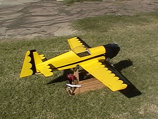

Hi, i got an email that this thread had a new post.
Im no kit expert, but i sure would not build the wing from plans for another plane.
It seems you would be asking for trouble.
RVman in this thread lowered the dihedral on his wing, If he dosnt post again you could
email him here on RCU and ask if he likes the flight performance it gave him.
I forget were i read it, but great planes's designer claims the dihedral was planned espesially for the cap 232 and should not be altered.
On the other hand less dihedral may be an advantage for inverted flight.
mine flies good inverted, with a little down elevator. which could be made better with radio mixing.
heres a pic of mine after 20 flights, im still adjusting the trims and balance in all additudes for precision flight.

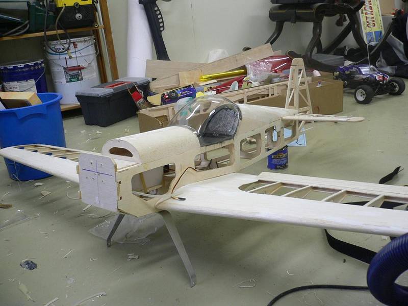

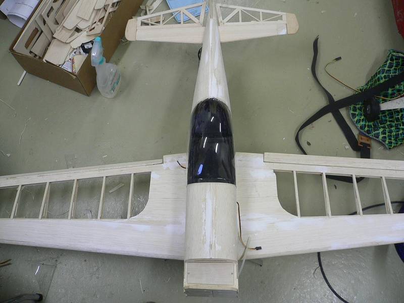

Hello everyone! This is my first post here
I have the Cap also. It is ready to covering.
I think that motor will be Os 46Ax with Pitts-style muffler.
Colourtheme is red and white. Registernumber is F-GRPA. Check the photo

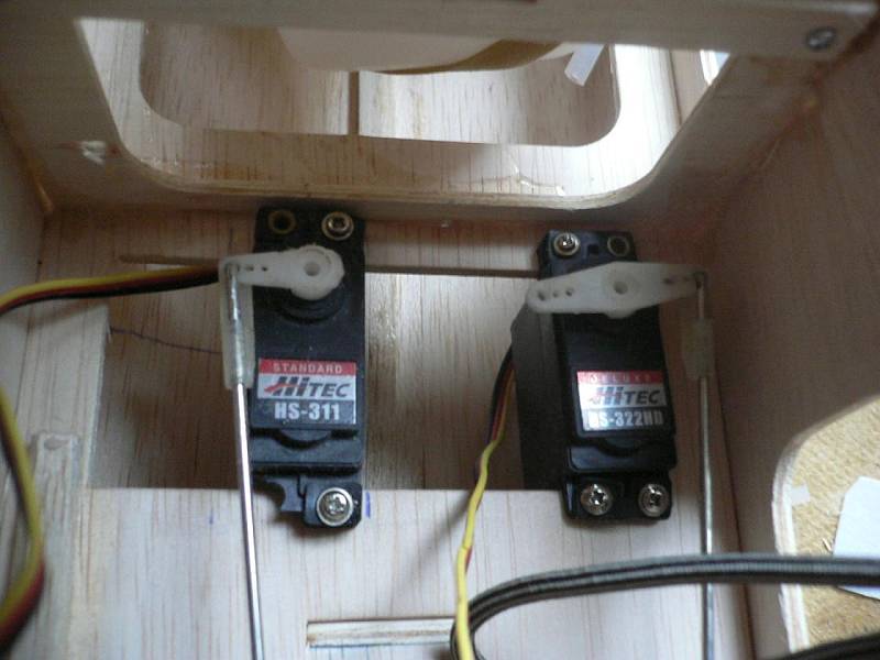

I made some modifications to my Cap:
Pull-pull system to the rudder.
Two elevator servos
Two aileron servos
The construction is really original. The kit is the best than i have never built I like Great Planes kits
I really want to see how my cap flies...
Have fun with your Caps!

looks like you are doing a class A job!

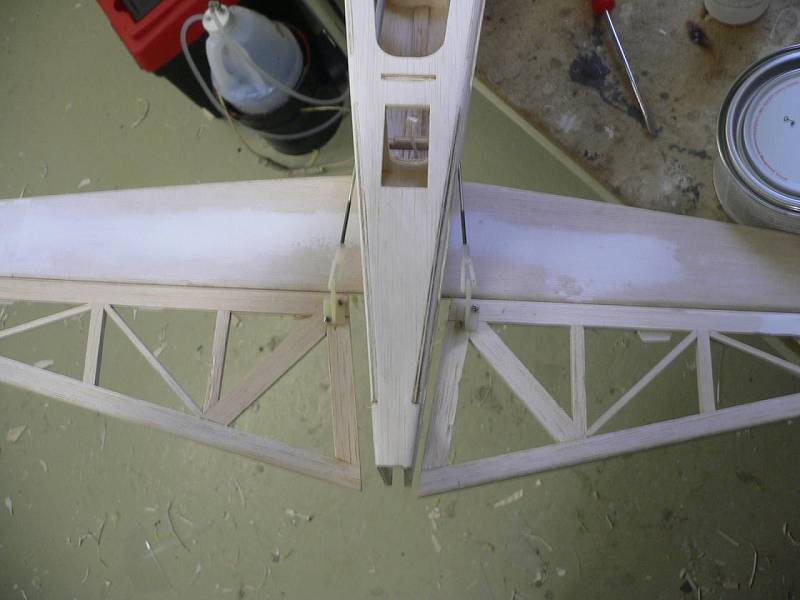

post some pics of your servo set up, id like to see your elevator placement.

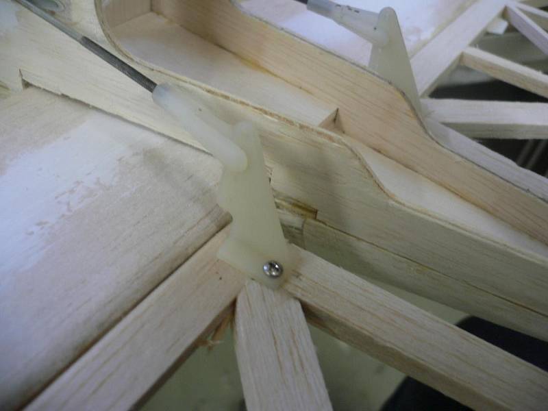

Here are the pictures.
I have painted the cockpit area yesterday.
I bought the motor and other parts to my Cap few days ago. I think that i get my parts in next week.

looking good be sure to tie those clevis down well so that u do not have any loss of control issue....
Old 10-21-2007 | 09:08 AM
  #144
Joined: Jul 2007
Posts: 29
From: Seinajoki, FINLAND
Default RE: GP Cap 232 40 Size Build Modifications.
I now that those nylon clevises can get loose, but they worked in my 1/6 scale Citabria very well.
I will check the clevises before the flights

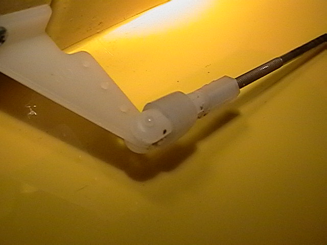

i think what krayzc-RCU means is use a piece of fuel tube 3/16 long or so slipped over the clevis to insure it cant open.
dont just rely on the clevis alone. the clevis alone may hold, but this is cheap insurance.
these type of clevis are fine to use on the smaller planes. they will last many flights with very little wear.
nice job on the canopy tint,also good thinking painting the cockpit so the balsa color cant be seen.
your tank is going to be way too low! unless you are using a fuel pump. it should be center of tank inline with the carb level.
you can raise it with some foam layer. the foam will also help prevent the fuel from foaming from heavy vibration.

I remember, that i have seen the fuel tube around the clevis.
Tank is too low...Ok. The motor cant´t get enough fuel? I raise the tank, when i remember with a peace of foam.
Thanks about the tips![sm=regular_smile.gif]

alfred, what brand of pull pull system did you use?
Old 10-23-2007 | 07:45 AM
  #150
Joined: Jul 2007
Posts: 29
Your pull-pull is very nice and that servohorn is really cool![8D]
I put the elevator servos in the fuselage, because it looks better. Your system is really nice too.
What is your Caps weights??
