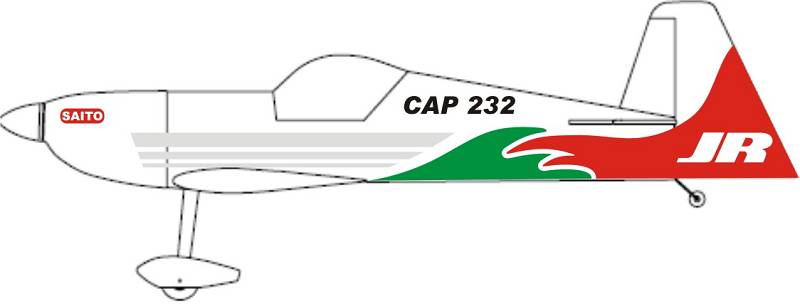

The trim that I am planning to use is partially copied from the Sebastiano Silvestri newest design; I also noted this trim on other different plane in the last issue of Model Airplane News and really look cool.

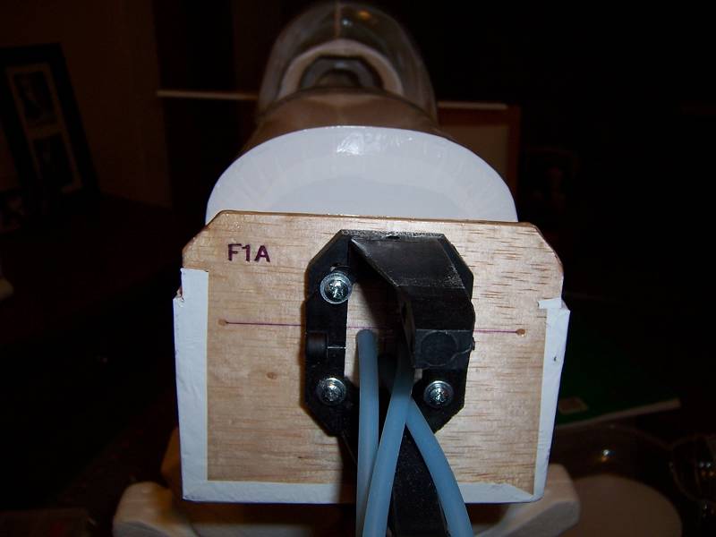

I just started mine too and intend to do some mods mostly for weight savings. I will be interested to see how you do the pull pull system; are you planning to cross the cables?
I took a dremel to the fuse and took off 1/4lb, it is somewhat overbuilt. Also the rear formers, i made new ones from 1/8" balsa. Haven't started the wing yet but will make 2" ailerons and also dual aileron servos. I crashed my old one and liked it enough to buy another. Less weight is definitely better, I hope to get it sub 5lb.

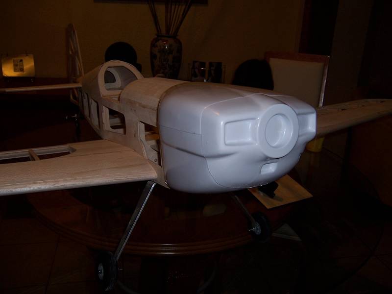

whats going on with the cut-out around the cowl?

GP supplies the worst IMO abs cowl you will see, its made in 3 pieces therefore the 'cut-out' that you see. Recommend a fiberglass one.

I did not mention the reinforcement of the landing gear support as a modification but any way I did it, I will post tomorrow a picture of it.
The cowl is very weak; I am at the point of thinking that instead of investing more time on finishing this cowl I would go ordering a fiberglass one.

ORIGINAL: alfredbmor
I ordered the cowl for my Cap from Fiberglass Specialties. There were some lines from the mold that had to be sanded off and filled with a little putty but it is much better and stronger than the thing GP puts in the kit. I would definitely recomend it.

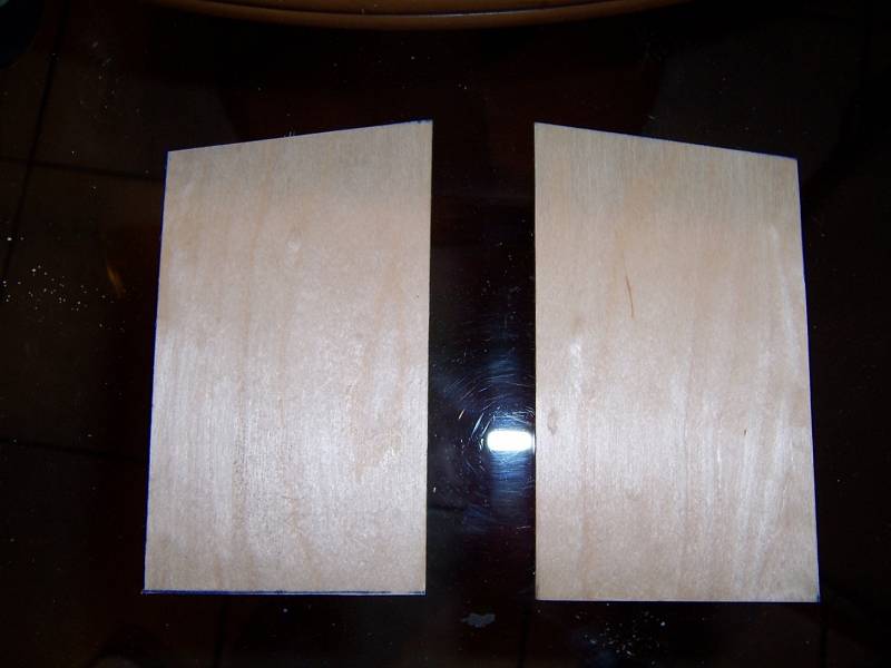

Here is the “fix†to the landing gear, it is a ply doublers or tripler that gives strength to the landing gear support hardwood. This kind of “fix†is the same I did for my Funtana 40 size and now is very reliable.
Servos, tank, pull-pull and covering monokote have arrived from tower so now it is time to go to the workbench and do my best.

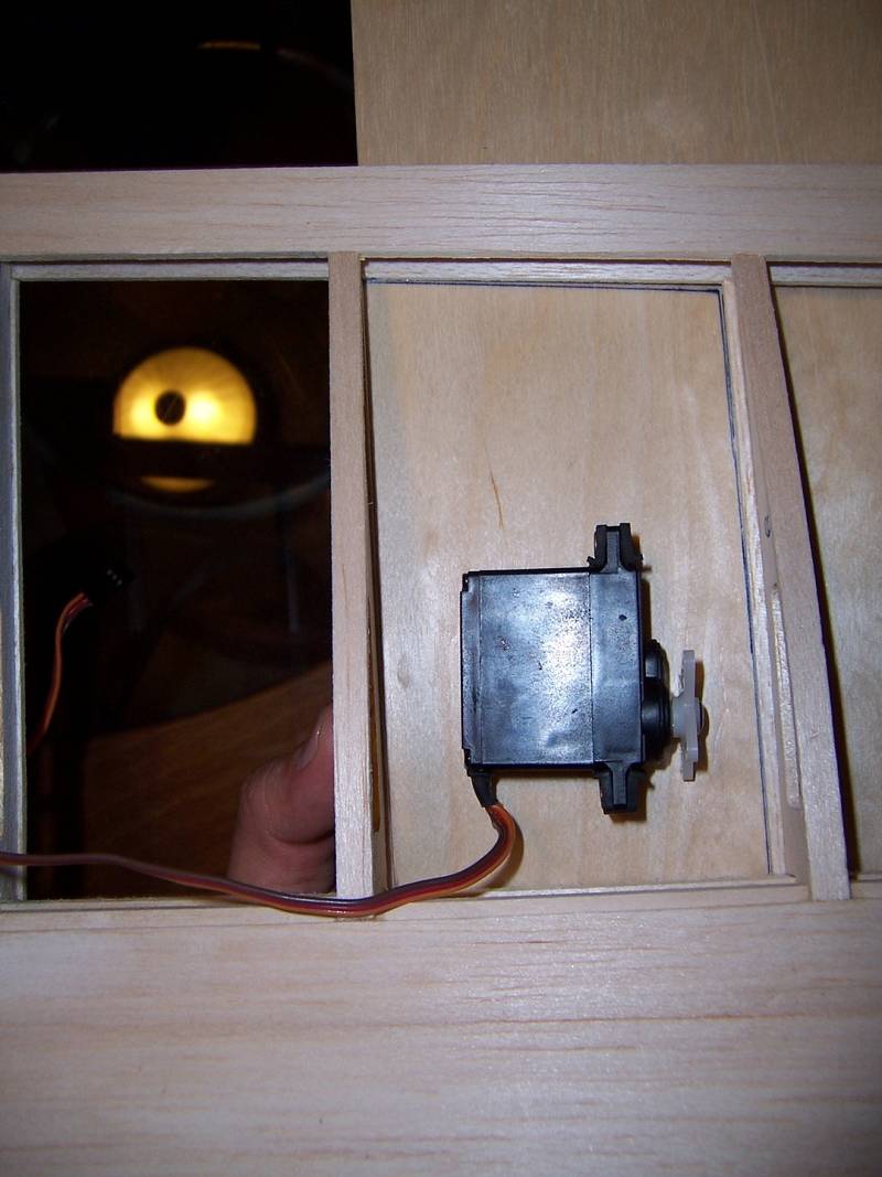

AILERON SERVOS INSTALLATION
I cut eight triangles from a ¼ ply and glued in the corners of the bay as shown in the picture. Before placing the servos in place I made some measurements and drew some lines to locate the servos at an equal distance in the wings (Will help with the final lateral balance) and the push rod will run 90o from the trailing edge (Will help to travel the same amounts of distance). From hardwood I made the servos supports, made the final measurements and glued in place with 6 min. epoxy. When epoxy cured I lightly sanded on of the blocks so it won’t protrude on the other side of the wing and made the servo arm hole. I also drilled 1/16 holes in the corners of the hatch and installed in place with screws. The second servo is the same procedure and finishing installing the second servo I will start with the dual elevator servos installation.
Thanks for following this thread.

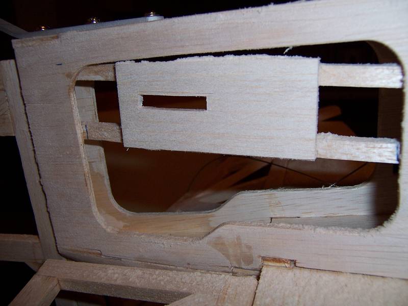

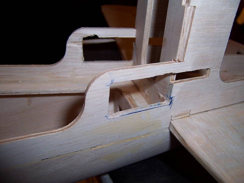

DUAL ELEVATOR SERVOS MODIFICATION
Installing the dual elevator servos are a simple task using this mini-servos, on the fuselage sides, right at the elevator push rods exits I drew what is was to be the servo bay, I took care on the alignment using this push rod exit as a guide, then used the dremel tool to make the bay, then sanded to fit ok.
Photos speak for their self.
Push rods will be installed after covering.

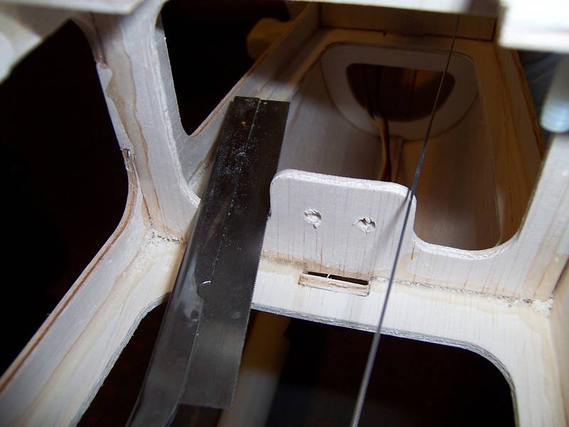

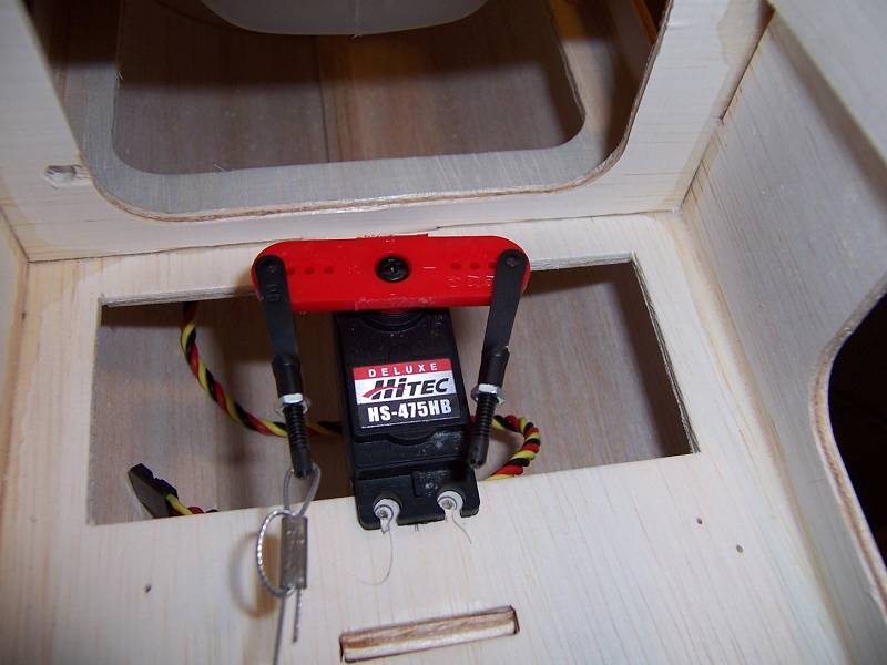

RUDDER SERVO INSTALLATION USING PULL PULL SYSTEM
Considering the existing bay servos I decided to install a HS-475 Ball bearing servo, with 61 oz at 4.8 volts force which I believe enough for this planes size. Firstly I measured the bay and installed the servo at the center of the bay, I clipped the cables to the servo arm and run them trough the inside of the fuse, finding that the tab of the middle former that is intended to hold the elevator push rods was blocking the cables from running free so I cut this formers tab, I installed again and cross them to see how they run and found necessary to beef the back of the fuse where the cables needs to exit, I could leave them just like that and reinforce the covering but I want to use those nice plastic push rod exits and decided to beef them out.
I will perform some other tasks as the engine installation and the covering which I intend to post here, so keep around and keep posting.
Thanks.
