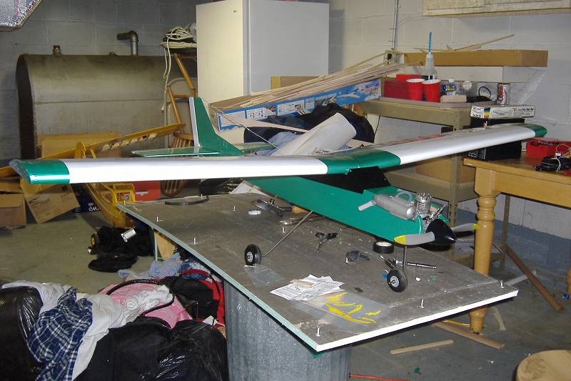

I built my PT with the bolt on sport wing. and no washout. Make sure you build on a perfectly flat table and read the instuctions
a few times before starting. Very easy build and can be done in a resonably short amount of time. Remember to
take your time and dry fit all pieces and sand parts for proper fit.
Good luck and happy building.

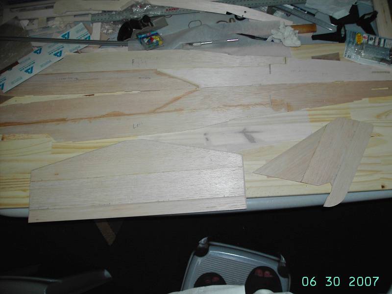

I have a question: When I glue two parts togather, should I glu them from both sides or no? Because as I see now from one side they are glued and from the other side no.
Another question is: What I have to do if both of my Fin parts are not strait? I mean that both of them have some initial curvature.
Old 06-23-2007 | 10:29 AM
Alex7403's Avatar
Joined: Jun 2004
Posts: 1,594
From: New york, NY
Default RE: Building The PT40
Hello Dan,
how bad is the curvature?
about gluing, i attach the parts together on a straight board with pins, then i drop few drops of thin CA on them and let it hardened.
Alex
Old 06-24-2007 | 02:05 AM
Joined: May 2007
Posts: 11
From: Beer-ShevaNegev, ISRAEL
Thank you alex,
the curvature is not so bad, it's small.

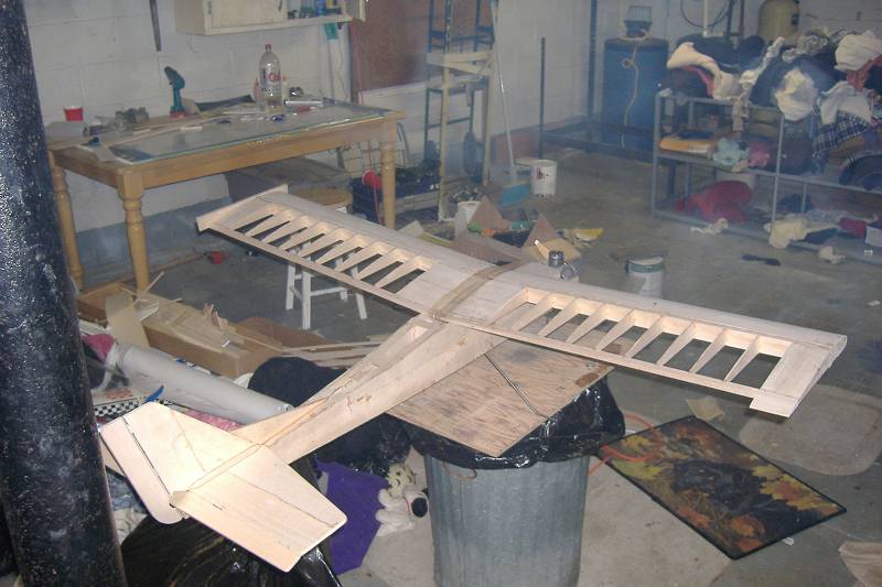

Old 06-24-2007 | 10:42 AM
Joined: May 2007
Posts: 11
Hi Alex, I asked about the form of "V", but now I'm fine.
I finished the tail and started the fuse sides.
Tell me when your plane is finished.
Dan
