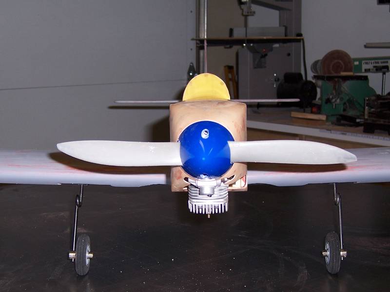

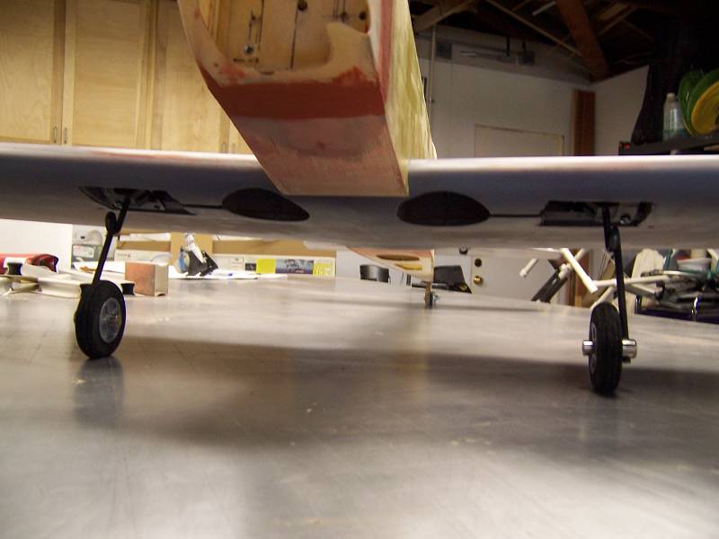

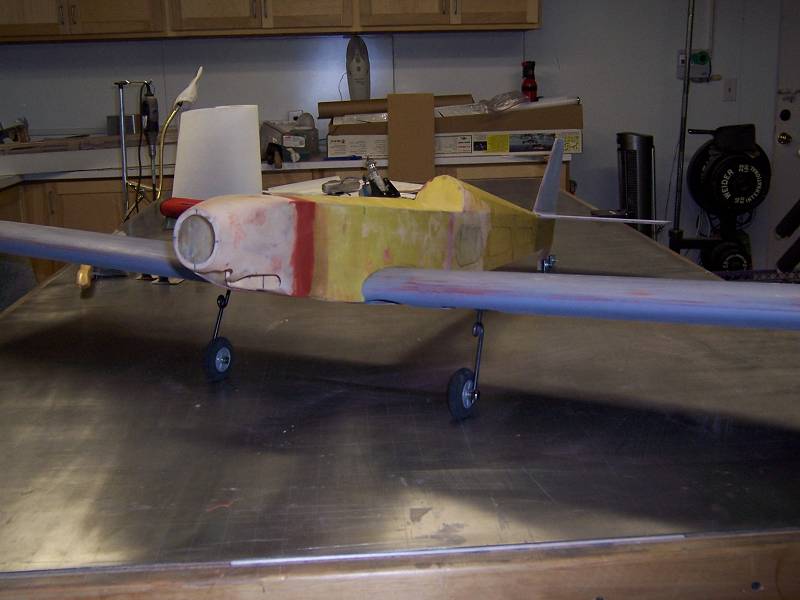

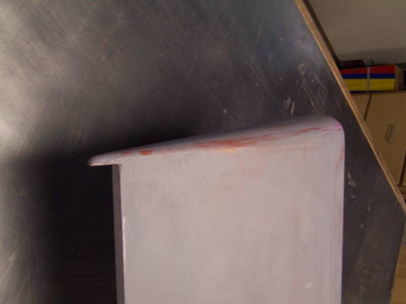

I'm in the process of a 4 * 40 build with quite a few mods. This is my second 4 *. My first one had two simple mods, clipped wings and a cut down canopy. I lost it due to reversed ailerons. After getting my tx back from repairs, I forgot to computer reverse them and ...
The mods on my current build are more extensive.
Clipped wings
Rounded wingtips
Fully sheeted and glassed wings
Air retracts
LED wingtip nav lights, strobe and landing lights
Fuselage fully covered in FliteSkin
fiberglass molded full cowl with OS 50SX mounted inverted
Redesigned vertical stab and rudder, designed after the Venture 60
I'll try and get some photos tomorrow and post them.

The way it's constructed, you should be able to do almost the entire build without the engine. The only suggestion would be to leave the front turtledeck off until you have the engine. This will allow you to mount the tank and route the throttle cable with proper placement and ease. This will most likely also mean holding off on covering the fuse too.
Here are some photos of my 4 * in it's current state.
Scott

And a couple more.
Scott

Saramos I had planned on spending the afternoon working in my tiny shop but after seeing your working space you have ruined my day. [] Your working table is great.
Old 06-29-2007 | 09:35 AM
saramos's Avatar
Joined: Dec 2003
Posts: 3,057
From: Northridge, CA
Default RE: 4*'s all and every!
I started off working on a 2' x 4' piece of MDF topped with ceiling tile. When I realized that this was a hobby I wanted to continue to persue, I decided to convert my garage into a workshop. My buildboard was inspired by what I found on Paul Johnson's website at www.airfieldmodels.com. I spent a good 6 months to convert my garage, building the table, rewireing, adding a/c, and builiding two walls of cabinets from scratch.
Scott

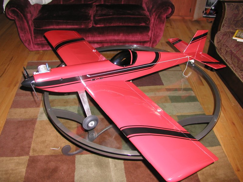

Ok, here's m Four Star 40... I built it 4 years ago and it's still going strong.
Mods include:
Balsa cowl
Fully sheeted turtle deck
Downsized canopy
Scratch built wing
Sheeting from LE to spar/caps from spar to TE
Oversized ailerons
1 bay shorter on each side
Dual aileron servos
Rounded wing tips
Flies great! The OS 46 FX in the nose is getting tired, if my SuperTigre 51 will fit in the cowl, that's what is going in there next.
-Todd
