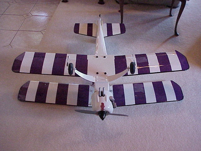

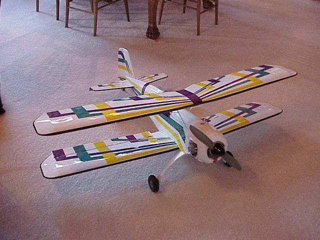

Bob, I am just finishing a GP Super Aeromaster. It is a great looking plane, but boy oh boy, is it heavy. I had to cut a window in the side an make a hatch so I could install the on/off switch and crarger jack. The sides are 1/2" thick. This is an obsolete kit, but there may be some other "old school" kits out there.
struts between the wings was an option. It looked as if it would be an easy modification after the plane was finished, so I skipped them. Now that the plane is almost ready, I'm sure it's going to need them for any serious flying. Still lots to do on it. The cowl and wheel pants are going to take time. I may have to strip the primer and first coats of paint on the cowl as I'm afraid the TopFlite clear is going to blister the paint I have now.

Don, that's A nice job on the master and you sure will be able to see it. I have been flying mine for A couple of years. I went with the straight bottom wing angled top because I have been known to change engines now and again. Roll rate is slow with the ailerons only on the bottom wing. I used 2-56 wire and made up N-struts with ball ends.

Don, what Gray Beard said. Nice looking plane. Let me know how it flys when you get it done.

We have a static display at Airport Day next weekend. I would like to have it finished for that and display it. Then hopefully the folowing Monday, maiden it. Boy it sure is heavy though. Right now, it is tipping the scale a 8.6 lbs. I'm guessing that by the time I have the wheel pants finished and the cowl mounting and painting done, if I don't need to add weight to balance it, I'll end up real close to 9 lbs. That should put me at around 22 to 23 oz/sq ft. I guess that isn't to bad, but that fuse sure weighs a ton. It weighs 6.2 lbs without the wheel pants.
If I like the way it flys, I think I'll do some redeisgn work and build up a fuselage with light ply vs the 1/2" thick balsa up front. I'll bet I could shave a couple pounds of the finished weight. Actually, even though the wings are not to heavy, 14 oz on the top wing and 20 oz on the bottom, including two servos, I think I could improve on them also. Guess I'm addicted to building
Gray Beard, I'm thinking seriously about adding the N-struts. The striping on the bottom of the wings is seperate pieces of covering, so I would only have to replace two pannels of covering for each wing and not touch the top covering other than to cut a thin exit hole for the ply to exit. By the way, how did you handle the loose wires in the top wing mount? I can chuck the wing up and down with the llittle mounting taps in place and screwed down. I'm guessing this is a "design feature" that allows for changing the incidence of the top wing
