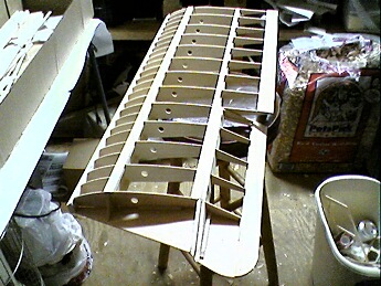

Here is photo of the left wing.

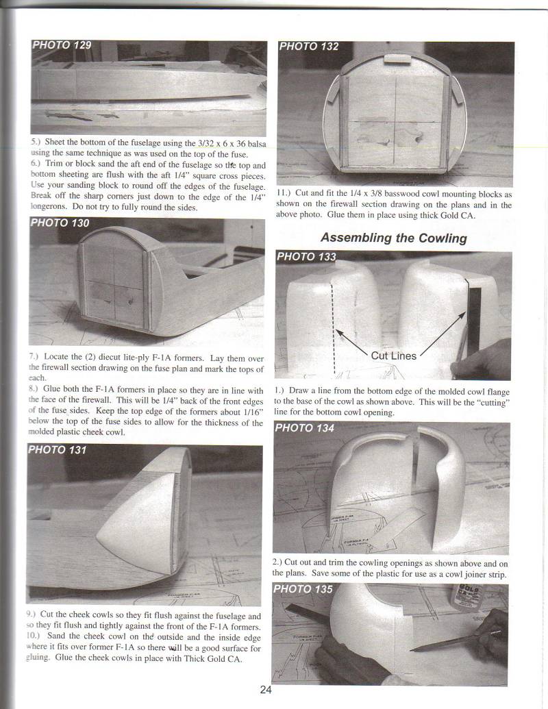

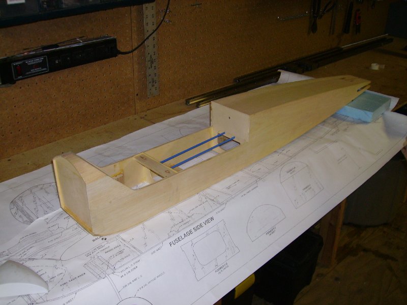

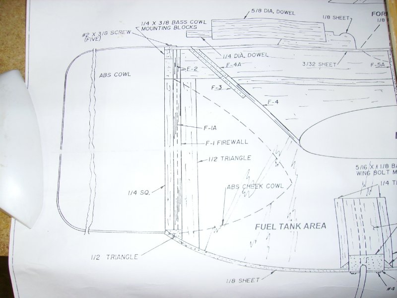

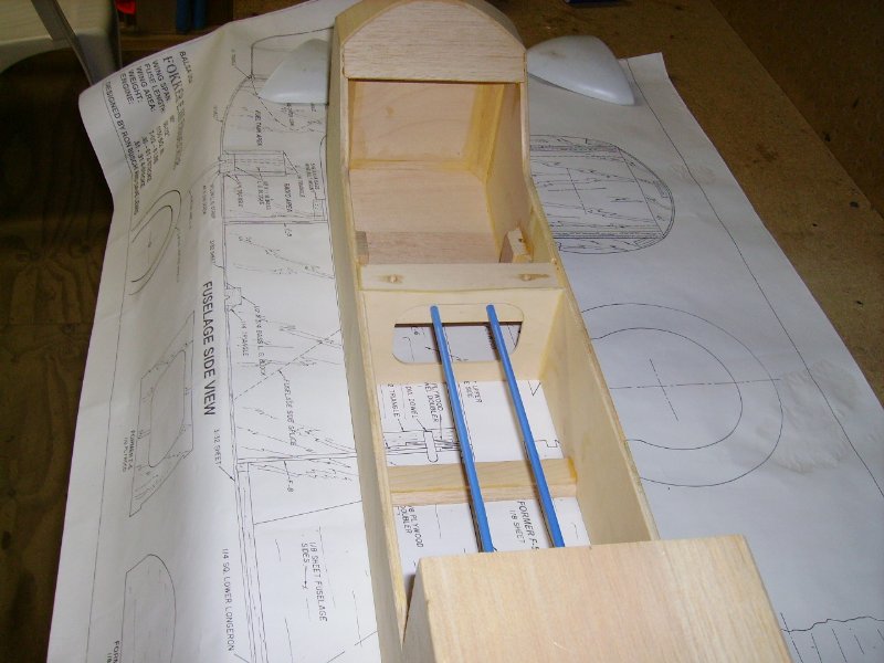

Hey Guys, This is my 1st post and I have had this thing boned up for a while now. I pulled it down a few days ago and thought Id finnish up this baby. It also is a 90 size balsa usa eindecker. My only problem is I lost the manual. I need to see if someone has the manual page to installing the cowl formers. I have to cut new ones out of stock and I am not sure if they are ply or balsa. Do you think someone could photo copy the page or pages around installing the cowl formers?
Thanks Steve

Old 02-12-2008 | 05:26 PM
  #46
Dead eyes's Avatar
Posts: 271
From: RockIsland, TN
Default RE: Balsa USA Fokker E . III Eindecker build
I hope this helps, if you need anymore scans just let me know. The cowl framers are made from lite ply 1/8 ". It looks like you did a great job framing it up ! How do you plan to trim her out ? I can't wait til I can maiden mine. Then lookout Cookeville, the Fokker scourge shall return ! Muhwah ha, ha,
