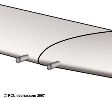

I believe these are the dowels we're talking about

Ah, I see now. A picture worth a thousand words. The dowels I referred insert into the side of the fuselage to prevent the wing from twisting once is in the wing-tube.

Anti-rotation dowels versus wing retention dowels.
