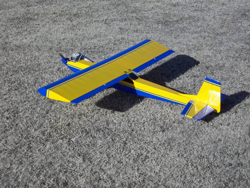

Finally got time to finish it, flew it for fist time yesterday. I have a Supertigre 90 on it, has unlimited vertical, floats like a dream, overall pleased with it. You ever finish yours?

This and the .40 size GP editions are my favorite Trainer series. For folks that don't know, this is a revamped Bridi RCM Trainer that sports a fully symmetrical and thick airfoil. It's a big *****cat to fly when set up properly, but it is capable of rip-roaring, snarling performance when fitted with a hot or oversized engine and enlarged control surfaces/throws.
You did a nice job on yours.

Very nice! I haven't gotten to mine yet. Building a Thermal Charger at the moment then a 1/4 Scale Super Cub.

Thanks guys, yeah I went with larger ailerons with a lot of throw on all the surfaces on dual rates. I also have it set up with 2 aileron servos programmed so I can use them as flaperons or spoilerons. With flaps down it hovers in a 10 mph headwind. I think its gonna be a keeper!
