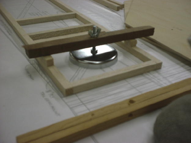

I think you will find that SOME SORT of holding method is IMPORTANT. Before my new table, I simply used masking tape and/or weights. Measured and checked eveything 4 times before applying glue. My new table allows the use of magnets in a bit diiferent way....see attached picture.
As long as the table you are building on is TRUE, your parts will be too.

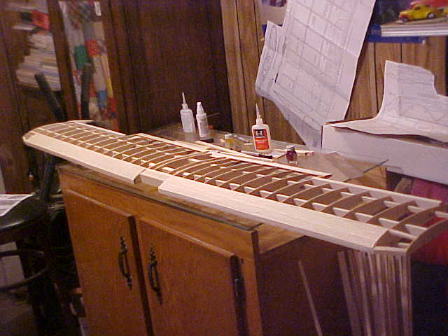

this is my first wing in 7 years, no pins at all. Mostly built on a glass table for true flat surface but a lot of it was in mt chair watching T.V. and it seems to be very straight.

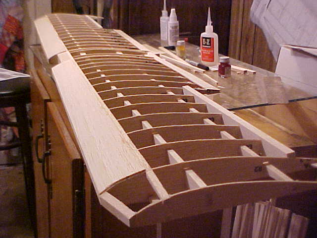

lots of slop in this kit (SIG Citabria) as you can see in the gaps at the spar and the same thing with sheet balsa over ribs but the wing still came out straight so far.
Can be done but you must be pretty sure of your building ability.
