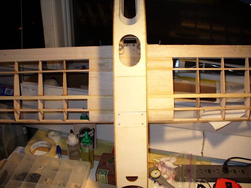

N1EDM, the Midstar wing is fully symetrical. That's why I chose it over the 4 star, when trying to decide between the two. I honestly liked the looks of the 4 star better. But I figured that the Midstar might be a touch more fun to fly.
Sorry Alex, hope I'm not hijacking either. The Midstar gets me going. Can't wait to see how your's comes out.

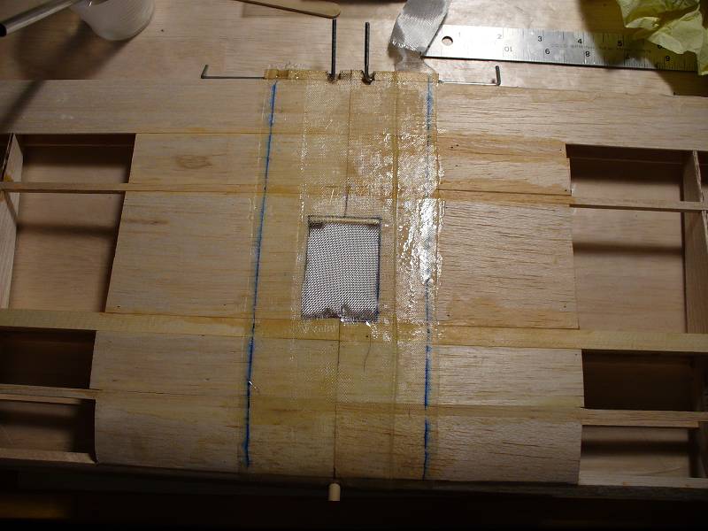

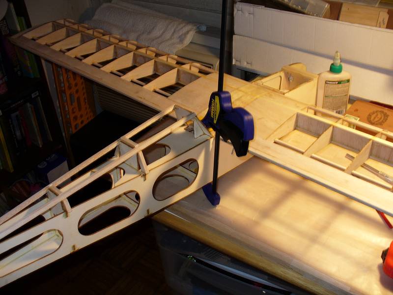

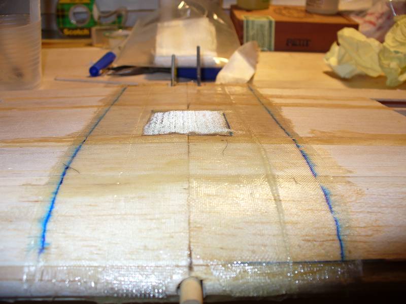

Just glued the wing joint fiberglass strip, 2” fiberglass medium weave to the center and 1” fine weave for the outer boundary, this way when the wing will be sitting on the fuse there wont be any pressure points against the balsa.
Then run the heat gun on it to spread it evenly and to thin it.

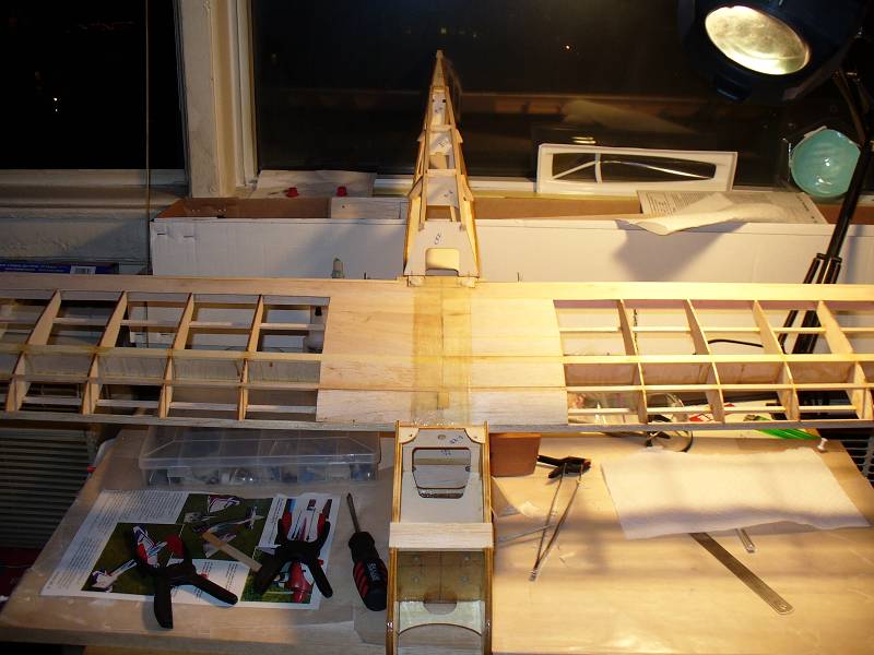

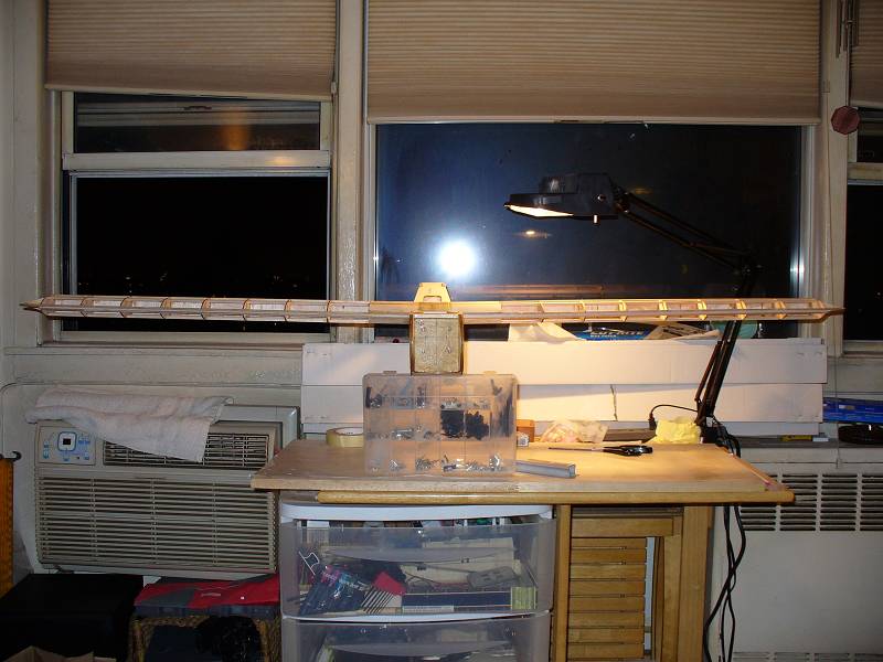

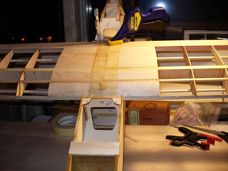

I was adjusting my wing to the fuse, apparently sanding the wing dwells to angle was not such a good idea, it was better to leave them straight and then sand them.
30 min of sanding epoxy and fiberglass to fit it.

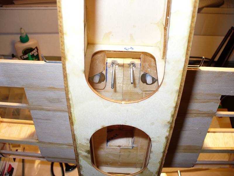

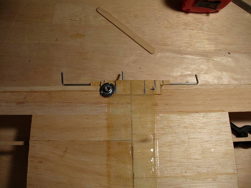

I’m planning to use ¼-20 blind nuts to hold the wing to the fuse instead drilling and taping as suggested in the manual.
So I marked the holes for the screws with a thin drill bit thru the wing and dwells is sitting on.

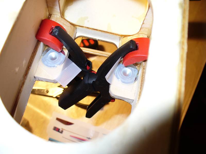

Decided to make a modification to the manual, this time i'll bolt the wing screws into blind nuts and not into threaded wood as the manual suggested.
Thread in wood will disappear with use.
I also glued the dwells to the fuse using 30 min epoxy and not med CA as in instructions suggested.

The nuts sitting right and supporting the wing tightly and evenly 38“ to wing tips.
Held tight and accept the wing balanced.
Not much redoing here.

Looks good the blind nuts are a lot better solution and will hold up better and be replaced if needed. Did you check out the square of the wing to the tail?

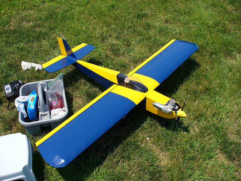

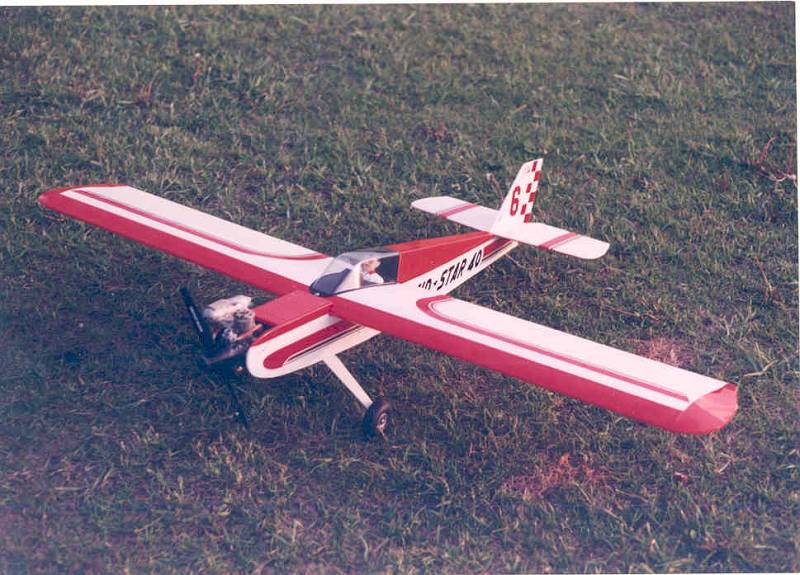

Hey Bob, I had a MidStar back in the early 90's and loved every minute of flying.
Basically built it stock, taildragger (reinforce the bottom of the rudder with lite doublers each side to
prevent the gear piano wire from damaging the balsa), I tapped the wing bolts in the wood part and
used CA to harden the threads and they never weared out. I'm posting a few pics (sorry for the bad
resolution they were scanned from old prints) too bad you can't see the checkerboard underside!
Have a ball with your midstar!
