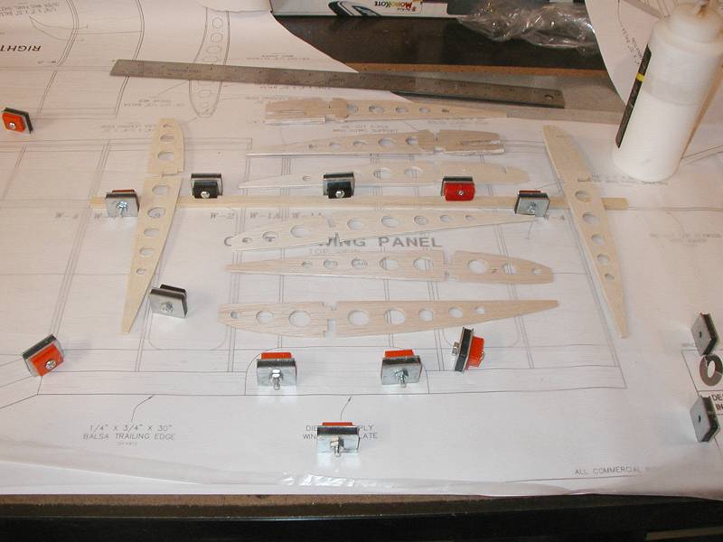

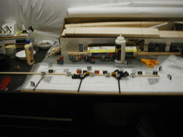

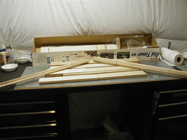

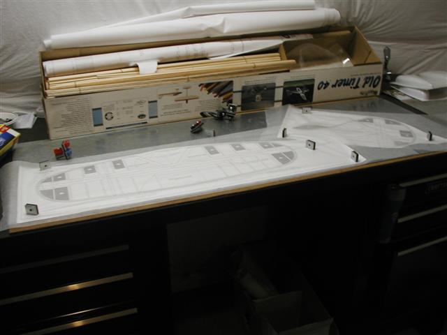

Hi,
I thought I would share my build log of my winter project. This will be a slow build, so please bear with me. I bought this kit off eBay about a year ago. I really like 30’s style planes and this seem to foot the bill. The kit is no longer available and what information I found is very little. It is supposed to be a good slow flying airplane. This is what I wanted for those lazy days of summer out at the field, which is something I can putter around the sky with. Engine most likely will be a Satio 56 Four-Stroke. As for covering, I’m going to use one of the iron-on fabric coverings with Karolyn paint. The pictures below are from opening the kit to the beginning of the build sequence on the tail. The neat thing about the tail group is it uses built up laminates for the edges. I'm using PICA Glue-it to build the laminates so it will be easier to sand. Once the tail group is done the rest of plane should go by really quick. So, enjoy the build and please post your questions and comments.
Dave

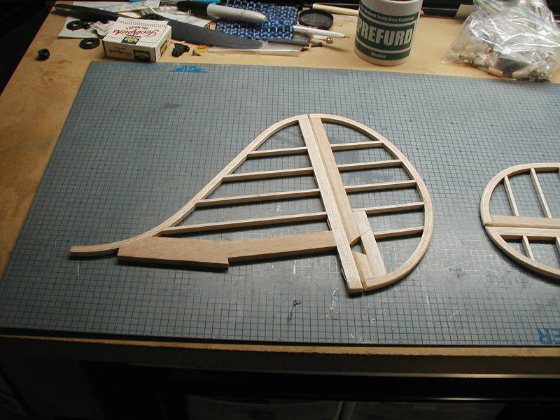

Default RE: Old Timer 40 Build Along

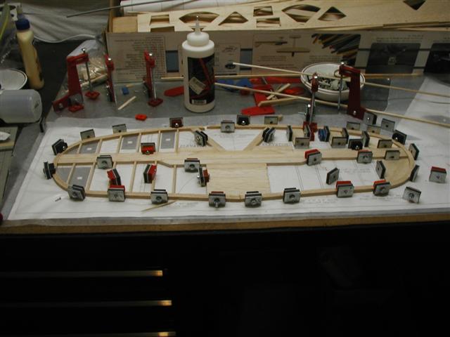

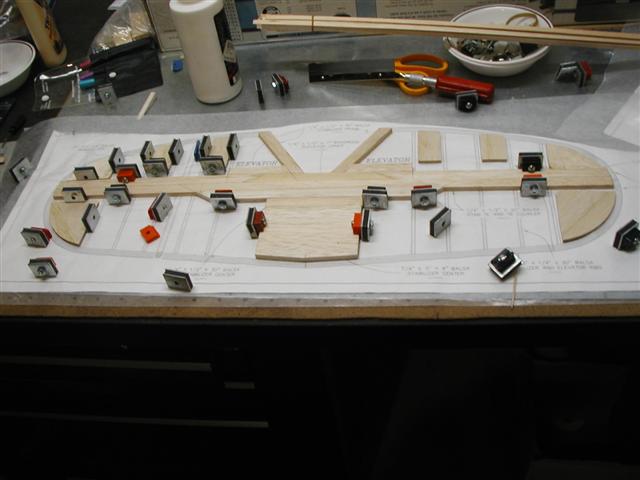

I know it has been awhile, but here is an update. The first picture contains the basic skeleton of the elevator and stab ready to receive the laminated leading and trailing edges. Unfortunately, I don't have enough magnets to do both sides at once on my magnetic board. So, I will bend then glue one side and repeat for the other side. In the instructions it was stated to bend the laminated edges use warm soapy water. Instead I used a mixture of ammonia and water. It help clears the nostrils at the same time. The second picture is the left side drying out. I will leave it dry overnight and glue it tomorrow. I will start on the rudder tomorrow. Finally, not much will happen until after the Thanksgiving holiday. So, have a good Turkey day. If you have any questions let me know.

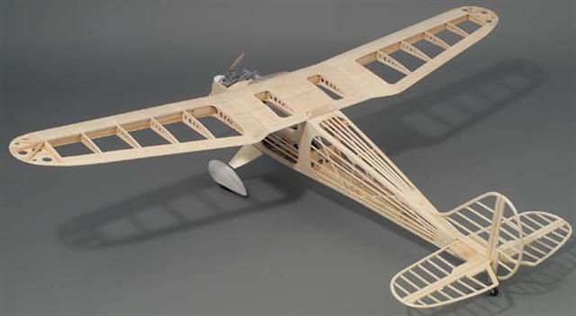

Last night as I review my posted I realized maybe some people are not familar with this plane. The two pictures below and the specs from Great Planes web site.
First the Specs....
Wingspan: 73 in (1855 mm)
Wing Area: 735 in² (47 dm²)
Weight: 5-6 lbs (2.2-2.7kg)
Wing Loading: 15.7-18.8 oz/ft² (48-57 g/dm²)
Length: 55 in (1400 mm)
Requires: 2-stroke .32-.40 cu in (5.0-6.5 cc) or 4-stroke .40-.52 cu in (6.5-8.5 cc) engine, 3-channel radio w/3 standard servos, wheels, wheel collars, spinner, fuel tank, 4+ rolls of Top Flite® MonoKote® covering
Now the pictures...

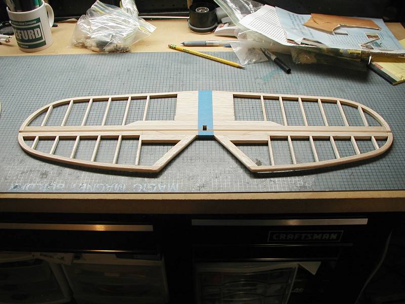

Had a problem with the camera and lost a few pictures. But, here is what I have done. The first picture is the left side with the ribs installed. The second picture is the whole stab and elevator. I finished installing the right side ribs before MNF. I will pull the stab and elevator off the building board tomorrow. If all goes well I should be able to start the rudder and fin while I finishing up the stab and elevator. Finally, thanks for the comments and suggestions.
