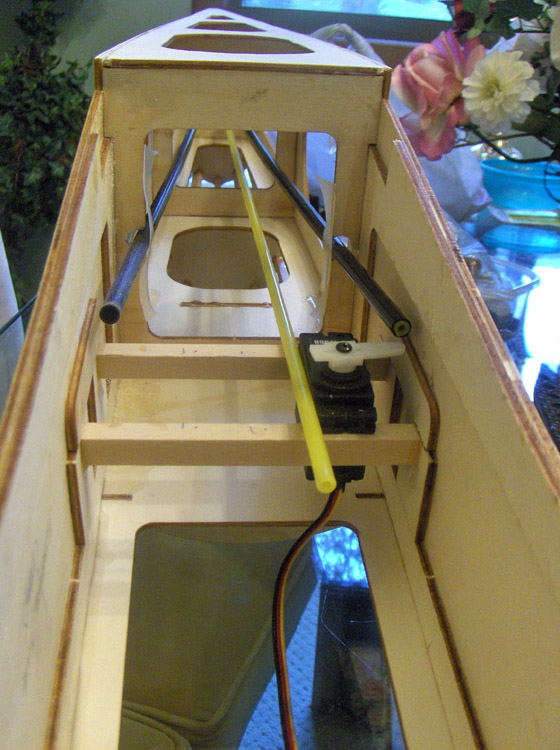

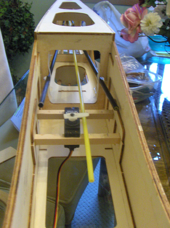

Hi Guys,
I wanted some experienced advice on servo placement on a Four Star 120.
I will install a separate "rack" for the throttle servo, towards the nose of the plane. And I guess I need an extra servo for cut off on the engine?... ( Don't I?)
I think I'm okay there cause I need to be 12" back from the engine and I've got 13 or 14 inches to work with. (a BCMA 26cc gas).
I'm waiting to receive most of the hardware I'm going to need from Tower Hobbies in the mail, sorry I only had 1 spare servo for the pics.
I know s/one will ask me what servos I'm using so I may as well tell you now. I also ordered 4-40 size hardware, and heavy duty kwik links & hinges, control horns etc.
I'm kinda guessing at some of what I need, but I think I got it covered.

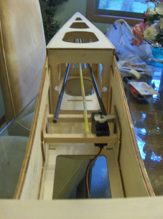

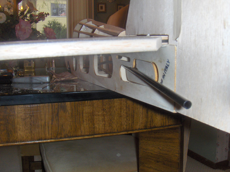

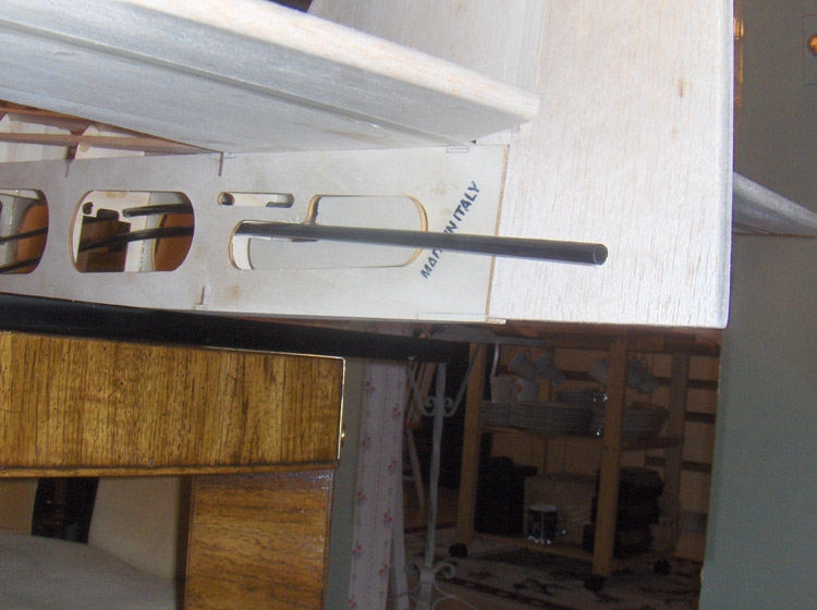

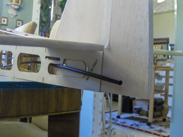

In the pics: I want to use the two outside servos for th elevator & the one in the center for Rudder.
I drilled holes to give myself a straight line already through the fuse, and carved out one of the Kit cutouts to feed the pushrod through the side.
Is it okay to mount my servo horn this low on the rudder? I could go a little higher w/ a little more work.

dont mount them that way, your push rods are to long, way to long, mount your servos on the fuse to the back, wear the cut outs are fill them in and mount everything there
They don't look too long to me... I've never had a problem with long pushrods as long as the outer tube is glued to the formers and/or supported as much as possible down the length of the fuse so they don't flex under pressure. Pull-pull would be even better, easiest to do just the rudder as pull-pull though.
I agree about 2 elevator servos... Unless you think you'll need both of them, one with a split connection to two pushrods would work nicely. You can build your own (download the GP super skybolt manual, there's a technique laid out in there) or buy one: http://www3.towerhobbies.com/cgi-bin...?&I=LXBWL8&P=7

Thanks guys,
Yes I plan to support the tubes at each former w/ a small brace w/ holes drilled to feed it through & epoxied at each .
Second, I'm adding an extra servo to the elevator because I plan to increase the size and shape of the Rudder & Elevators. (Will look like the tail of a Super Sport)
I saw it on another thread here, I wish I could say I thought of it. But this is my first plane kit.
I wouldn't think long push rods would be a problem, ( as long as they're straight, supported etc.) why would they make them 48" long if they didn't work? No offense meant.
Thanks for the tip on the L/gear too. I may buy a leaf-spring tail wheel assembly. So the gear would be mounted into the fuse,....right ? with T-nuts I guess. Sound good?
