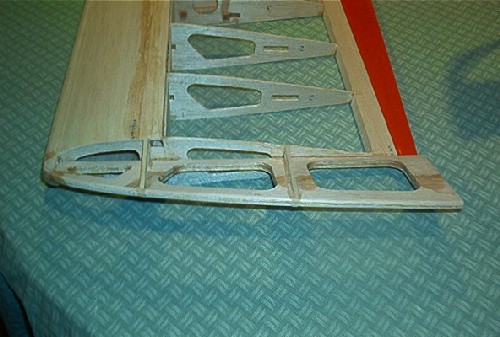

What would be the best way to cover the optional wing tips on a TF Contender?
I want the tips to be red and the body of the wing white.
1. Would it be best to cover the entire wing including the tips in white and then just re-cover the tips with red?
2. Should I cover the tips first and then apply the white just up to the angle on the dangle?
3. Or wing first followed by the tips?
I have included some pictures of where I am at for your ideas.
Thanks in advance,
AL

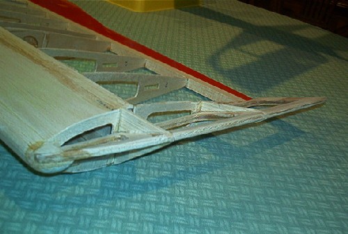

Another view.
AL

Old 04-08-2003 | 12:34 AM
Posts: 100
From: Menominee, MI
Default Covering TF Contender Wing Tips
Al
If I was to cover that wing, I would first add a capstrip to the
last rib, then I would cover the wing tip first including the
capstrip, then I would cover the rest of the wing, and over lap the covering on the capstrip, you will want at least 1/4" of
over lap or more for your covering to stick to.
Good luck
Ralph V.

Al,
You sure are handy to have around. I am following in your footsteps - letting you find all the traps on the trail. I only have the rudder (orange) and the vertical stabalizer (black) covered as yet. Tonight I'm adding black horizontal stripes to the rudder.
The manual says bottom of wingtip, then top, same for other side, then bottom of [entire] wing, then each half of the top. The wingtip is not the problem as I see it - you can fold the covering down and fasten it to the inside of the outer rib for lots of grab. It's the wing covering butted up to it that worries me. I Balsarited the wing tips and edges of all of the ribs, hoping it will give extra hold. There shouldn't be much stress on the edge of the film, but I am concerned that it may pull away from the tip as it shrinks. Hopefully, the 1/4" overlap will be sufficient. I'm doing black tips and yellow wing on the top, both orange on the bottom. Should be visible, no?

Depending upon how the covering material you're using will stick to itself, you should have no problems doing the tip first, and then the rest of the wing.
The usual patter of "bottom, then top" should be followed. This allows the seams at the leading and trailing edges to be less visible to the eye.
Use the end rib's inner surface to give you some extra surface to enable you to get a good stretch on the covering when you apply it.
Contenders have had upswept wingtips in Central Illinois since the 70's, with many, many of them covered in MonoKote. Of course, that's what we use on our models!

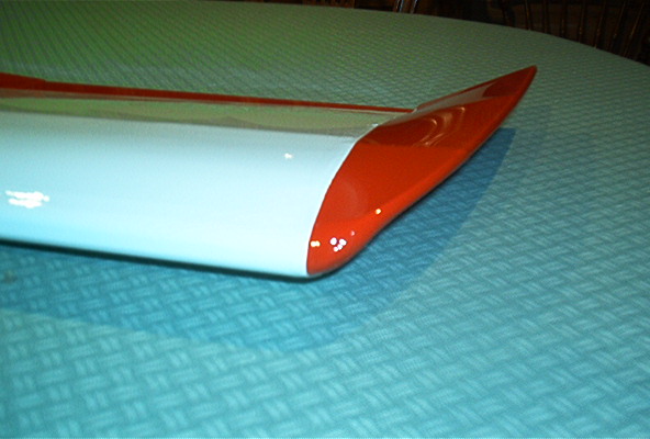

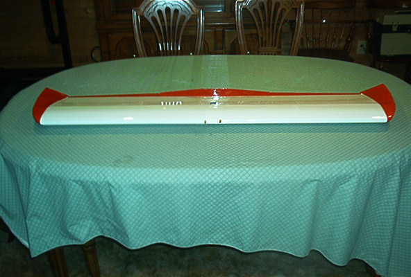

Everything worked out pretty well. I just took my time and pulled and pulled some more. I will add a black stripe to the leading edge to simulate de-iceing gear. So far I am pretty happy with everthing. Here are a couple of pics.
AL

Here is another one of just the tip.
AL
