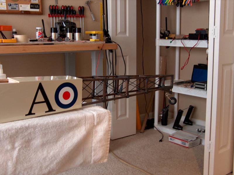

I am in the final assembly stage of building my Elder. To those of you who have completed the build, what did you use for the cross bracing on the rear fuselage? I am reluctant to go with the elastic cord because it will probably suck up the oil from the exhaust.

I have been using elastic cord and not having any problems with oil etc.
Jim R

Default RE: Building a TOP FLITE ELDER
Jim,
And how did you attach the cord at the corners ... CA + kicker?
I put a piece of plastic 1/8 inch wide small tubing in each corner to run the cord thru and hit it with CA + Kicker
Jim R
ORIGINAL: Intruder38
Jim,
I'm presently rigging the fuselage. I used elastic thread but I drilled a 1/16th hole in the frame. Locked down by jamming a round toothpick in the hole then a drop of thin CA. I used the toothpick method just to counter any possible loss of strength in the frame.
