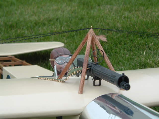

Old 01-02-2008 | 12:39 PM
Don41's Avatar
Joined: Sep 2006
Posts: 581
From: El Dorado, CA
Default RE: Building a TOP FLITE ELDER
The Williams Bros accessories are sold by Sig Manufacturing. I bought the Parabellum machine gun (1/6 scale) WBR16300. It comes with an ammo belt. I chose the 1/6 scale pilot WBR17600. Keep in mind you'll need plastic glue and a selection of paint (I ordered Testors enamel from Tower Hobbies).
Just looking at the dimensions I was a little leery of the TopFlite wire wheel's 4" diameter however when placed on the fuselage they look fine. They are a little heavy but I doubt they'll be too heavy.
I'm mounting my Saito 56 with stock muffler.
I used the recommended Monokote color but it has been a little uncooperative while trying to place it on the wingtip. It has been a humbling experience (:-). If you go with the standard color scheme I found the Monokote self adhesive trim colors work well on the rudder.
I varied from the recommended construction in a few places but even though I meant to take pictures I always seemed to forget so I can't post picts. Sorry.
I would recommend using wet 1/16th sheets of skin on the nose. Two layers laminated with wood glue worked well and were easier to shape to the compound curves.
Don't add the gussets to the top rear fuselage where the stab is attached otherwise you will have to relieve the stab in order to fit flush to the fuselage.
As suggested by someone else, mount the engine so you have room to add soft balsa to the tip of the nose. This will allow you to create a rounded look. Not too rounded though or you may have trouble adding the chrome Monokote trim.
More than you asked for but you touched my gabby bug (:-).

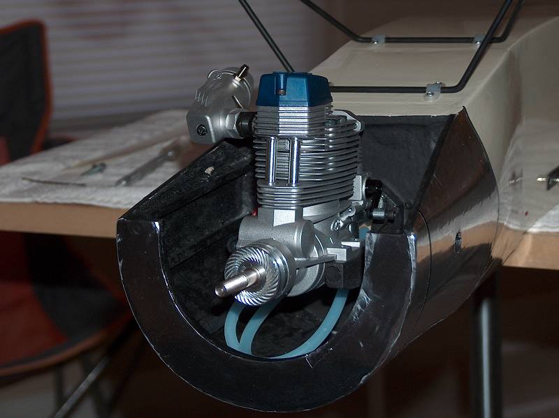

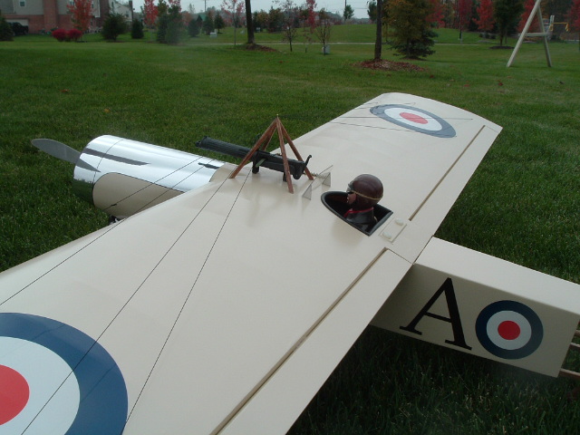

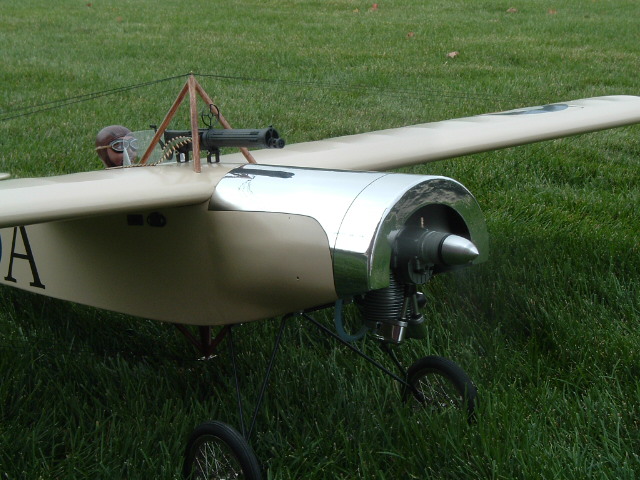

FlyingPilgrim's Avatar
My Feedback: (26)
Posts: 1,504
From: Canton, MI
Here's some pics of mine.

Very nice Pilgrim. I really wish I had not gotten in a hurry and painted my exposed structure black (didn't have brown that day). At this point I can't decide whether to try adding brown over the black (assuming I can find some) or just leave it as is.
Old 01-09-2008 | 06:08 PM
My Feedback: (26)
Posts: 1,504
From: Canton, MI
I ended up staining my exposed wood with Minwax stain, then clear polyurathane over it. The oil content of the stain cause minor problem with the epoxy bonding the wood pieces (I stained all parts first, then assembled to avoid clear glue joints). I would think painting brown over the black paint should yield good results, you could even simulate added wood grain using a dry-brush technique, giving some contrast to the color.

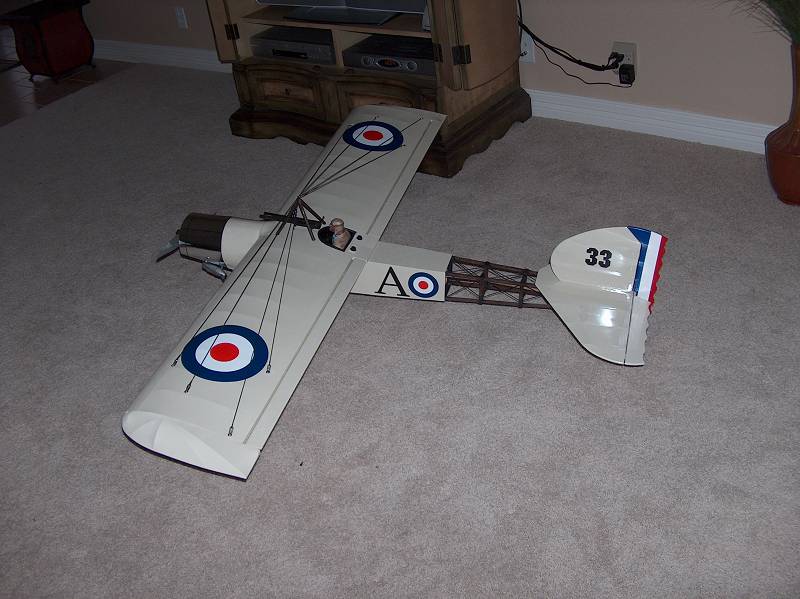

jdr43's Avatar
Joined: Jan 2006
Posts: 75
From: BELLA VISTA, AR
Here are is a pic of mine, have not had a chance to fly it yet.
Jim R
Old 03-07-2008 | 04:04 PM
My Feedback: (26)
Posts: 1,504
From: Canton, MI
Nice job, Jim. Did you use the tail wheel or the skid? I used the music wire skid on mine, and found ground handling a challenge. Once in the air, it's just like a trainer, and looks great on those low fly-bys. Hope you enjoy yours.

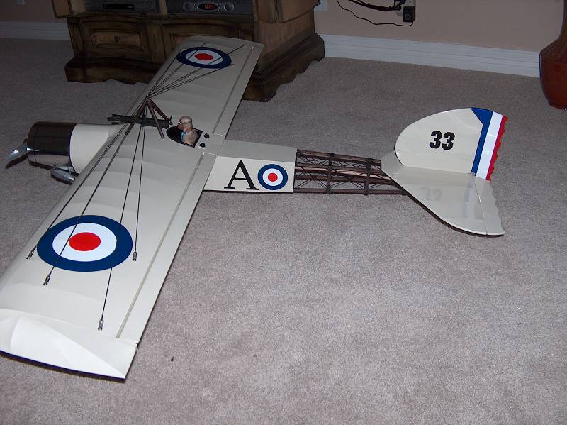

jdr43's Avatar
Joined: Jan 2006
Posts: 75
Hi pilgram, I fly off a grass field and installed a Sullivan Tail Wheel on my Elder
My Feedback: (26)
Posts: 1,504
From: Canton, MI
If anyone is still building this kit, I would suggest the tail wheel. I may even convert mine at some point. I knew before I built it that ground handling would be "interesting", but was surprised at just how much. On paved runway, it is difficult to limit how much it swings on the skid, even by giving short bursts of throttle. On grass, the blades of grass tend to catch and bunch up where the wires of the skid form a "V" shape in back. On one take-off, it wouldn't move. I kept giving it more and more throttle, then BOOM, she launched as the grass blades tore out of the ground. When I landed, there was a clump of grass still there. It does not like to turn while on the grass, either. I think if you wanted a skid, a better design would be a hardwood piece that turns with the rudder, but easiest would be just to use the wheel.
