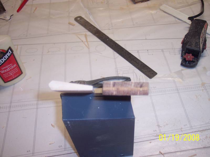

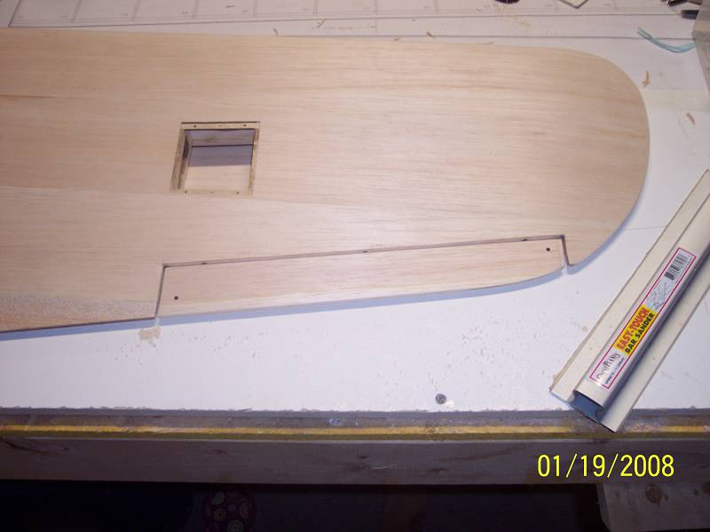

Mike, I did think about using CA hinges for the ailerons, but I'm going to stick with the pin hinges. I definitely will add the stock in the horizontal and vert stabs...if I ever get there! The end of January is just not a good building time for me. That's why I got up at 5:00 am this morning and headed down to the shop, so I could get some work done before we leave at 7:30 for our wrestling conference tourney.
Anyway, I got one of the ailerons done. Really wasn't that much work, and only took me about an hour to get one of them completely shaped and finish sanded. My handy dandy little power plane saved some time. 1st pic shows finished left ail fit in, and 2nd pic shows the finished ail and the blank that you start with. I did end up adding some stock to one end and then reshaping both ends for a better fit. Maybe tonight I'll get the other one finished and the wings joined so I can move on. Maiden flight late March...2010?

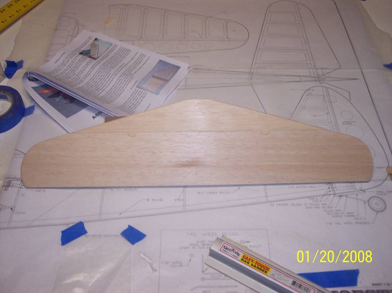

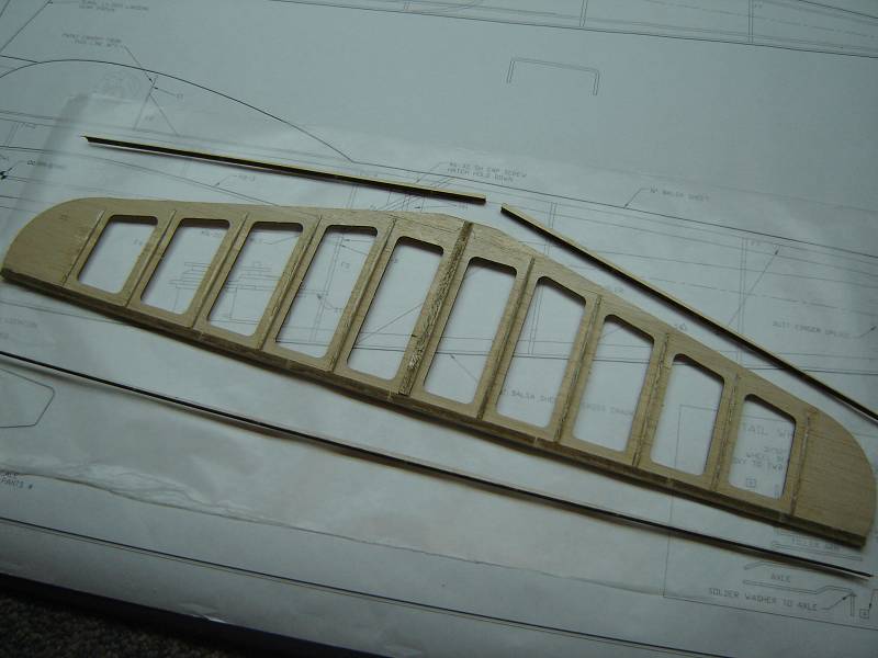

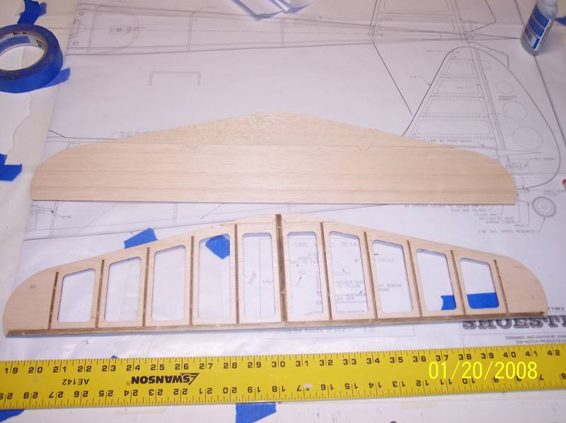

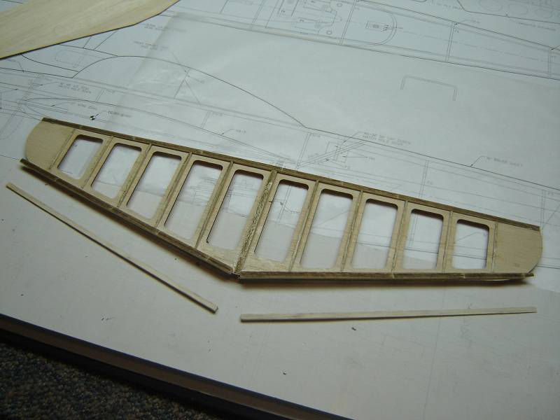

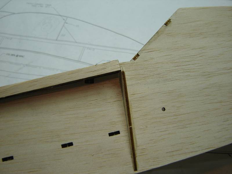

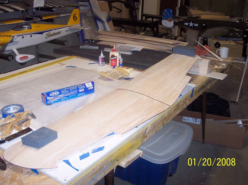

Got back at it this morning. Finished the other aileron and started on the horizontal stab. First pic shows how fine the ribs are (it's a fully airfoiled surface) with my exacto knife for scale. The second picture shows the assembled surface. Mike, here's where you'll either decide to agree or disagree with me.
The horizontal stab, well, I never did find the leading edges. I had to cut out my own to shape. Never did see the labeling on the balsa sheets for those parts. Wasted two evenings looking for them. Weren't [ ] on the parts sheet either.
I've come to conclusion that you're right. They're not there at all. They're not mentioned in the directions, and only reference made is on the plans. I came to the conclusion that it's because there is no leading edge piece to apply. The way the ribs taper down to nothing at the LE, short of the elevator core LE (pic 2) was my first clue. I dry fit the whole thing up and looked at closely, and finally just glued it. I got so carried away, I almost forgot to add the extra balsa blocks for the CA hinges like you suggested. After I sanded the LE to shape, I'm very pleased with the way it came out, pic 3. I'm quite sure that your's will suffer no adverse effects with a piece installed, but I wanted to point it out and get some impressions.
Last pic is of the assembled wing surface. I epoxied the two halves together and used carbon fiber dowels for alignment pins. I'll also be using a carbon fiber rod for the wing mount dowel. I'm done for the day, and will get the laminated spar joiners installed tomorrow and start on the vert stab.
Did you notice the assembly of the elevators and rudder? More shaping and sanding. I've got a shop-vac full of balsa dust already!

Well Doug, I have to had screwed-up bad. The horizontal stab. It shows a leading edge balsa insert, I made and installed them. Thing is, your install makes a lot more sense. My whole stab looks warped and I'm deciding towards starting over with it from scratch[:@]. It wont take me long but it's still lost time. Let's move on. The fuse siding. I know there's a left and right but one still did not line up. It'll take a little bit of effort and possibly some help to line up and glue as you install. Nose photo show's the gap, I can take care of that. Also, wing saddle doublers are a tad short, look what I did to re-inforce. I want that stab to be right so I'll spend the time to do it. Seeya in a few days. mm PS, The instructions say three firewall bulkheads, the plans show four. Whats with that ?

And yes , there is a medical condition known as "Balsa-Lung" [ LOL] MM PS again, also nice Sundowner and B-25.
