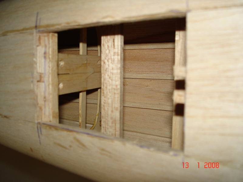

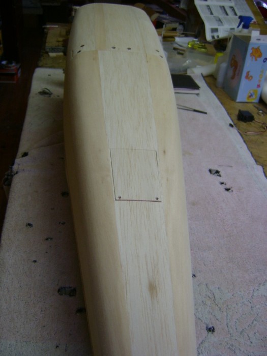

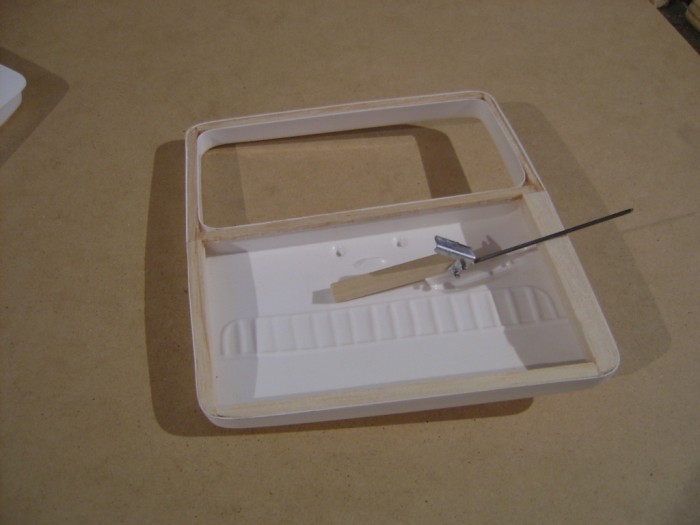

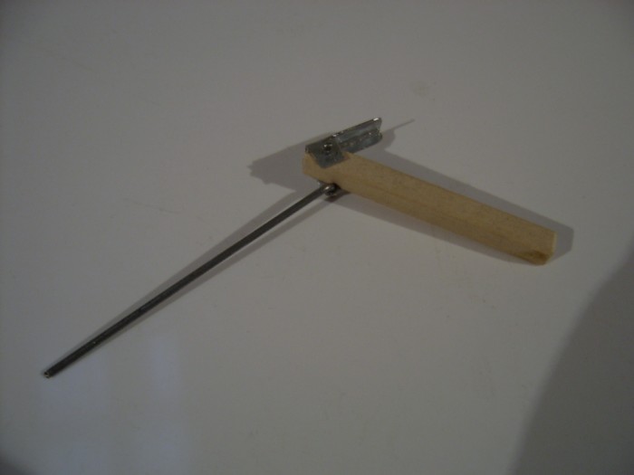

Hi All!
I´m building this TF Cessna from along time... now I want to finish her!
I have a interior set modified for open the doors. To do this, I needed to move the elevator and rudder servos backward, behind rear window. This is what I made today...
Sorry about my english...

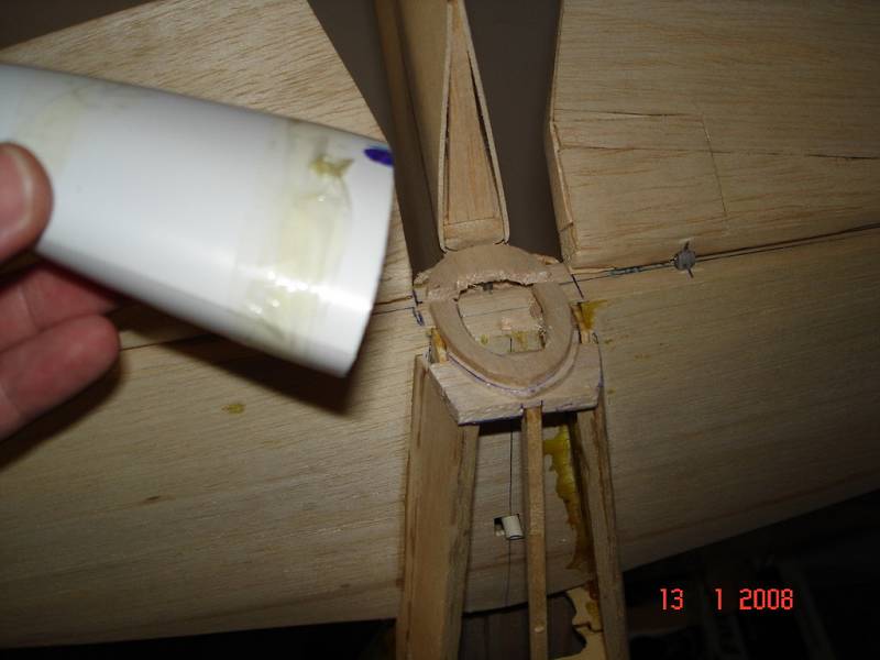

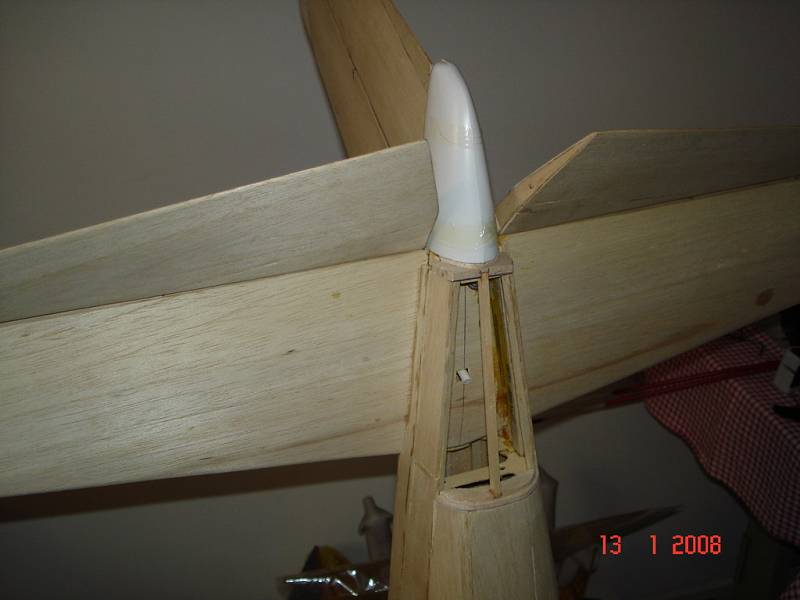

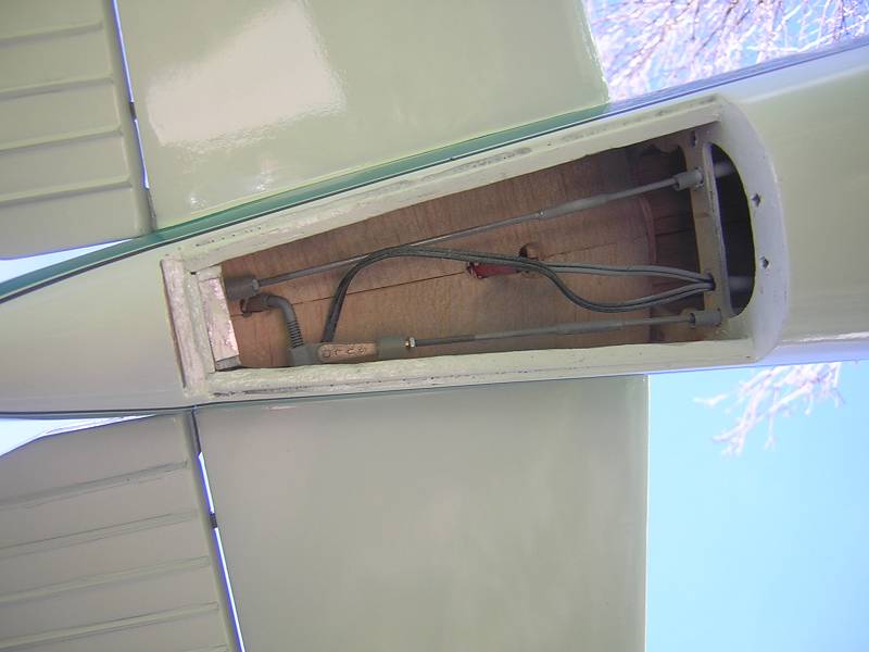

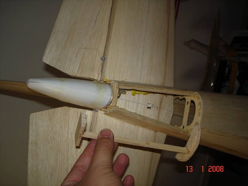

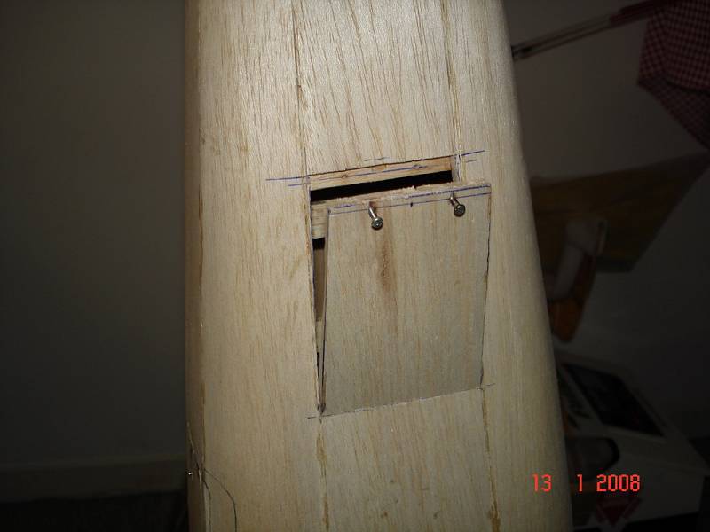

I made a removable tail door, to service the elevator and rudder linkages...

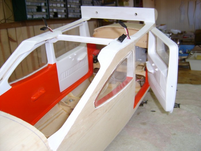

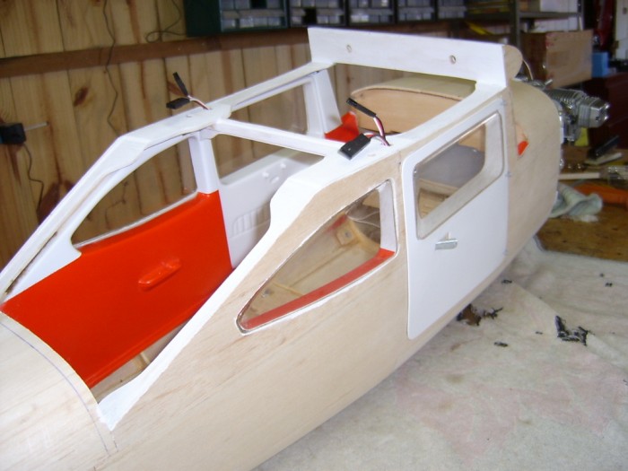

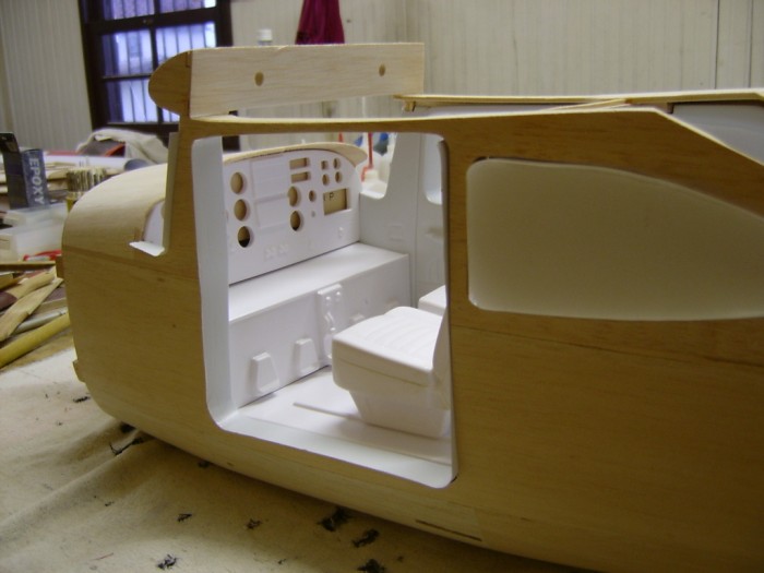

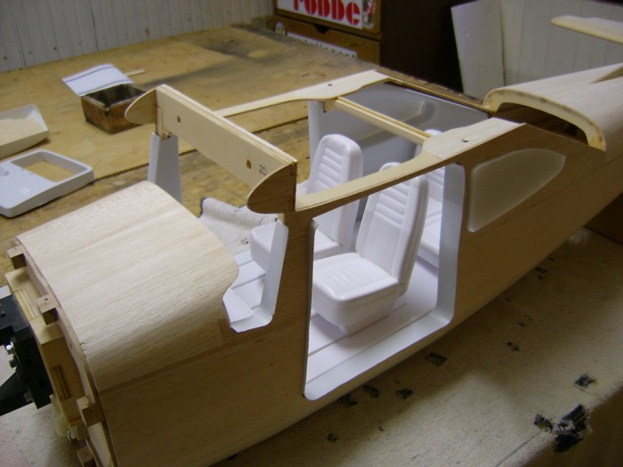

These pics are from a friend that modified the interior and sell me...

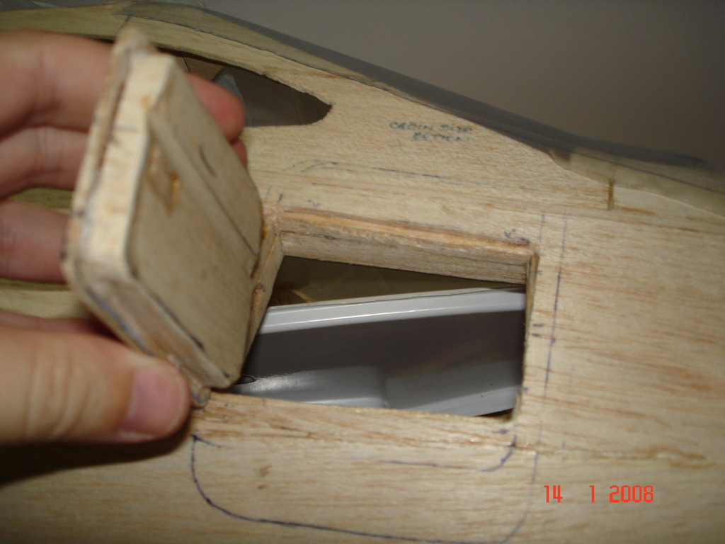

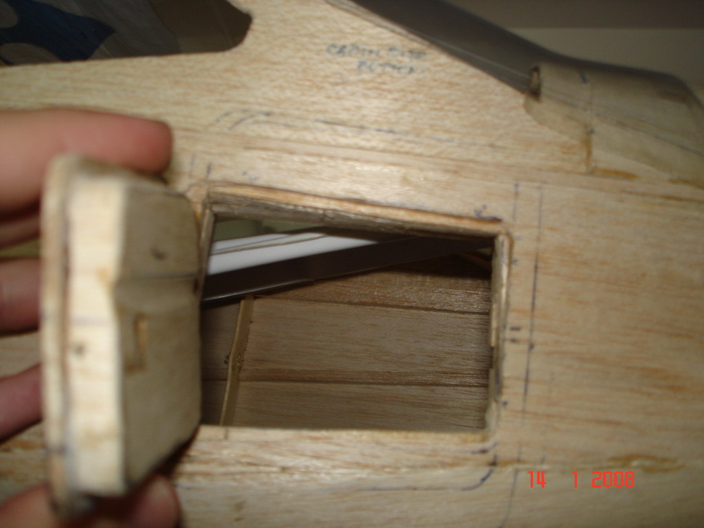

Hi all!!

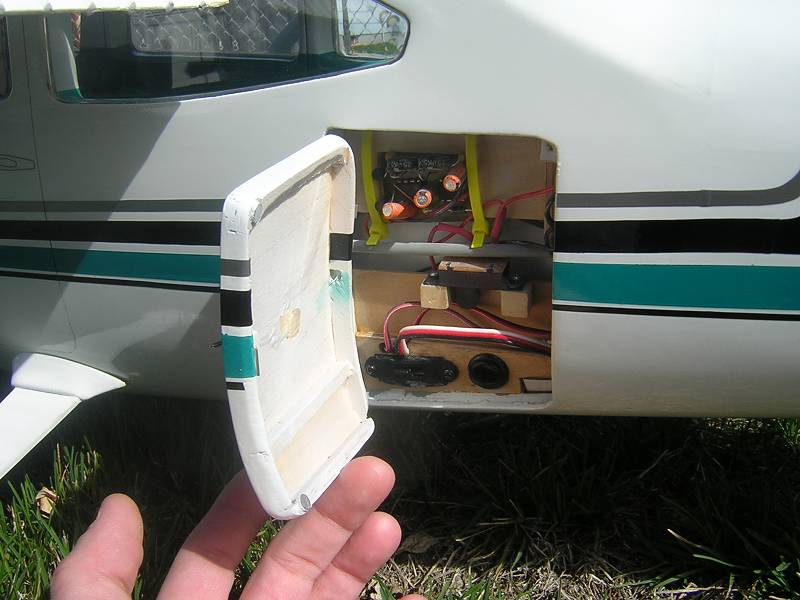

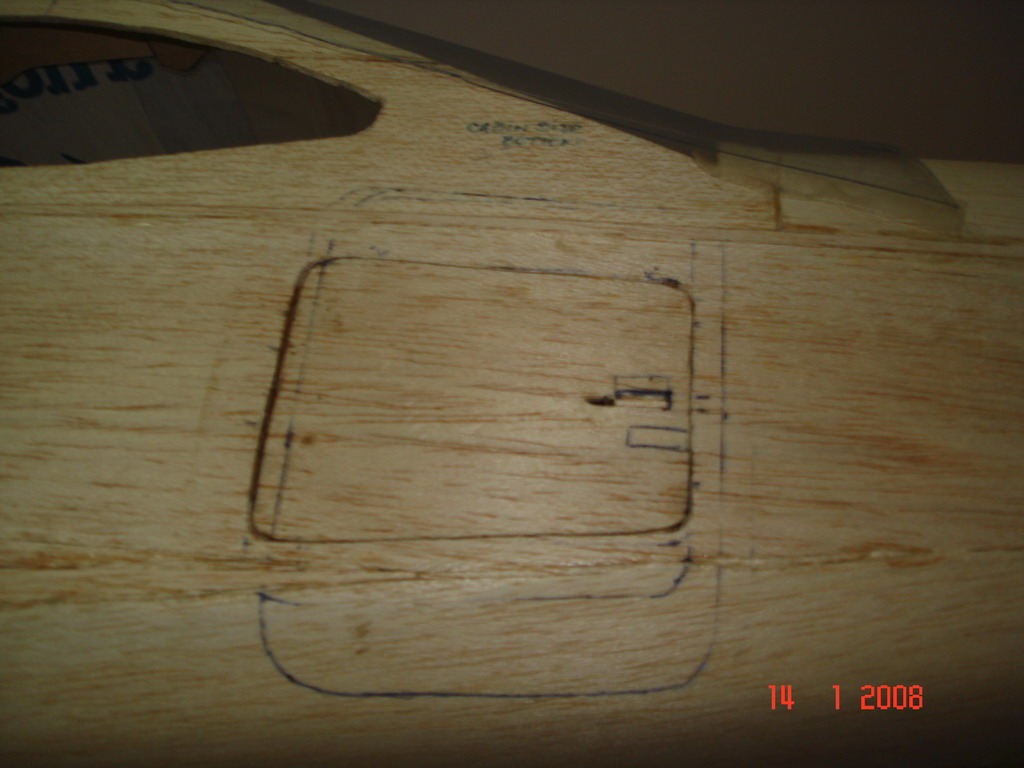

Here are some pictures of luggage hatch that I made to hide the switchs, recharge jacks...
Cheers,
Andre.

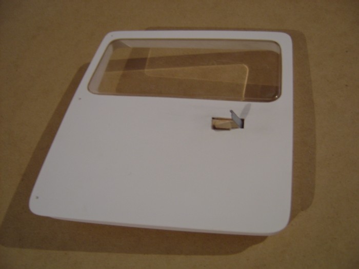

Here are some pictures of door handles...
Andre.

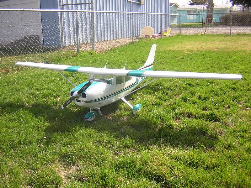

Very nice! If SDCrashmaster finds this thread, he might be able to point you in the right direction for scale door hinges. I too made a removable tail hatch, and built in a scale luggage door to hide my switches, charge jacks, and fueler.

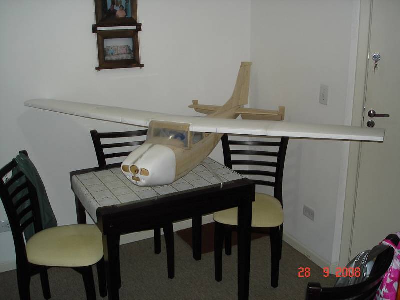

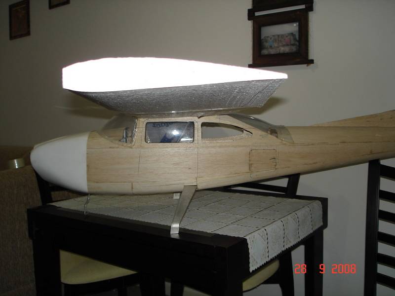

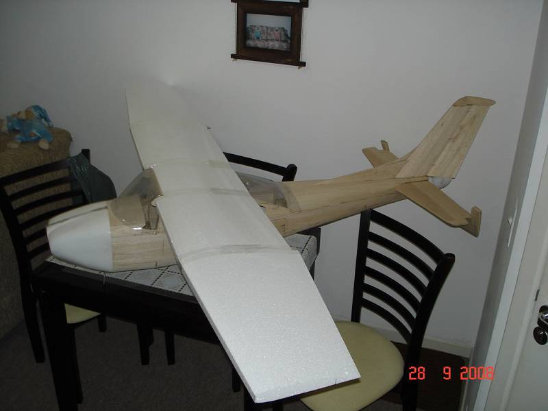

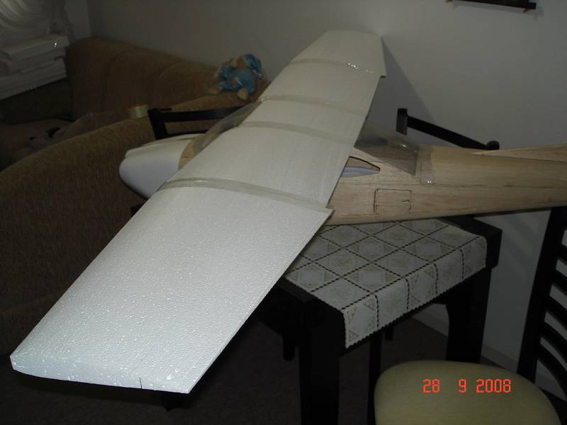

Yesterday I finished to cut the Cessna´s wing on foam... It have 5 parts, and the 2 tips will be joined to the main wing using a aluminum tube...
The wing tips have the required washout...
Here is some pictures...
Cheers,
Andre.
