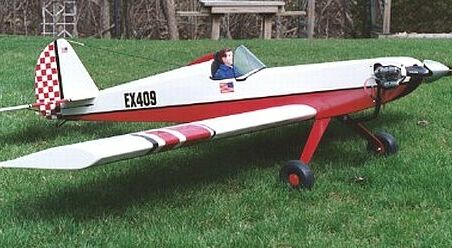

Hello, I wanted a different look to my 4* 120 and so I did a few things that you see here. I used the back 1/3 of the canopy and made a windshield. I added a carved headrest, I rounded the tail feathers, I got a LG from TnT that is thicker and 1" taller and put on light Cub wheels. The tail wheel is a CB/T unit. The real job, (don't think I'll do it again), was designing and building the side mounted Saito 150 in a "cowl , of sorts". I cut off the right cheek, cut it out for the cylinder, and made a top cowl section that is mounted to the motor mount beam and is removable.
This was only my second kit and I really liked the Sig laser cut parts. (I don't like the folded plans!!) My nose art, added after this photo was taken, says, "Sweet Thing". I sure hope that it flies like her name!!!........lownslo...

Your plane looks great, I built mine stock as was my 2nd kit, and used RCS140 for power. Hope to see you and the 4* at the INTERNET fly in this year.

I was wondering the other day if you had finished your 120 build yet. Hope it flys as well as it looks.
I have yet to get my 4*60 up. Started breaking in the saito91 last week, we were going to give it it's maiden last Friday, and ended up finding a way to kink the cable to the throttle. Never did like that cable any way. Put in a gold-n-rod connected to one of the 4 stroke throttle kits, and I really like this set up. Took it back out Sunday, we did a pre-flight, hooked up the fuel line to fill the tank and ended up with a leak in the fill hose right under the engine , took it back home and moved that out of the way. It is now ready to fly, just need to wait for a chance, hopefully this weekend, if the weather will cooperate.

I did my 4*60 much the same way... I cut the canopy back so I could have a widnshield with an open cockpit and use a "Marvin the Martian" for a pilot figure. Powrered by a TT91 four-stroke mounted horizontal with an cap/extra-like cowl from Stan's Fiberglas. Taller and heavier landing gear from TnT since I fly from a rough-ish field.
