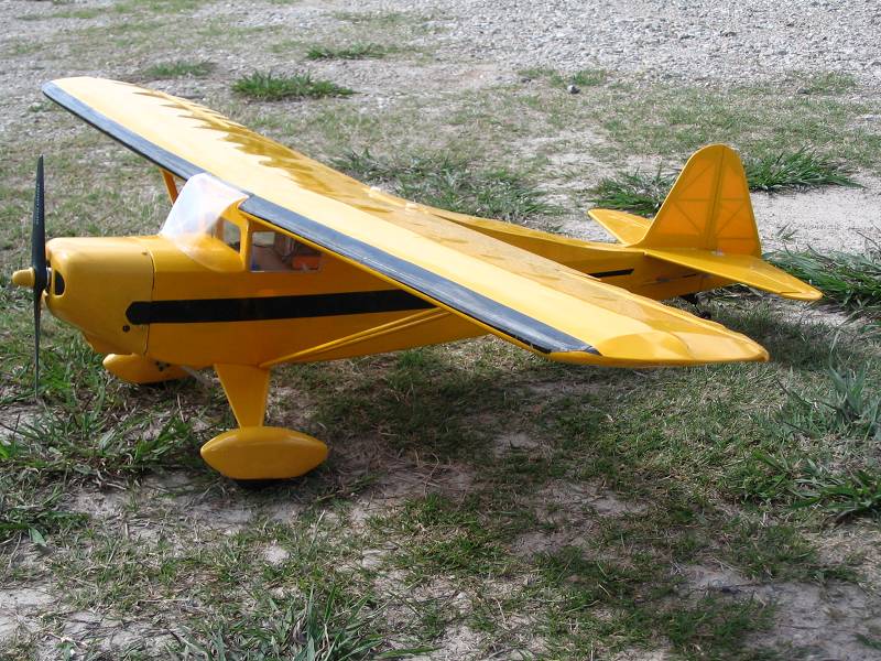

Default RE: GP T-Craft
Here is mine. Coverd to match the H9 version.
Edit: Powered by a .40 LA and flies great. 20 minute flights with the standard tank. Flies at 1/4 throttle.
