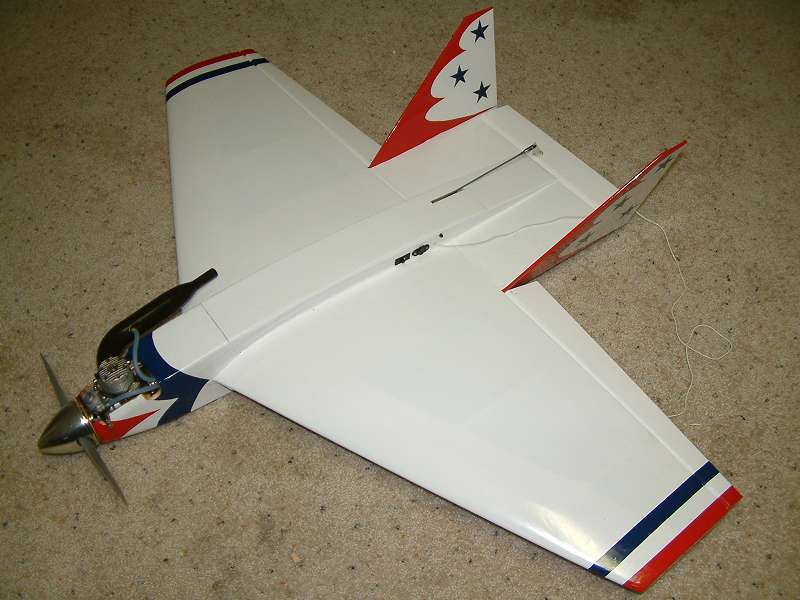

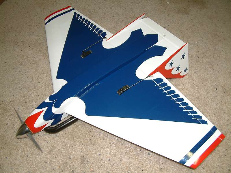

On this Goldberg Extra 300 I used both of the listed methods for joining the seams.
For the bottom of the wing I laid up the white first, then applied the red, then the blue (which had not been applied yet when I took the photo, but is now covering the center section). The seams are all on ribs or sheeting so there is solid backing for each seam.
For the wing top design I cut out my patterns and joined them on glass, then applied the covering to the wing. I did it this way because some seams cross open bays in the wing, with no support. For joining the seams I used trim solvent.
Here is the wing sitting in the un-covered fuse.
And one from the rear. Here you can see the printout (8 1/2 X 11) of what the top pattern will look like when finished.
I guess the point is match the method with the situation.

R1,
I am flattered that you would want to emulate the color scheme. Of course, please do, the only condition being that we all want to see it when you are done.
This aircraft flies soooo nice, I am very impressed with it so far. The Goldberg kit has to be one of the nicest out there.
As far as trim solvent, I had never used it before this project. I just laid out my pattern templates, cut them out marking each one red white or blue so I did not mix them up later. I cut both left and right pieces at the same time, by laying the Monocote face-to-face (so I ended up with exact mirror images) and putting the pattern on top. Then I cut them at the same time with a hobby knife and new #11 blades. I allowed for an approximate 1/4" overlap of the dark color over the white along the seams.
I peeled the backing off the Monocote, layed out the pattern on the back of an old mirror (perfectly flat) and used Scotch tape to tape them together at the "top". I did spray a fine mist of water on the glass to keep the Monocote flat. Then I followed the directions on the trim solvent and everything worked out great!
Here are a couple of shots of the finished aircraft. Well, finished except I had not mounted the wheel pants yet.
I am very happy with the aircraft.
I hope this helps.
Will

I use the glass meathod and have great success until I use silver. For some reason it is alot softer and the glue does funny things under heat. It is the only color that I apply after the skin is made up on the glass sheet.
Here is the latest project.
first I laid out the white then blue, then red. Sealed the seams on glass with an iron, put the skin on the wing and then applied the silver to finish.
Here is the underside.
I applied the white first and then I cut (yes I am crazy) 1 1/2" squares and then apply them in a diagonal pattern 5 at a time and everything comes out straight.
Here are a few others I have done recently as well. One is a recover of a SkyVista Arf and the other is an Ultra Sport 40+. Last is one of my first covering jobs years ago on my Shrike. I covered it all in white and added the T-bird on top of the white as well as all the other graphics. I do love red white and blue!
Jason
Jason
