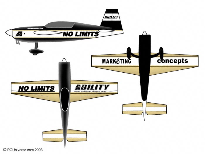

I'll post pics in about a week of the real thing, but for now, here's what I'm doing.

MinnFlier, I notice there is very little difference between the upper and lower wing, won't it be difficult to determine the orientation of the plane in flight?
I question this, as I wanted to make my upper and lower wing black and white but feel that perhaps there should be some difference between the two. I used to fly alot when I was younger, and am just getting back into the hobby with my son. I am sure he will see the plane fine, but my eyes are not what they used to be
Yes, they SHOULD be different in most cases. I was pointing out the fact that, (like CafeenMan said) I know which way my plane is going, because I put it there.
Most of my planes are not "Self Correcting" they go where I point them, and I have been flying long enough to be constantly aware of what attitude my plane is in because I know where I pointed it so to speak.
This color scheme is not good practice, and I would strongly discourage a novice from using anything similar, but this is going to be a "Mascot" type show plane, and after months of working on variations of my regular scheme, (which is highly visible) I decided to throw caution to the wind and go with this design simply because it worked well with the theme.

On scheme to avoid is the up-down checkerboard.
By that I mean let's say you decide to make one wing Blue and the other Wing yellow. Very easy to see right? Well, don't make the bottom of the blue wing yellow and vice versa. if you do that you won't know which side is up. Yes, a plane can be inverted and other than the fact it's diving for the ground, it can be hard to tell at even a moderate distance.
For a trainer, all that glinty stuff and stripes don't really help much. I recommend you make one wing a darker color and the other wing a lite color - same color top and bottom.
Problem with stripes and such all over the wings is that it looks like it should be visible but it usually all blends together in the air.
Hope all that made sense. If not just say so and I'll try to explain it better.
