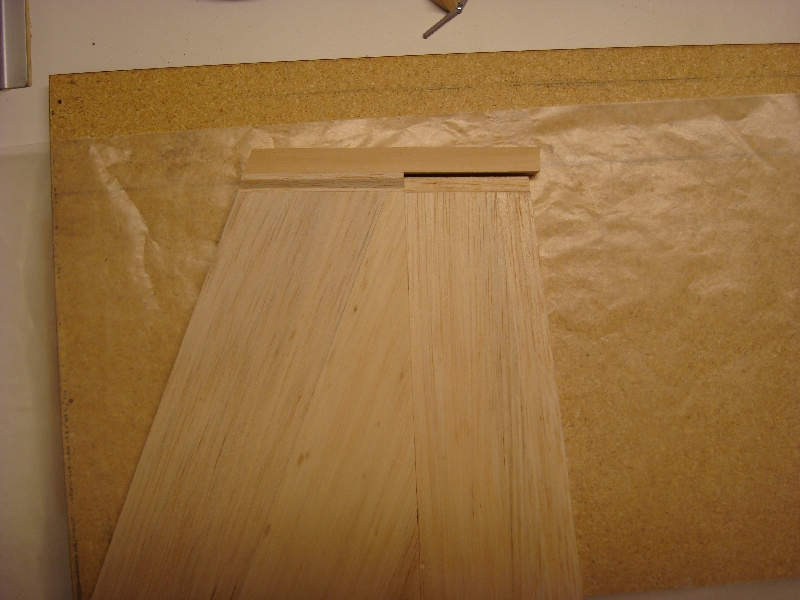

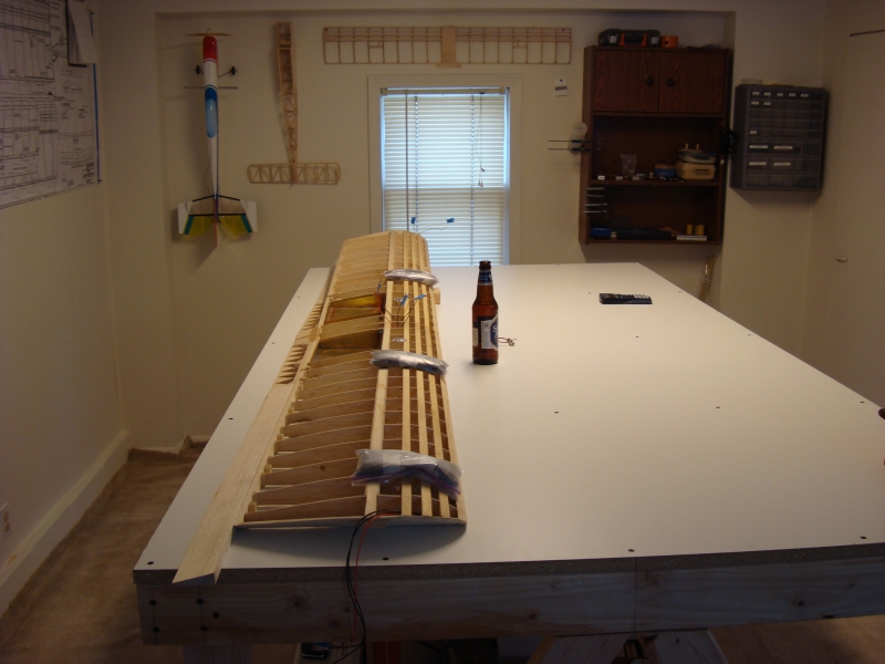

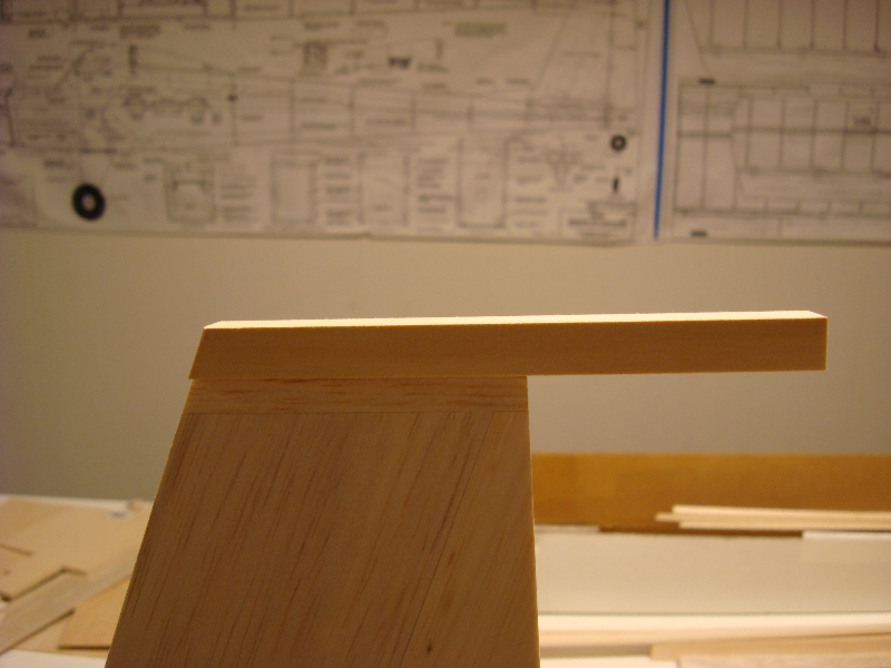

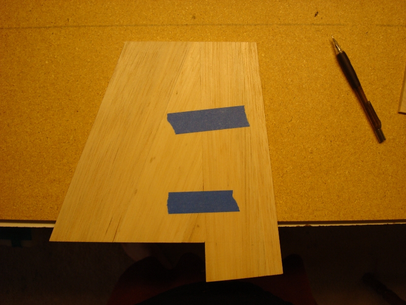

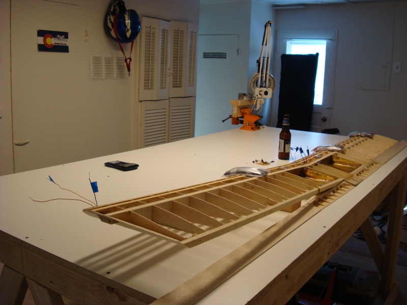

Hi everyone,
We were looking for an airframe to carry some pretty good weight, so we went with the Telemaster. The size of this plane will work perfect for what we intend to use it for. We plan to run a full pan & tilt video down link, still camera, and anything else we need. We also plan to use the Eagletree system, with gps, on the aircraft for all the in-flight data.
The only thing I have framed up is the wing. The only balsa left on the wing is the LE and TE and most of the ribs, everything else has been replaced with basswood. To get as much area in side the fuse for all the electronics, I decided to go with wing tanks. If my math is right each tank comes out to about 27oz. I figured its better to have too much then not enough. There is also going to be navigation, anti-collision, and landing lights.
Any comments, concerns, ideas are greatly appreciated
James

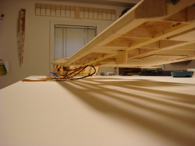

Have you see the Quinn Cadet 84" wing span copies the Senior cadet with a sheeted fuse and a great flyer .

What size Tele are you building?\
Looks good so far..
what is the cutout on the left side of the wing for?

sscherin - Its the 95" wing, and the cutout is the landing lights (I think thats what your talking about.)
James

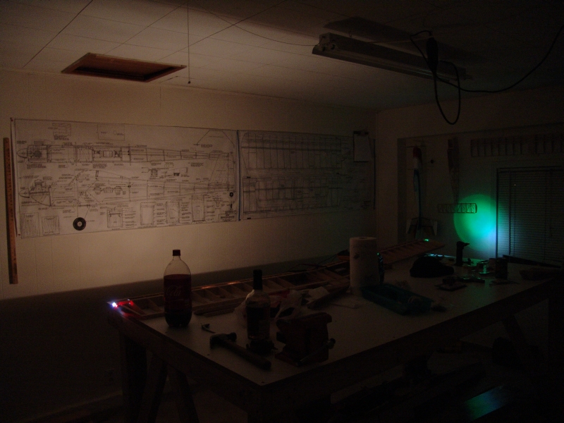

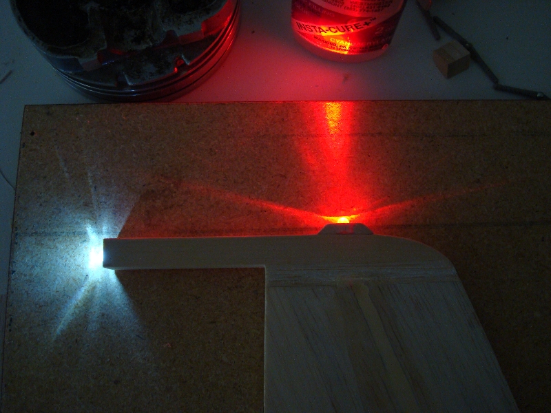

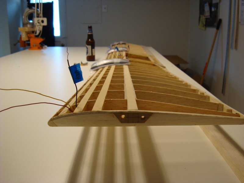

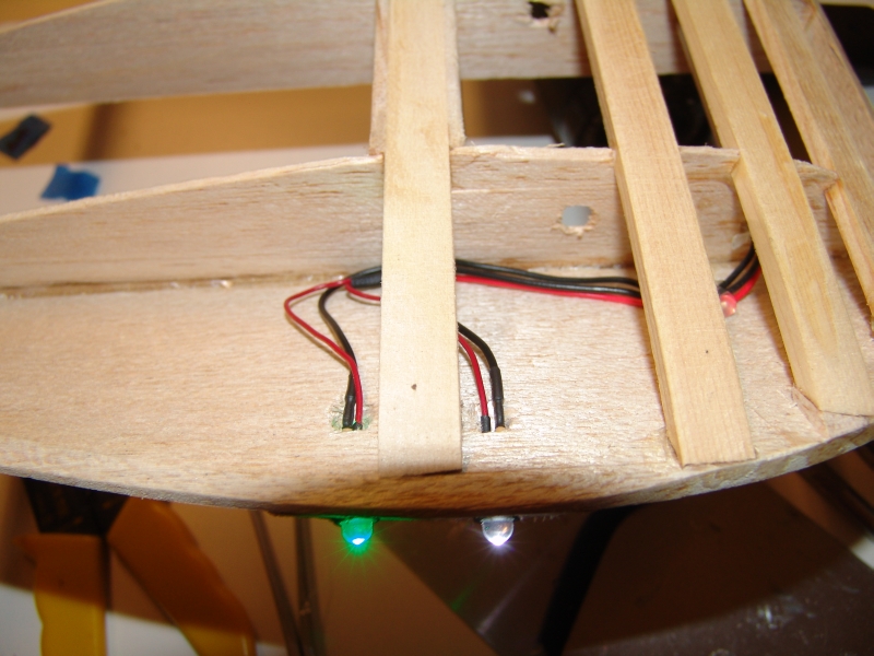

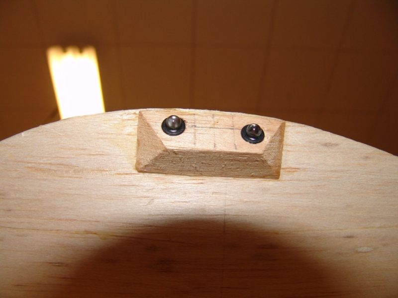

I got the lights done yesterday. All I need to finish them is the connector to plug the wing into the fuse.

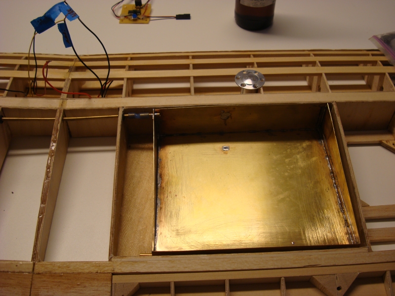

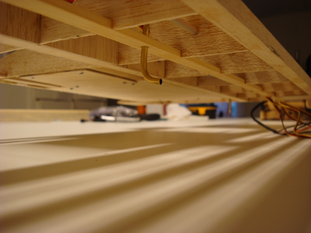

Progress update...

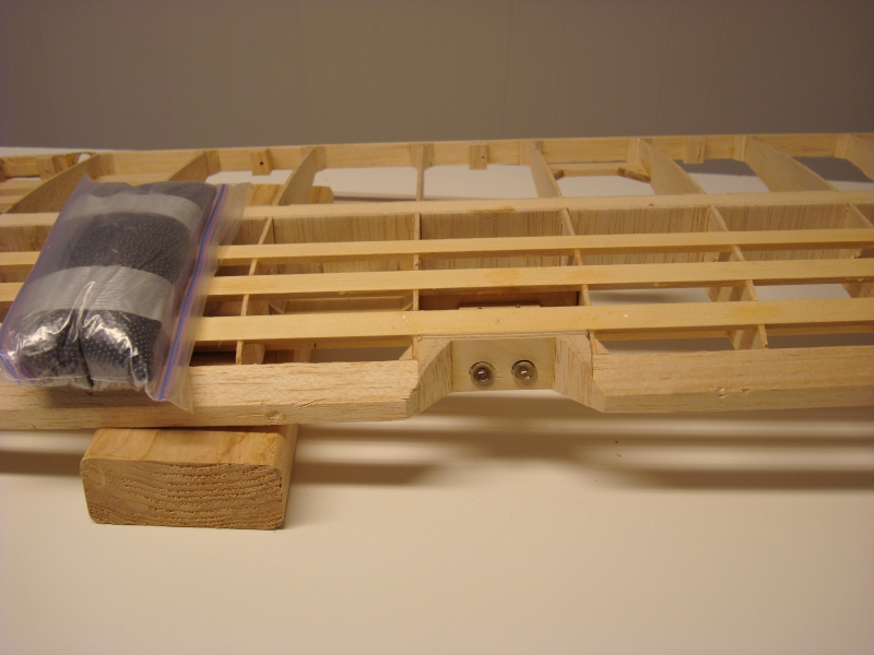

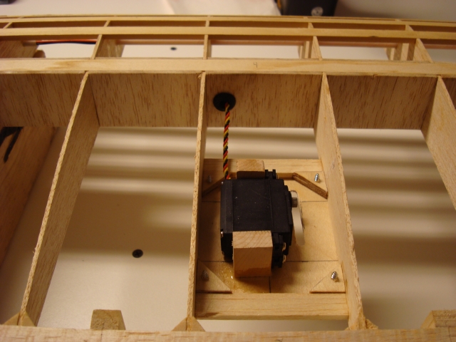

Well it's almost ready to sheet! Few things didn't turn out the way I was planning it, but I think the project is turning out pretty well. First thing that happen that I didn't like, was I had to put a joint on top of the tanks. 12x6 brass sheet from K&S is the largest I could find without making a special order. Both tanks were pressure tested to 5 PSI for about a hour, then cleaned real well with acetone. All the plumbing was a challenge, but extremely fun!

Oh yeah lol.... My math was a little off, the tanks came out to 24oz each...

What did you use for lights. What kind and where might I find them.

I ordered all my lights from [link=http://www.besthongkong.com/index.php?cPath=13&ref=4]Best Hong Kong[/link] I used the 3mm ultra brights, in the highest mcd for the color I wanted. The prices are awesome! I ordered enough to last me a long time.

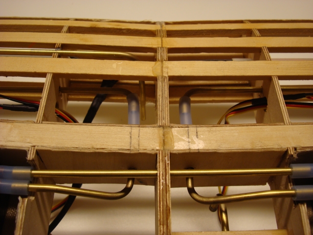

as a master plumber and an avid builder i admire the plumbing in your project. what fun that must have been.
david

It was very fun! At first I went out and bought those spring type tube benders. I don't know if I was doing it wrong, or was to inpatient, but I just couldn't get it to work the tube always kinked. So, I went out and got the Durbro 5/32 tube bender, and was still getting kinks. Than I tried heating the metal up, and after that I had no problems.

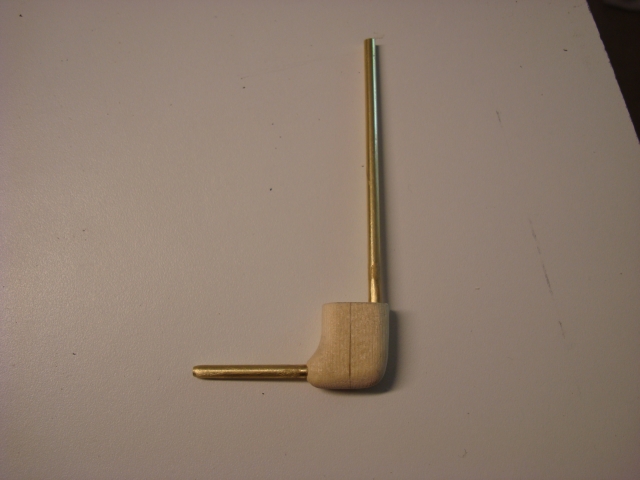

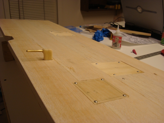

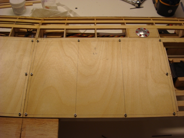

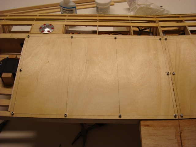

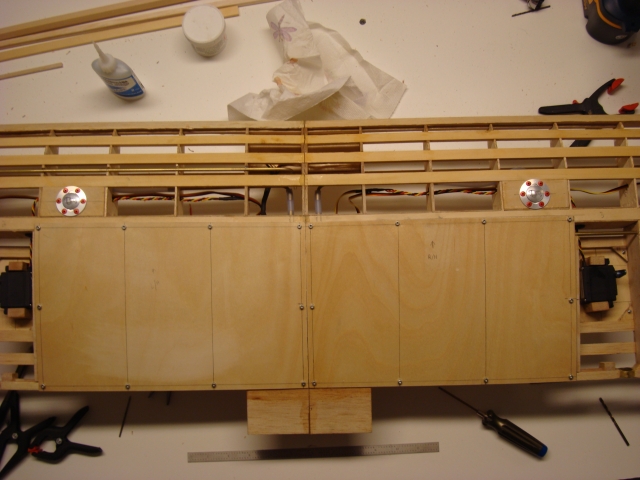

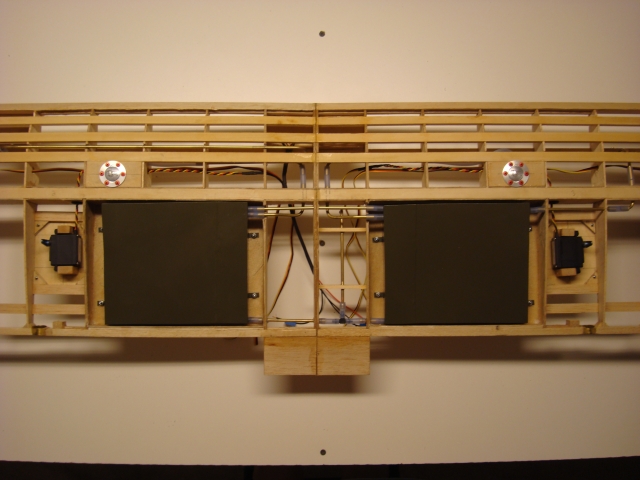

Tank hatches are done... Waiting for a few parts to show up this week, than I'm going to do the sheeting. The screws in the pictures are not the ones im going to use. I'm planning on using those pan head screws from Dubro.

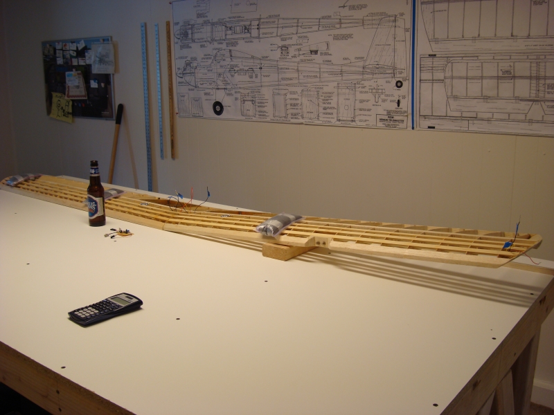

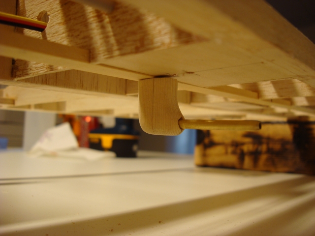

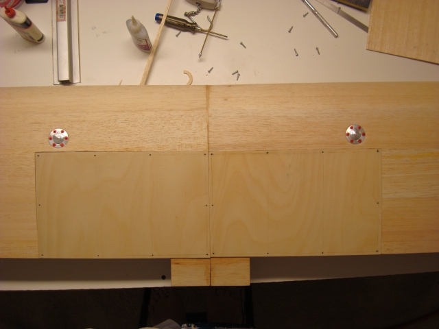

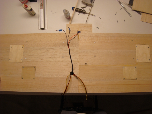

Well, she is skinned. Besides the wing tips, control surfaces, and a few more items the wing is almost done. Time to start on the fuse!!

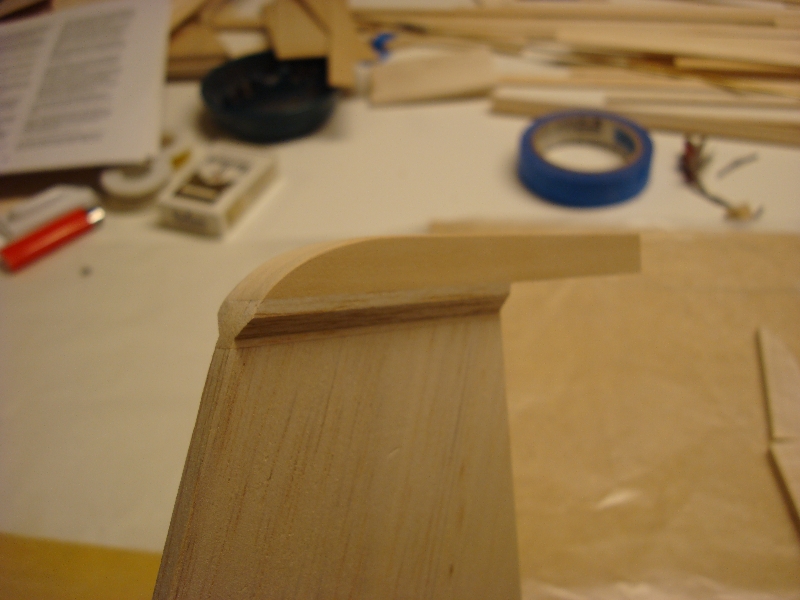

I know it man... can't believe it's been that long already. Well anyway, since I'm waiting on some wood to start the fuse, I moved on to the vert stab. Lets just say doing to wiring on this was not easy!!! lol

I still have some more shaping to get done, but its almost done. Heres a few more pics.

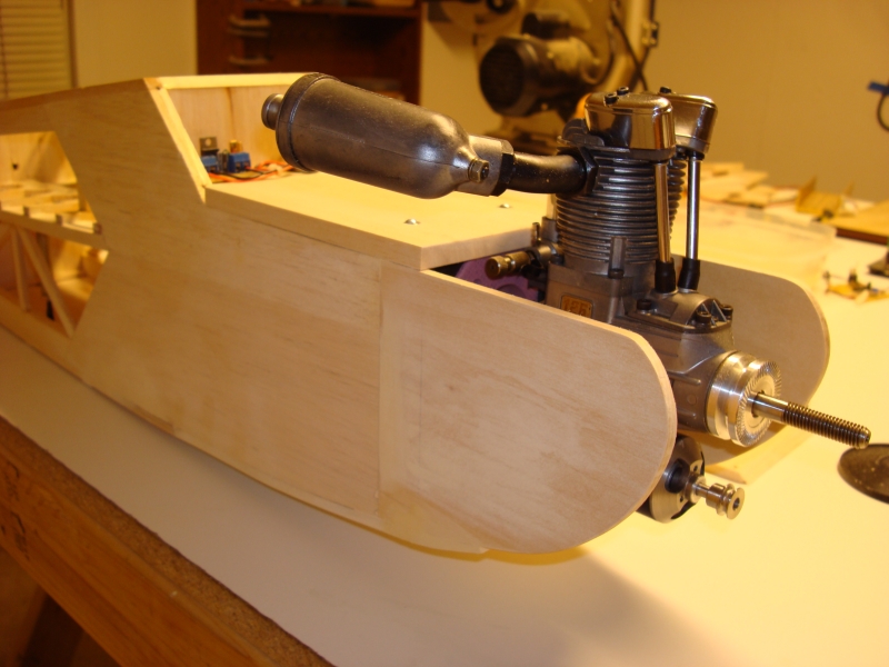

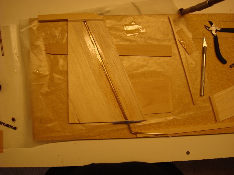

Well its been awhile, but there has been some progress on the build! The fuselage is pretty much framed up, and filling up fast. I'm also in the middle of building our flagship pages on our site. currently the fuselage and empennage sections are done. [link=http://colorado-rc.com]Colorado-rc[/link]
