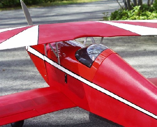

Thanks. Will be able to test fly tomorrow and have high expectations for it. My digital fish scale is acting up, but as far as I can measure it weighs 11 lbs 2 oz ready to fly. That's about 1/2 lbs more than I had hoped for, but still well within what a Saito 150 can handle.
Thanks Gary. Just got back from the flying field and happy to report that test flights went well. Did three flights and by the third was experimenting with outside maneuvers, snaps and spins. The plane flys very well and has a decent glide ratio for a bipe (my Cermark Pitts would just fall out of the sky when the engine quit).

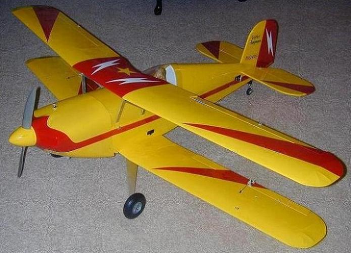

I'm attaching what I hope is a picture that will present the plane better the previous one.

Great Job LuvBipes,
I have been watching your progress as you built it. I sure like the way the colors and cowl turned out.
I have finished my bucker but have not had a chance to flight it yet. My weight also turned out just over 11 pounds with my satio 150 and was glad the hear it flew so great.

mskaerjr, thanks for the kind words. I widh you good luck with yours. Put another 4 flights on it recently, fine-tuning the throws, balance, mixes, etc. It's a very honest airframe and I'm very pleased w/ the results.
