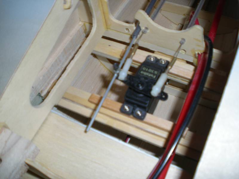

here is the inside of my latest P-47 the pull/pull with the rudder pushrod using a EZ connector,my forward servos throttle and retract servos with EZ connectors and the one not hooked up will have a Quick connect for the elevator,as well as for the ailerons and flaps.
