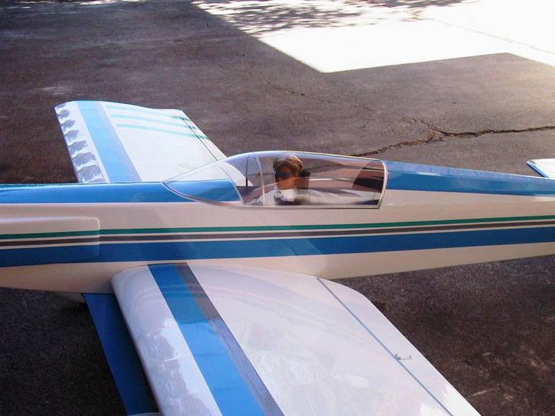

I'm just finishing up my Sig Somethin Extra kit and I'm just wondering what the best way to mount the canopy on it is. It has a thin section of wood in the back so I don't know if I can find really small screws in the back for it or just screw it in on the front end of it. I just want to not have to glue it on there, are there any other suggestions?

I secured mine using covering material, but if I did it again, I'd use a few very small allen head screws on the bottom edge and a strip of covering on the back edge

I use canopy glue and 1/4" pinstriping from an auto paint supply store. It holds really well and comes in many colors and sizes, goes around curves very well. Good luck on that SSE-low rates are highly recommended for the first flight! Here's a shot of my Venture 60 with silver pinstripe treatment.

I used only covering and it lifted around the bottom edge after a few flights. I did add a small screw at the front of the canopy which keeps it in place. If I did it again, I'd still use the covering but also add 3-5 small screws to tack it down. If I had canopy glue though I'd use yel914's method described above and no screws.
Do a subject only search for "canopy" and "glue"... don't forget to tick the advanced search box. The stuff is sold under another product name that, if I recall correctly, is available at most craft stores.

Try PACER FORMULA 560. I got mine at the LHS.

For the last 4-5 planes, I've also used the Pacer 560 glue (dries clear), but I also use the Fourmost Canopy trim around the base of the canopy.
It really sets off the canopy and just makes it look professional.

I'm still using rcZ56 I bought about 10 years ago from Tower. Haven't lost A canopy yet. I also buy colored electrical tape, 1/2 inch and use that sometimes without any glue.
