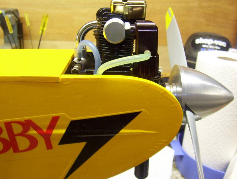

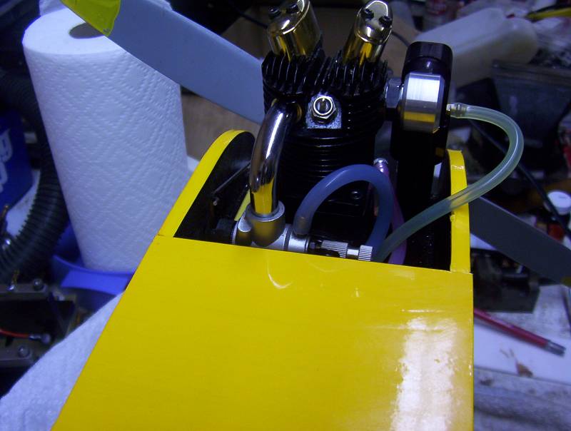

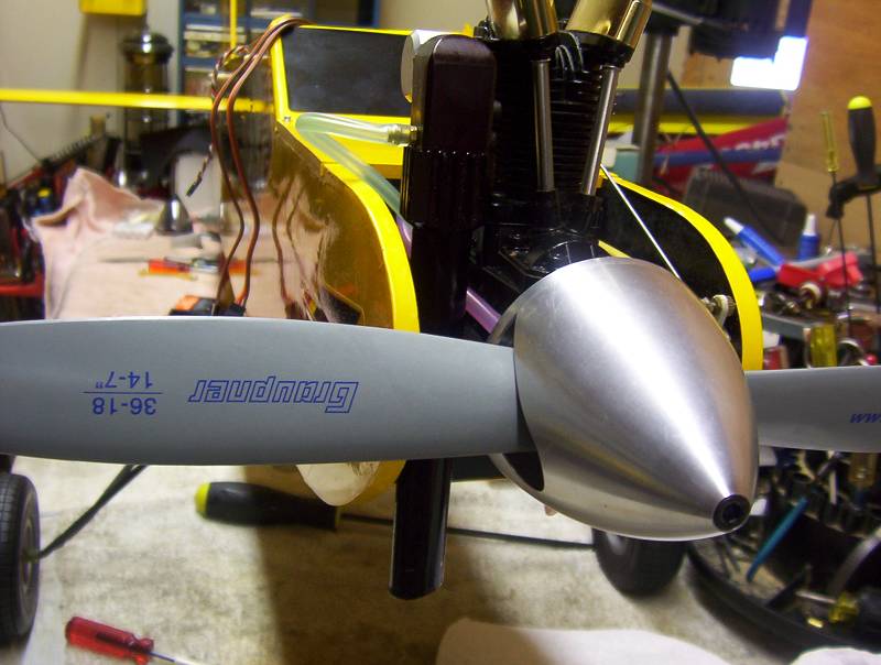

Frenchie, my choice is a Saito 1.00, it is a perfect fit, I have a TurboHeader on it plus a TurboHeader 90 degree adapter. I ran a piece of K&S tubing down through the beam mount to exhaust below the plane. The Saito 1.00 is a "just set it in there" installation, the balance is right on.
