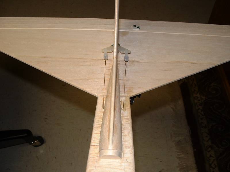

As mentioned above the 32 is a good replacement-if your bold try the TT pro46 or OS 46AX with a 9x8 or 9x8.5 prop-WOW

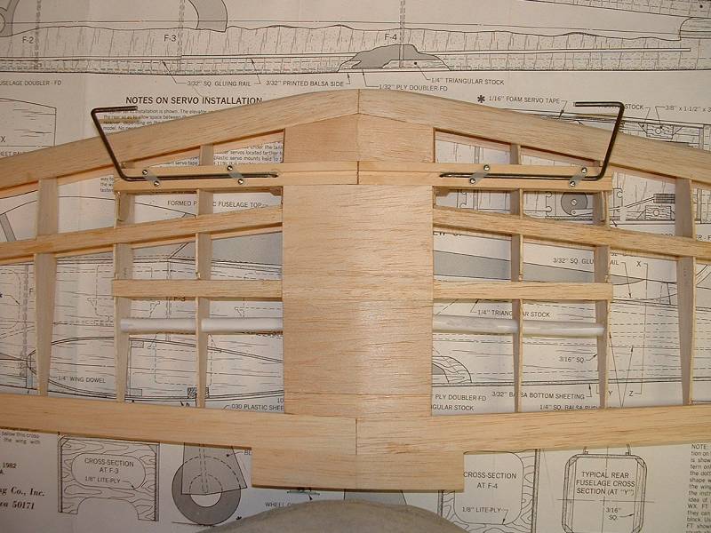

Man I'm sorry I don't remember off the top of my head. Grey beard gave me the inspiration for a tail Dragger which you should consider due to weight. It is really a fast little plane that handles real well.
I have had no problems with the wing-it is a pretty tough plane.

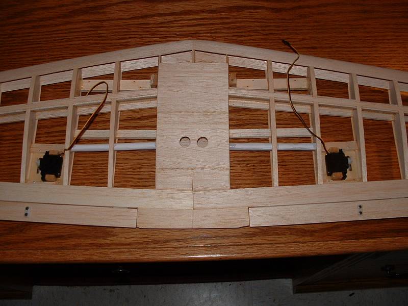

WOW!! Great shot of the wing. I was thining of fully sheeting the wing for extra strength. Do you have any shots of how you did the servos? I'd love to duplicate that....

OK, I will chime in. I took all these photos out of my puter so I couldn't remember A lot about all the little things I did to it so really wasn't A lot of help.
It is A taile dragger but not exactly. It has A skid on the back, I didn't bother with the wheel or anything. All this one has to do is take off and get back on the ground. The pit man runs out and gets it for the pilot and holds it down on the runway nice and straight.
The one big thing is to install the elevator and rudder servo all the way back and I had to hatch the bottom of the fuse so I could get at them and the battery.
I did have to mount the engine and build the cowl around it, drill holes so I could get at the mounting screws. That engine and muffler are A very tight fit.
It's an easy build so just look at it as you go along and think about the stress points. The wing is very strong and the wing mount adds strength to the wing saddle area so no real problem there at all.

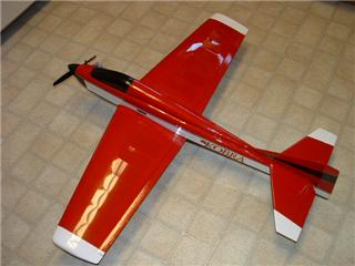

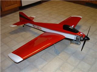

a few pictures of his Kobra. He used racing wheels also. He painted
the gear wire and wheel gray and called them poor man's retracts
as they seem to disappear when flying. Here's a couple more photos
of GarySS Kobra. (correction made)
iflyg450
This is a quote from GarySS email.
"With the TT .36 and a Master Airscrew 10x6 prop the vertical capability
was out of controllable sight".

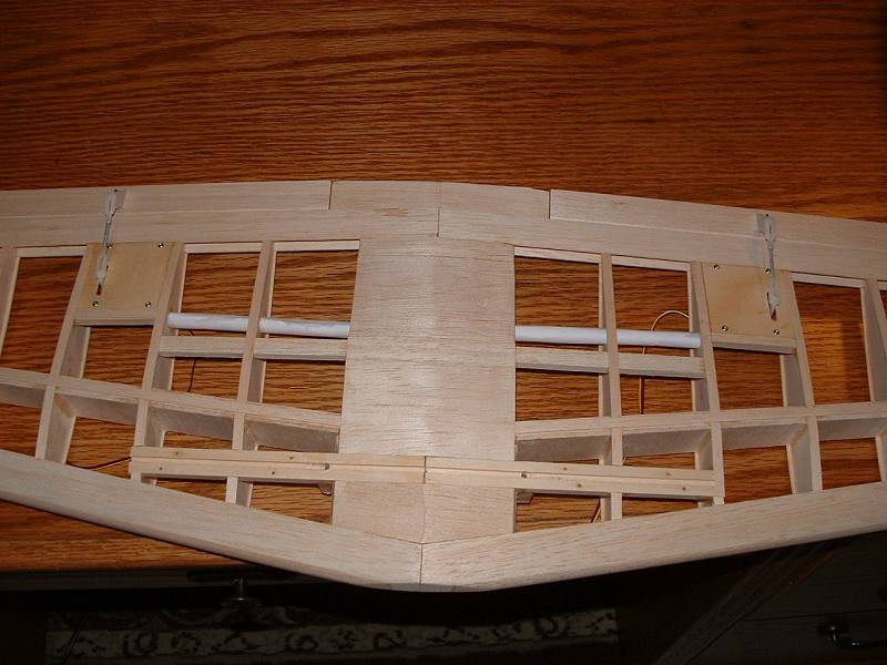

I hope these help-if you need anything specific let me know.
