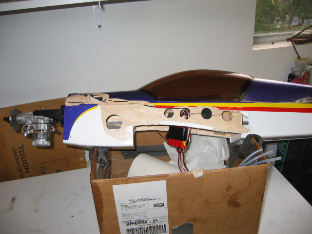

Well, the inevitable came to pass! Biff-o-matic landing resulted in the low-level cartwheel manuever with predictable results.
Photos of the carnage attached. My repair skills are non existent. How should I proceed with making repairs that will be durable? The fuse sides are lite ply laminated to a balsa fuse doubler on the inside. The areas where I have to edge join the fuse side, I thought I would hold together with tape/elastics, then wick in some thin CA. Then I thought I'd laminate some balsa on the inside of the joints with 30 minute epoxy. I'm not so sure of how to fix the spot where the wing bolt plate tore away from the fuse sides. The glue joint held, but it looks as though the lite ply de-laminated where the wing bolt plate was glues to it. I was thinking of CA'ing this all back together and then reinforcing it with some FG.
Anyone have any tips for me?
Thanks!
Thanks!

Looks like a fairly straight forward repair job on fuse side. Pull everything back into place as best you can and wick some thin CA along the cracks. Unless some wood is missing the joints should match up almost perfectly.
The turtle deck will be a little harder but follows the same idea - hold everything back in place as best you can. Elastics work well but use whatever works. Don't worry about the missing pieces just yet. Again, use thin CA to glue verything in place, but don't go overboard because it's hard to sand off.
Now it's time to fill in the gaps and clean up the turtle deck. For missing holes put a piece of 1/16" balsa behind the hole. When dry fill in the hole balsa filler. Once that's dry sand it down nice and smooth to the shape of the turtle deck.
Oh, and if it's really bad don't be afraid to cut the sheeting off and do it over. You did it once so doing it again should only take half as long.
Most important step: Inspect EVERYTHING for hidden damage. Behind the wing saddle on the fuse is a prime location for a break in a crash like this.
Generally I prefer to use aliphatic resins (wood glues) instead of CA, but CA is ideal for this type of repair work.

Sheldon is correct, follow the proceedures he mentioned. The only thing I might add is after you back-up any holes, you may want to add a piece of balsa to fill the area (if it is a large area) and THEN fill it with filler (just so you don't have a big chunk of filler which could crack over time)
Good luck, and keep us posted.

My trainer had bolt on wings. (RCM 40). Believe me, when she finally endured her fatal crash at my hands it was not the wing that suffered - that was relatively unharmed. The Nylon bolts sheared clean. Then again, it was not a cartwheel crash. More of a Split-C (1/2 if a Split Esse).
I've seen Ultra Sports at our club and they fly darned nice, but I could tell right away it would bite me as a second plane. I went for a Big Stik. (Actually I built a Contender 60 in between but have yet to fly that).
Here's a repair tip that works splendidly for me. To reinforce the inside of damaged areas use trimmed pieces of coffee filters with epoxy squeeged over the spot. Dollop on some epoxy on the area. Lay on the filter patch. Squeegie out the epoxy with a piece of plastic milk jug as a spatula. As it oozes out spread it back over the filter patch. This method removes most of the epoxy so it won't add unneeded weight. It ends up thin and strong.

Thanks for the tip. I was planning to do the same sort of reinforcement with balsa, but I didn't know which way the grain should go. I do have some fibreglass laying around from when I joined my wing, I think I will use that instead. I use a metal mesh coffee filter. Much more robust flavour and I haven't run out of filters in the past 6 years!

Interestingly enough....there was a glue joint that let go. I installed the turtle deck sheeting with wood glue...that's the only spot that popped.
I think I can have the wood repairs done tonight, and the covering repaired before the weekend. Another one of the guys in the club was talking about building a SPAD of some sort, and another fellow, who works for me actually crashed the bejesus out of his Kadet at the end of last year, maybey I'll talk them both into building SPADS with me.
