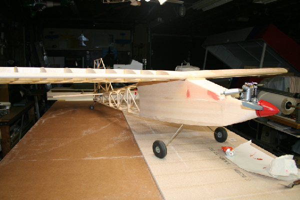

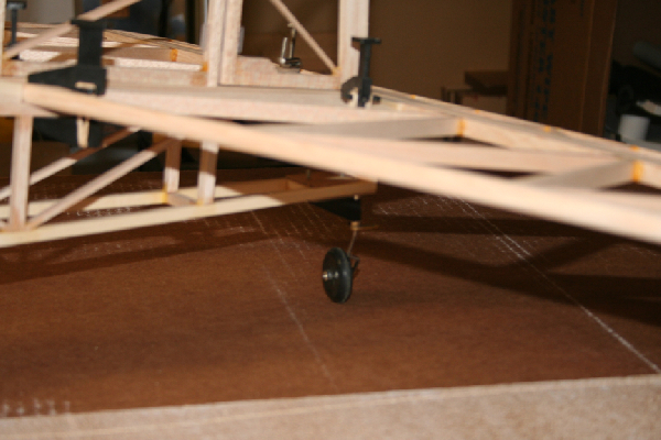

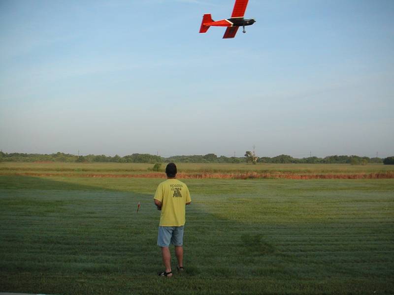

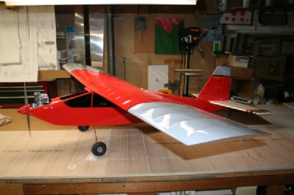

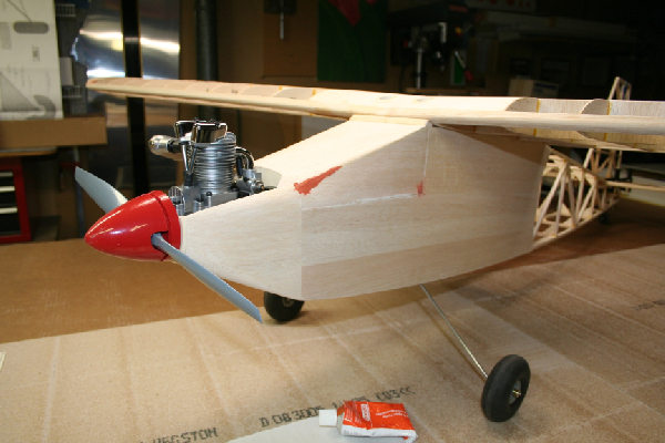

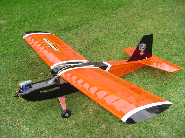

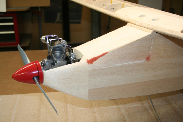

Either plane is a great choice, it really just depends on what kind of flying you want to do. The Cub will require more attention to flying than the Kadet will and the Cubs depending upon the kit you choose will be a more difficult build. I have been flying for over 40 years but I built a Kadet just for the sheer fun of the way it flys. The Kadet is easy to modify and just loves to fly no matter what you do to it. I added barn door ailerons with dual servos, tail wheel, bolt on wings, removed the windows, changed the nose and put on a Saito .82. That is one big wing so do not be shy about aileron size, you can always add expo if you use a computer radio (maybe I am spoiled)!
Here is a few pics. My plane was covered with whatever Monocoat I had left over from projects, which explains the different colors.

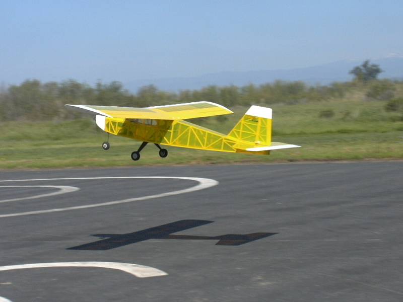

If you have an opportunity, take a couple of pictures of a Kadet Senior ARF's aileron setup. I would draw up some basic aileron plans and tape them over your original plans. It will take a little time to make the mods, but this plane flies great with ailerons (and differential throw). I have several planes ranging from 1oz electrics to a 80" twin, but none of them are more fun to fly than my Kadet Seniorita! Note, I have flown a couple of Seniors as well and they are just as much fun as my Seniorita! Good Luck!

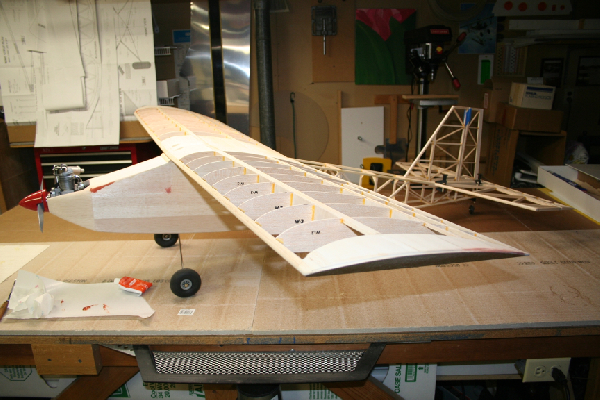

No drawings, but you don't really need them. Cut new dihedral braces to reduce the dihedral by quite a bit. I made my ailerons about 16" X 5 1/2" each and glued a balsa stick (maybe 3/8" square?) behind the outer portion of each upper rear spar to make something to hinge them to (at the top of the ailerons). That puts the trailing edge of the upper spar maybe 3/8 or 1/2" (I forget which) aft of the TE of the bottom spar, which creates room for the ailerons to drop. I used the back part of the outer 5 or 6 ribs as aileron ribs (and had to cut a couple extra for the end pieces). Just make a 1/8" sheet balsa bottom and front panel for each aileron, then cut off 1/8" from each rib and glue them in place on the bottom panel. I mounted a servo in each wing, which is a lot easier than bellcranks and the like. I also sheeted the bottom center section so I could put glass tape all the way around the wing; perhaps not really necessary. I didn't add flaps, but now I kind of wish I had. Not that a plane this slow needs them. (I also made it a bolt-on wing, but that's just mehate those greasy rubber bands.)
You'll need a lot of throw, and a lot of differential probably wouldn't hurt either. Good luck with the project. I'd bet that once you've tried both wings you'll stick with the one with the ailerons.
