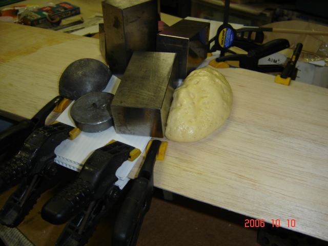

Hey vicman- I've tried the Gorilla Glue & it seems to swell too much & it is a dog to sand off. Maybe I just put too much on! You are right, once it dries, it DON'T come apart !! I guess I am so used to the C/A I don't give the other stuff much of a chance. Hard to teach an old dog new tricks. When building, I will test fit parts & then go back w thin C/A while double checking fit, & then go back with either med. or thick C/A to finish the job. If I feel the area will be more "stressed" I'll use epoxy. My shop is well vented,so fumes are not an issue.

I use gorilla glue for formers, landing gear plates, firewalls, and wing bolt supports. It works good in areas that are internal to the plane. Always clamp when using it, and keep an eye on it for the first hour as it will foam up. Just wipe any excess away with a small piece of paper towel. I think it says that it will dry in 4 hours, but I always give it at least overnight. Very strong glue, and what thing I like about it, is that it will stick to laser cut charred wood much better than epoxy.
For your first kit, I'd stick with the glue you have, and if its not fast enough try some CA. Thin if you have a snug fit, and medium or thick if you have a small gap.

You don't need much gorilla glue to make the joint. You can put a dab on and wipe it off and have just the right amount LOL. I keep an old windex bottle full of water handy and give one side a good squirt before I put the parts togeather too. It seems to "kick" the foamy action off a little quicker. Like Dave said you need to clamp things togeather though. It sands a ton better than epoxy or CA you gotta admit!
Gorilla glue gone wrong[X(]
Poly glue's expansion is a heads-up to avoid problems. I thought I had the torque rods well clamped, WRONG .........one side lifted above flush in the groove. I glue up coroplast with it to make SPADS, like the little rivets it makes in the woodpeckered plastic!
