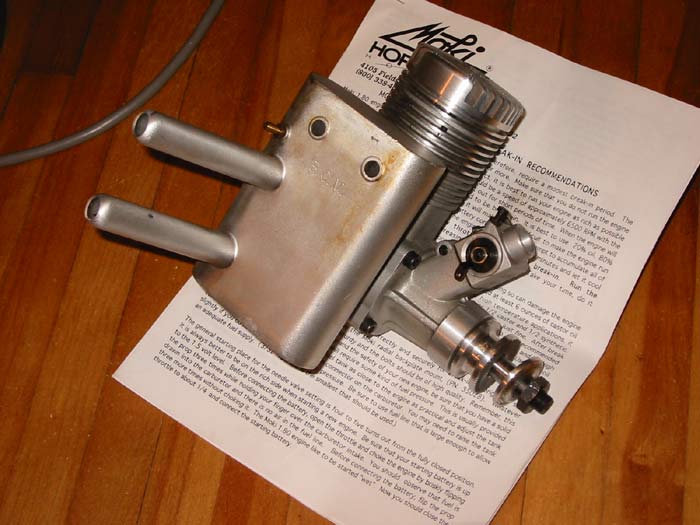

Well, I finished school for the semester, and now it seems like I'm busier! I got my Moki today with a Bisson Custom muffler. I can't wait to fire it up. I don't really think the picture below shows just how substantial this engine is. I'm going to get an 18x8 prop. People seem to feel this gives the most thrust while still maintaining crisp throttle response.
I bought a Heli, a Raptor 30, so my time has been into getting that ready for flight. My hover training is progressing slowly, but surely. That explains the lack of updates. I've also been working about 50 hours a week trying to save up some cash for future projects, and a nest egg to get me through the next school year!
Onto the project at hand...Wreck, can you comment on the relationship between F-18 and F-19. One is glued to the turtle deck, and the other is glued to the hatch, is that correct? I just need to cut the hatch to allow them both to fit in nicely, and they should also be laying against each other in a perfect installation, true?
Thanks!
Reid
